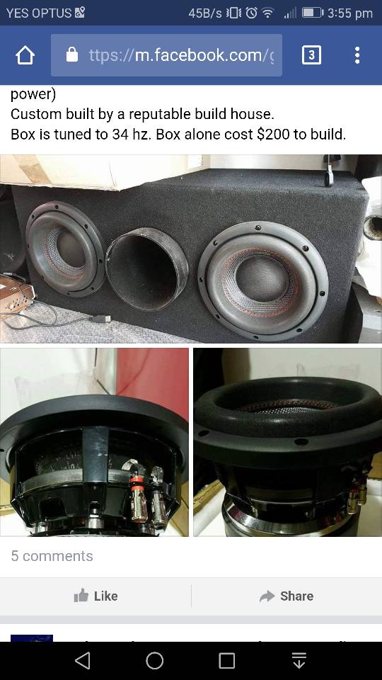

Absolutely wrong... They took the alpine type out it's box (the original box designed for alpine) an put the bone crusher in there an gave it the same beating an didn't blow (the alpine blew) then they took both subs apart to compare the coil. Well the alpine was roasted to a crisp the BC was boiling but the coil had no scorch marks on it an I was kinda impressed. But know that obviously I haven't had much exposure to different sub types an outputs... Music can't be played to loud here in Australia because fines are handed out for disturbing the peace.

No way in a hell a off brand beat a mainstream brand. There's more to the story than that. Also....what kind of enclosure was the sub in? I'm willing to bet they clipped the phuck out of that Alpine sub...What amp/how many watts were going to both drivers? What vehicle was it in...oh wait you said at a car audio shop....but sometimes shops have company vehicle with equipment inside to show off brands.

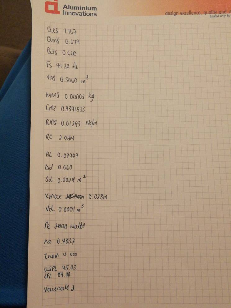

I'v only got access to certain perameters there are a few I cannot find online. The sub isn't well known here not many know Abt it not many use find them all is gona be a huge nearly impossible mission.

Well that's what you get for buying a off brand driver.
They had used the box originally designed for alpine type R. The amp was an MRX-M110. I'm not sure Abt clipping..the volume nor amp output was changed or atleast I didn't noticed any of that happening. But Dnt just take it from me... I had just arrived at the shop when the demo started an I had 100% faith that alpine will last right through.. Lol... Nope it didn't.

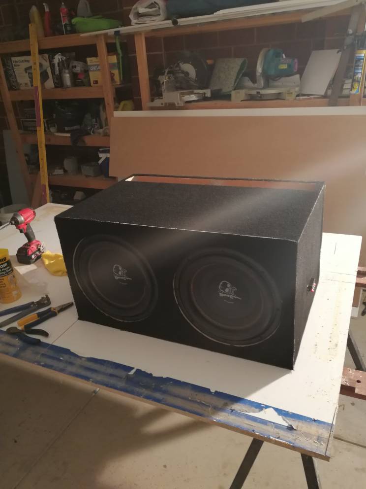

Not perfect. Had a friend test the box output an got 36hz...not that I understand what that really means.
Sent from my MHA-L09 using Tapatalk
uhm.. that better be sub up, port back... or else thats gonna be horrible loading.
Well he hooked it up to 2 pdx. An they sound really really good jeff.. I mean it wasn't a perfect box.. But It does the job... I think ima keep at it and re make it using different techniques. Just for fun. See how far I can go.

talking about your 36hz or whatever box. You can use it but have sub fire up, port fire back. Just letting you know the optimal way to position it. Not ragging on the box.
May I try to help?.. those parameters you posted just would NOT work for me... maybe it's me, maybe not... anyways this design in Torres should be close to what you need... not perfect and I'm hanging out there on this one due to not being able to model them first... Please slow down and study how these assembly drawings show the sub/port configuration and assembly... Build it just like the pictures as this sub/port configuration is how it is done in Torres... the only 45 degree beveled piece you'll probably need is at the bend in the port.. the round dowels shown should be added... don't worry about displacement... It'll be minimal... ask away if something does not make sense... please!

This will most likely sound a lot better than the box above you built... I'd start over if I was you... You can try this one if you want... Once installed in the vehicle, leave around 4" clearance for the port to breathe and face the subs/port to the rear... Just my humble opinion...

Will deff give it a go in my next build which I begin next weekend.
