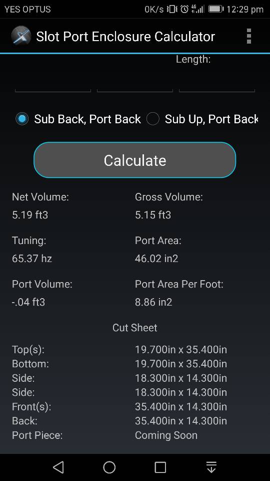

This is what I'v come up with

Go on and download Winisd alpha... watch this tutorial...
... I've got 25 years plus of experience and it all clicked pretty easily as I do know the car audio environment... I'm asking you to post parameters for a reason... I don't feel it is something you can just jump in and learn easily... maybe you can... there are lots of tutorials online... I'm trying to avoid the... "told you so"... that's coming...
