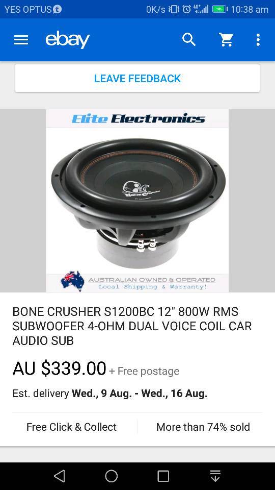

Single capable amp needed to push 2 12" bone crushers.
I am confused Sent from my MHA-L09 using Tapatalk
thats why i told you to bust out that multi-meter and set it to ohms and check the voice coil reading of the subs for an actual ohm load to be sure before you start buying stuff that might not work with your setup. Also any pictures of the box its in and how it looks in your car? There's many things you can do to get a lot louder that doesnt require gear change. Some are free to do and some are cheap to do and some make a giant difference aka box design(that makes a much bigger difference than swapping amps)

Looks OK... just get a box built for those subs... you've got a lot of power coming if you ordered the RF amp...
Sh*T... is that dual 2?.. if it is you're in good shape now...
It's all about the box man

Ok, they dont have the vc rating for anything but the one set which look to be all the same speaker. My mistake
I'll start breathing any minute now... good catch anyways... that needed to be cleared up before he bought an expensive amp... //content.invisioncic.com/y282845/emoticons/thumbsupwink.gif.129404938effda6ad9cca39e7f4b58a3.gif

might want to have someone that knows how to get loud design it for you bud. You cant just think oh 4 cubic feet tuned at 32hz with whatever random port area will be the best. There is WAAAAAY more than that. We need TS parameters of the subwoofer, what car you are driving, what's your car's peak frequency etc.. all that is taken into account along with the power you run. That determines the proper airspace, port size and tuning.
True
I'm driving a 2 door hatchback.... Relocated bigger battery to the boot... I Dnt know inches but here's my practical boot space 900cm length 600cm width 400 height.
