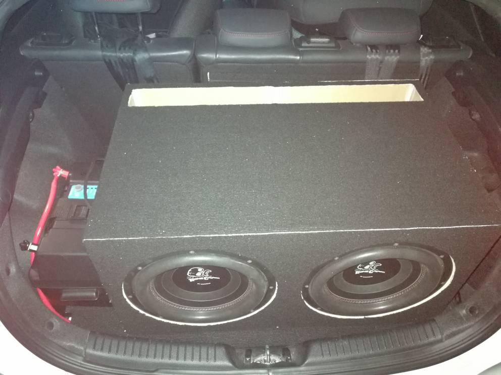

I just noticed that I screwed-up your available space I believe... is it a hatch or trunk... are these your MAX dimensions?.. 35" w x 23.5" d x 15.5" h?..
Here is another try... same as above...
Yes those are my dimensions.. I'm beginning to get used to your imperial system. Even going as far as measuring using the imperial side of the measuring tape. Hatchback.

This sub box with the dowels.. Is that for one or two subs? Because my boot space does not allow me to have the port on the side unless I relocated my battery back under the bonnet which I cannot do because it's too big. 100ah 750cca.

Hey shredder.. Yeah what your explaining is new to me or I Dnt recognise the terms....subs up port back... But I looked it up to see what you meant... An that design I have never seen physically an I think it's because the vehicles here an the vehicles in America are a major difference in both size an space. The way my box is designed I could turn it so that the subs face up an the port faces back... But towards the front or the back?

talking about your 36hz or whatever box. You can use it but have sub fire up, port fire back. Just letting you know the optimal way to position it. Not ragging on the box.

Yeah.. But the port on the side is the issue.. That box is tight though.

The pic with the dowels is only to illustrate how the dowels should be used.... the second pic is ACTUALassembly... both are for 2 subs... the dimensions I've given in Torres should work... maybe you should put a pic up of the "boot" in question with your battery as well... I'd appreciate it immensely...
At times like this I wish I could type as fast as Gramps... I'm a stroke survivor and my motor skills are less than Ideal so it may take a few for me to respond... Can you post a pic of the "boot" in question?.. please...

4am here... Just incase u can't see properly.

I'd be able to fit much much more of I hadn't had the fit the battery box.. By law it is mandatory when relocating the power source.
