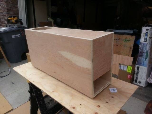

Nice box. Is there a reason you made it out of teh nice ply? I usually make mine out of the high density MDF.

It's sundown lol... Baltic birch is a lot lighter than mdf and I did not build because I don't have the proper tools... It should be coming in the mail in a few more days

Same strength if not stronger than MDF, easier to work with and EXTREMELY light in comparison. No sonic difference. Lets say a 16 cubic feet box for two 18s can be lifted up by one person when built with birch ply. Dont see it happening with mdf and no chance in hell with HDF unless you are in world strong man comps.
