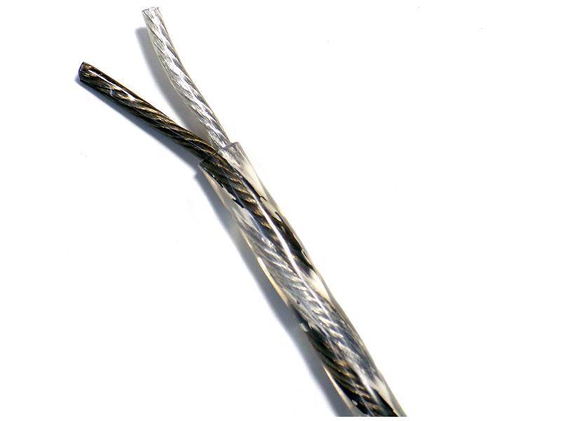

I'm ordering some Karma SS (Twisted) Kable wire for the wiring of my subs within the enclosure to the inside of the terminal cups.
Question: Should I used the same gauge of wire (in this case 12) for the outside of the terminal cup leading to the amp? I was considering
using more of the same speaker wire for that. I don't see many setups with twisted wire for the outside of amps leading from the outside of
cup terminals. Probably a stupid question, but would it make a difference as opposed to using straight wire of the same gauge? Thanks.

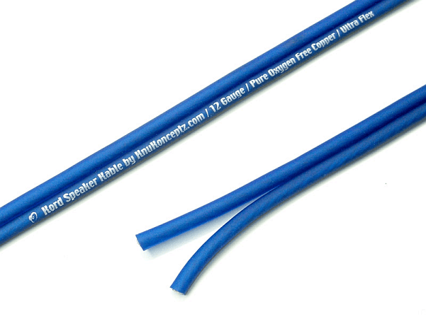

Additional Info: KnuKonceptz Karma Twisted Pair 12 Gauge OFC Speaker Cable
Nope, using a larger gauge my add a small amount of current flow but, would soon be dissipated by the smaller wire on the inside. It is fine using twisted wire on the outside.
OFC wire is all the same other than strand count. There will be no benefit going to the Kord speaker wire from the twisted. If you have enough of the twisted to run to your amp just do it if not, you can buy a size up in wire which may give slightly better results.
