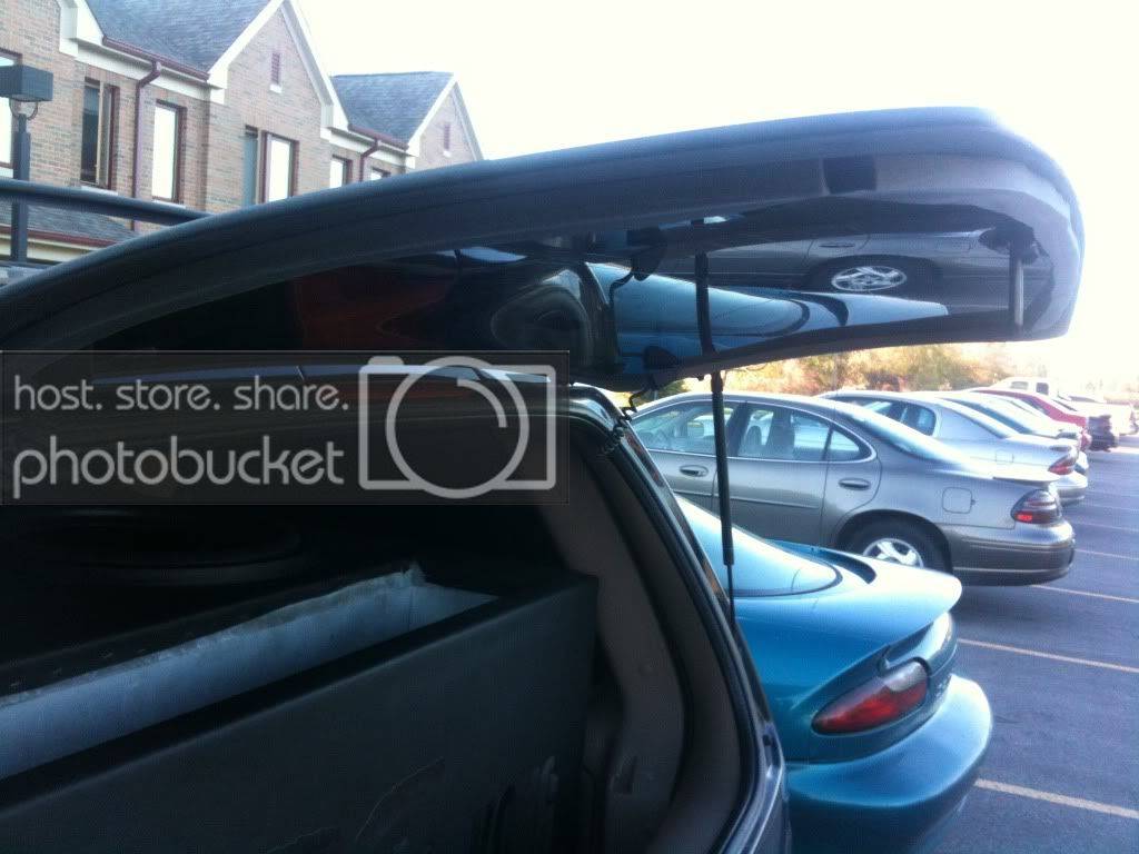

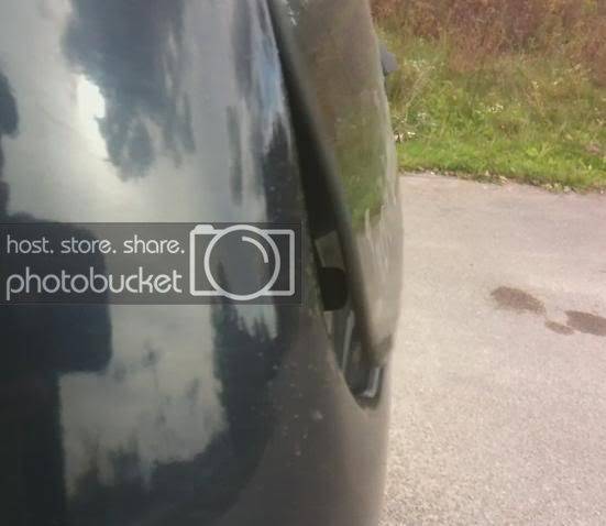

So if you've seen my video of my explorer flexin the back window is moving so much you can put your finger in it. I've heard that you can buy some foam from like home depot that has adhesive on one side to put around the window to help keep some of the pressure in. One of my buddies did it and said it made a big difference, just seeing if it would be worth it, because I don't want to make it so tight that the pressure breaks the window.

This stuff, Thermwell Products Co. Inc. 1-1/4 in. x 7/16 in. x 10 Ft. Black High Density Rubber Foam Weatherstrip Tape - R516H at The Home Depot and yea what you said about bracing your window caused it to break is what made me make this thread, cuz I want to keep as much pressure in but don't want the mounts to break

if you're talking about putting that around the inside of the window, it'd work at the top, but it wouldnt be pliable enough to stretch with the windows flexing, or hard enough to hold it in place at the bottom. if you want to put that between the existing weatherstripping and the window, do it a little at a time, start at the bottom latch and work your way out and up as needed.
i'd also take a look at the latch that holds the window, i'd bet yours is the same as mine, allowing like half an inch of play. it cut down on the rattles ALOT when i had that thing jammed in there.
