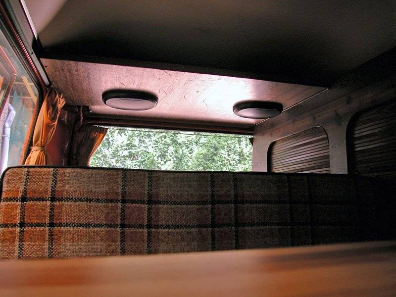

Now I have a couple of questions about all this. The first problem we have at the moment is that the 6x9's in the back produce very little low's. I'm not sure what the problem is here, there are mounted in rather small boxes, which are not airtight. Besides that the speakers are angled vertically and actually pump their volume straight into the bed that is below it. If you lay down below the speakers you actually do hear some bass, although it is not nearly as much as the speakers in the front doors put out.
Can this be fixed by building a proper enclosure for them? Maybe vented? Or is their position just never going to work?
Here is a picture:

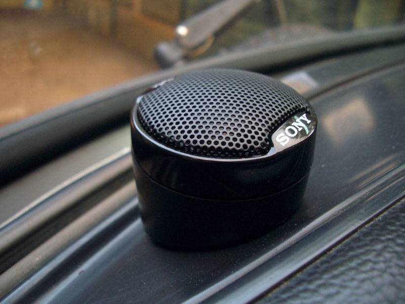

Then I have one last question about the tweeters in the comp set. I have read the best place to position a tweeter is actually as close as possible to the center of the main driver. In the current setup the woofers are low down in the doors and the tweeters are up on the dash.
Couldn't find a much better picture, but you can see the windshield there. Now I have also read the winshield can broaden the soundstage so this position might not be completely stupid.

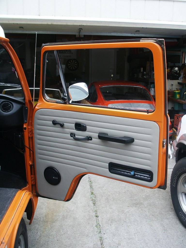

In the new setup would you keep the tweeters on the dash or move them close to the woofer, on the door? Here is a picture of the current woofer location:
(not actually my own car, but we use the exact same location)
When we mount the tweeter there I'm a bit concerned all the high's will be lost in your legs being very close to them.

Sealing the enclosures would almost certainly increase low end output, but you should temper your expectations by keeping in mind that they're just 6x9s.
The best method for determining tweeter placement is to simply get some tape and test different locations and see what sounds best to you. If your using a component set with a passive crossover it is true that the closer the tweeter is to the woofer the better, because that's how the manufacturer designs the crossover.
