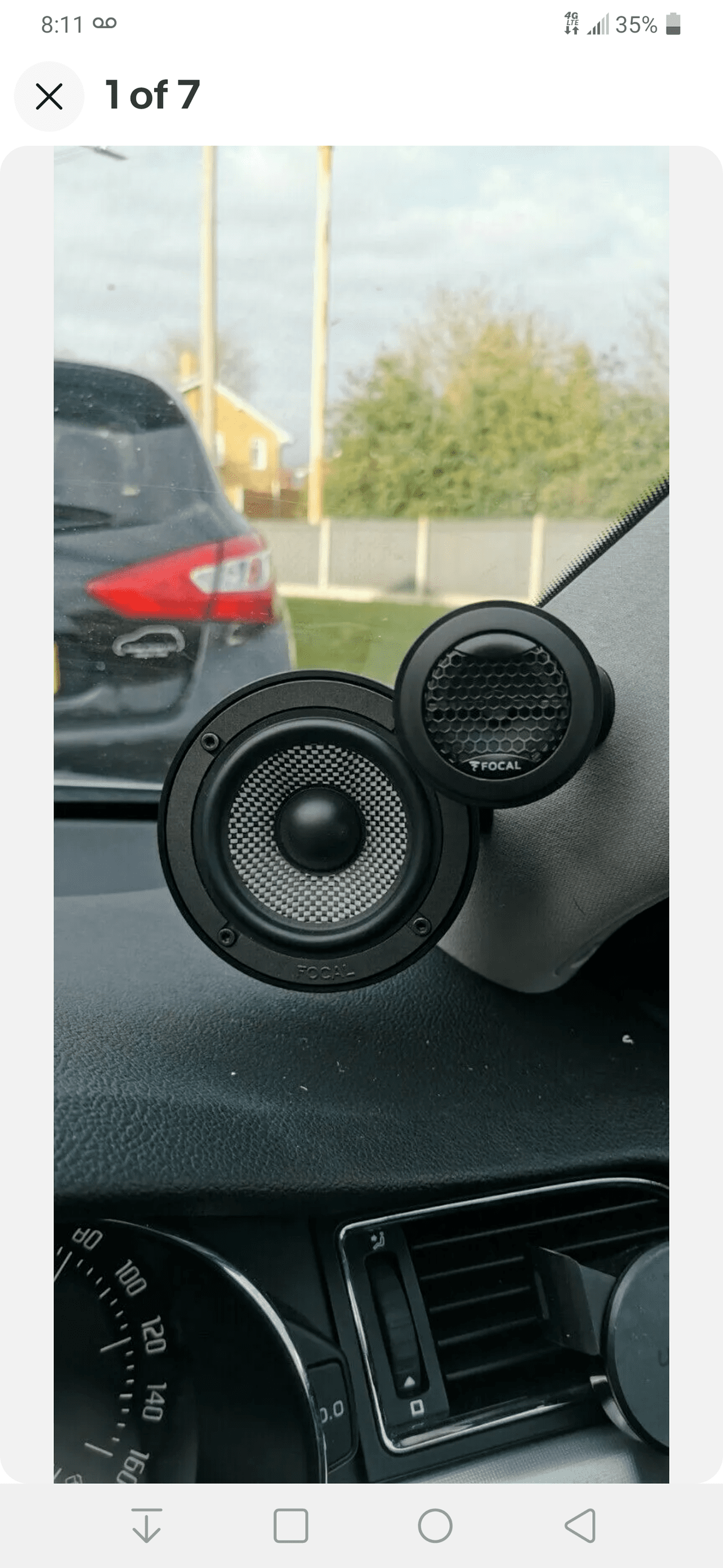

Hi guys im upgrading the moment, swapping C5 252 two way for the C5 653 3 way in the front may issue is where to install the mid and tweeter? kick plate of door pillars?

bloody mine field haha, im just upgrading, I have jl hd 600/4 and hd 750/1 wd7 12" sealed c5 653 with fix 86 and c3 in the back. I'm stuck where to mount the tweeters and mid in the front , should I go kick plate or pillars? im wondering to buy a twk 88 to match the fix 86. but I do have a spare fix 82 and wondering to now use the fix 82 and twk d88 and move the rears to the front and make the front a weapon. I popped speakers in back for passengers, but as u say the stage plays forward. really stuck here as it seems better to go double ups in the front haha. where and how the hell do you mount that lot

thanks buddy so mounting c5 two way in the back no probs. what about setting up the c5 three way in the front?? in a van ?? VW transport t6? do you think go for low kick panel install as shown in jl manual and woofer in the door? or pop the mid and tweet in the pillar?

Only reason I would use the kick location was if the speaker magnets did not clear the door's regulator/glass.
As for the 3way location, I would mount the tweeters and mini-mids on the dash by the A-pillars in aluminum pods. They would look absolutely beautiful. Since you have all that DSP goodness, you can subdue the sound to keep them from pulling rank over the 6.5s.
