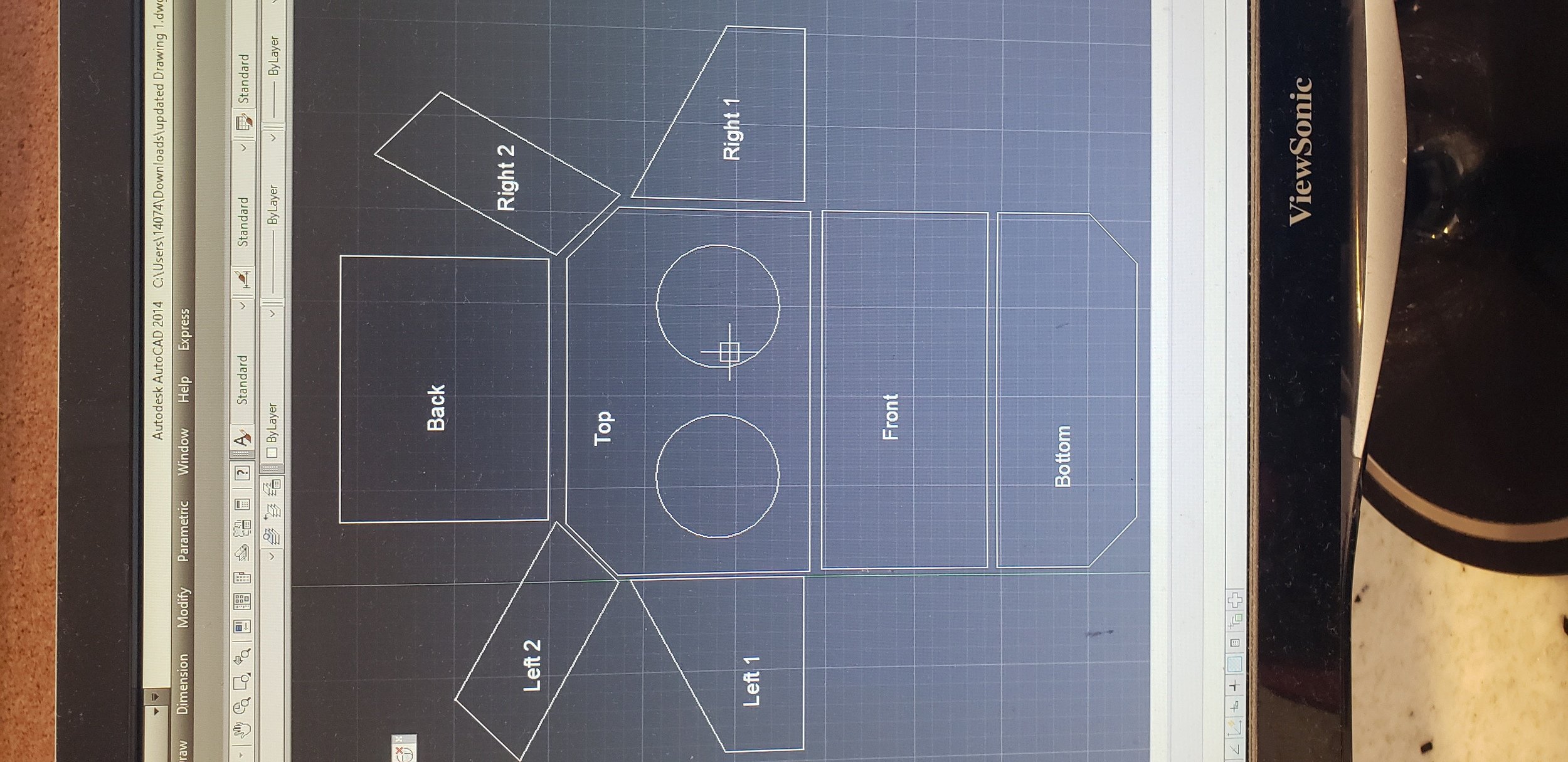

Anyone used this stuff? It's like 20 layer full 1" thickness Baltic birch. I'm FINALLY about to get my box cut and I can't decide if I want to eat the airspace and double baffle the top(48wX30d), or if I just want to brace it with 1" dowel. The entire enclosure will be made of the 1" birch, and the top is the only panel with a size over 18x18.
Subs are 18" TC sounds pro 5100s, about 50 pounds each, power is from a Smart 5 at 2 ohm.
Trying to get the panel layout done and get a final quote so I can finally finish my build. I'll toss up a picture of the panel layout shortly.

Yea, it's not cheap, total cost plus shipping is going to be about 1200ish, still working out details. But rather than 4 sheets of 3/4 it will either be 1 sheet of 1" and 1 sheet of 3/4 or 2 sheets of 1". The bottom, back, and large side panels are all going to be against the body of the car, so 3/4 would be fine, going with 1" because why not. Just need to decide if I REALLY need 2" thick top or if I can just 1" the whole thing on 5k with a few dowel braces.

Ahh, I gotcha. I'm going with birch for some weight savings and I'm going to put some poly on it to make it look nice and waterproof it. I also do want to be able to take the top off so I can access the port Cutout from the front down the line if/when I decide to run it ported.
Let's not talk about OSB, that shit is awful. As far as MDF, I could go 1" MDF as well, but I'll be adding an extra 80ish pounds to the car over the Birch. And a regular plywood isn't bad either, but I'm still paying 120/sheet for decent void-free 9-layer 3/4. And I end up using an extra sheet, so the cost is pretty much the same.

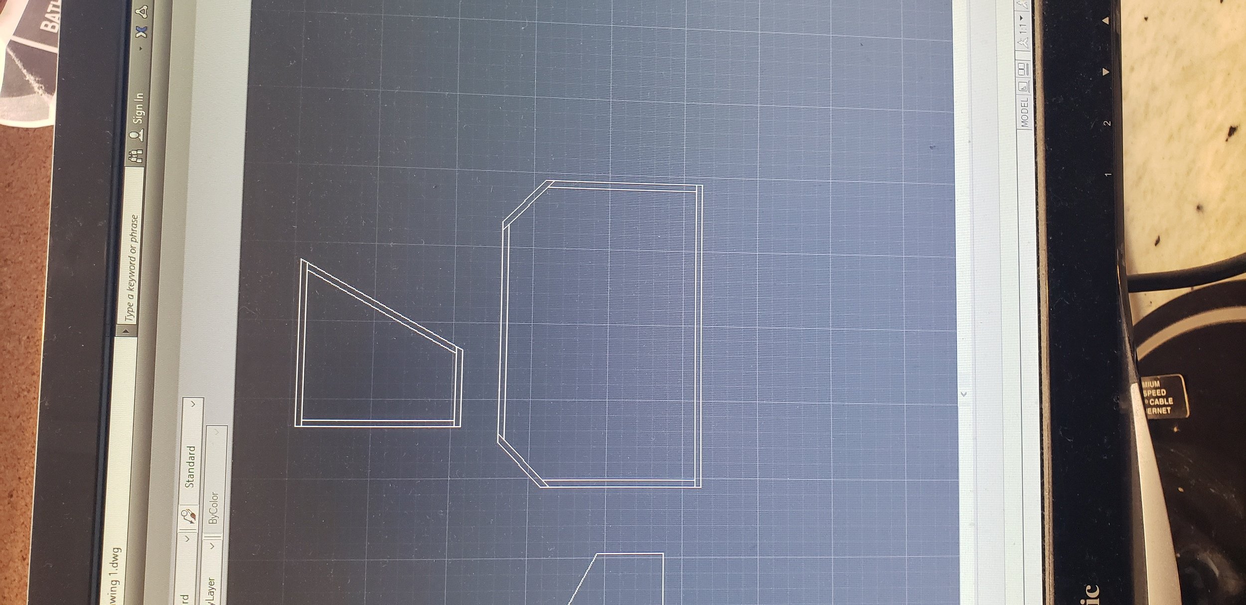

I'm looking at adding a simple cross brace inside the enclosure, but I haven't fully committed to it because of the odd shape. There will be at least 2-1" dowels inside the enclosure on the top, splitting it into 3rds a bit behind the sub cutouts. There may be a front to back dowel as well, but if I decide to follow through with the port, I have no real space for a dowel in the center. Keep in mind that the bottom, back, and sides will all be bolted to the body or basically locked into place once the doors are closed. The bottom is on the rear seat pan, the back is the trunk/rear crossmember/strut tower area, and the sides match up to the doors once closed(expanding foam will fill the gaps in the future, not the cheap "gap fill" stuff either. I have 2-part hard cure foam available from work.
