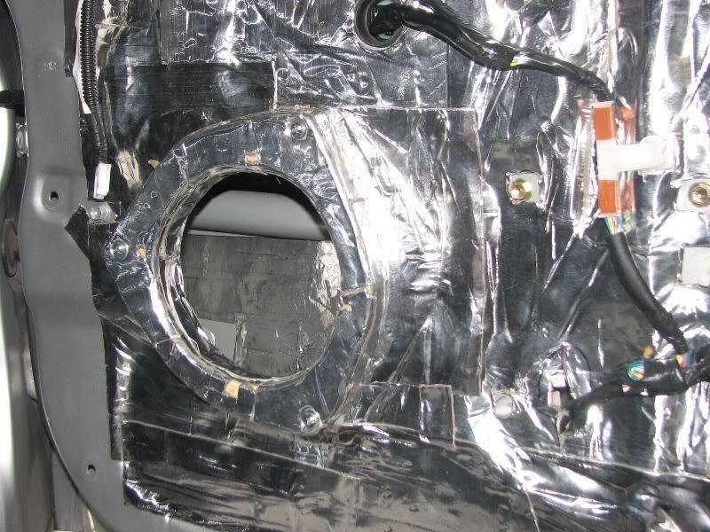

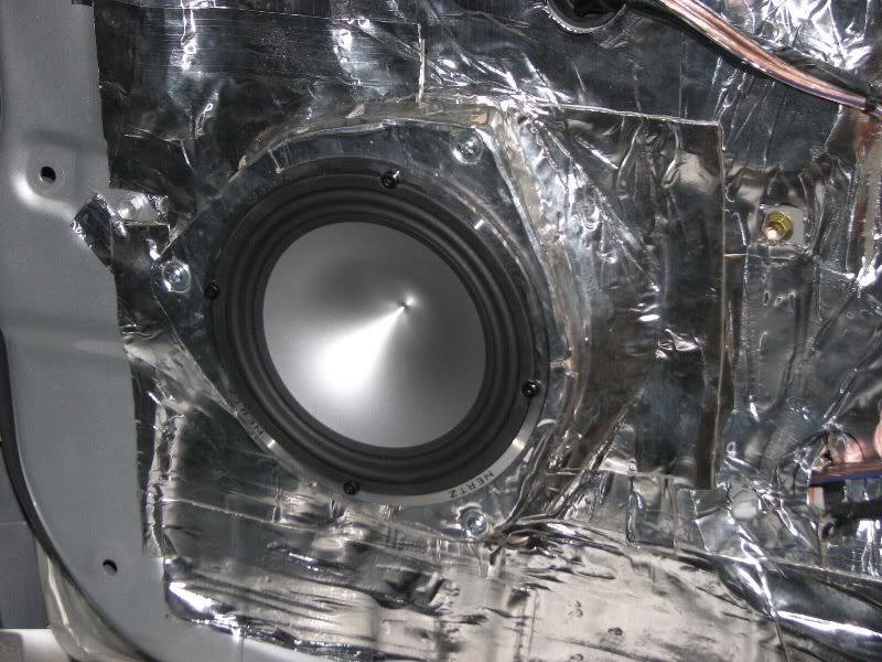

ask for deadening on the speaker baffle. makes a huge different when the baffle + deadener + door is 1" thick

Thanks for the pic. So how far on the "inside" of the door did you go? Also, how would you describe the difference in sound? I wish I could do a comparison of with and without to hear the difference. If I remember right...deading is quite expensive.
i do as much of the inside as possible (i.e. reach). I still need to seal up the factory openings and add more to the inside. The difference is staggering. A properly deadened and sealed door is crucial to getting good preformance out of a door speaker. without it, it sounds like a tin can (because it is!).
the baffle construction is equally important. you don't want the driver wasting energy and exciting the door panel - that will give you modes and resonances.
that baffle is 3/4"MDF with two layers of deadening, then two layers of deadening on the door around the speaker. We used Raammat BXT II (nice stuff).
