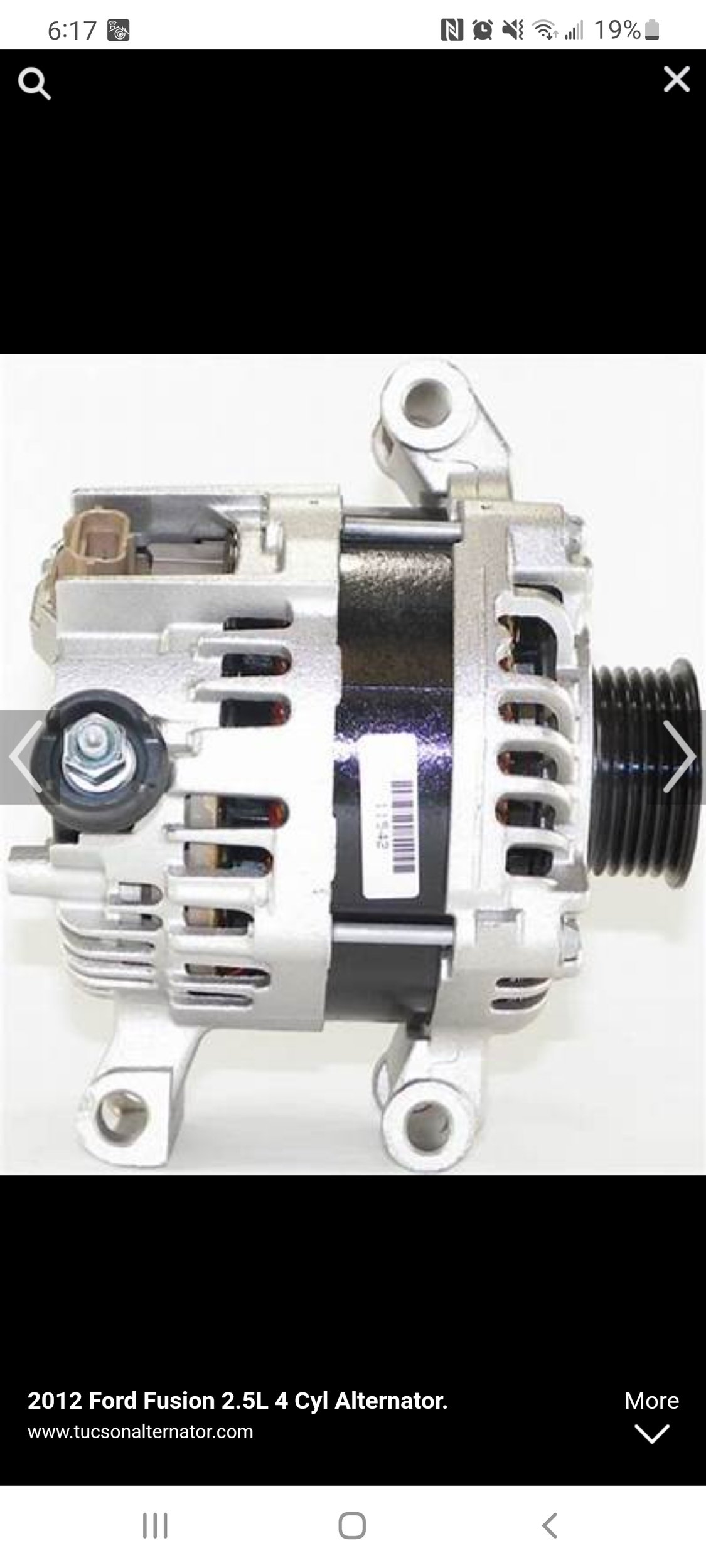

Is this what your alternator looks like? View attachment 35630
If it is, under that plug, do you see that bolt? I believe that is your positive
I’m not able to see what’s under the plug, I’m guessing that’s what’s under there because of that cooling duct I showed. That would make the most sense to be the battery positive. I’m gonna try again tomorrow to see if I can get that cooling duct off to get to that plug and bolt
