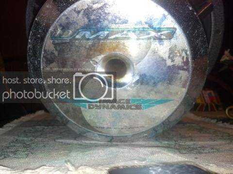

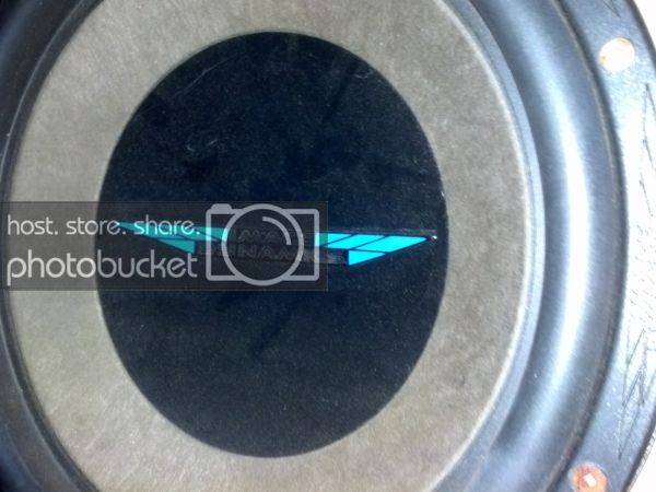

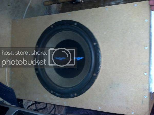

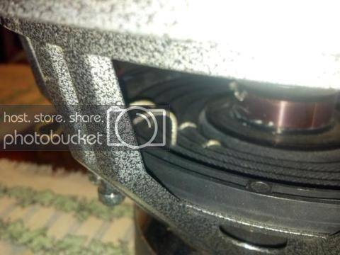

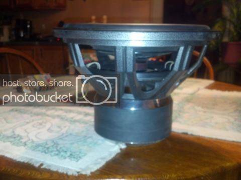

This Image Dynamics Max 12" is listed locally for $125. I want to pick it up but from what I see in the pics I think the coil looks pretty dark so that has me a little worried. The guy is 40 minutes away from me so I wanted to see what everyone here thought about it before I went to check it out. Let me know what you think!

**** is that a quad stack motor? If so it's well worth the cost especially if its a 3" coil or bigger.
Or is it a big *** triple stack either way it's a nice moofer but that coil does seem a little dark and used,.. probably not much life left in it.

I think i read it's a triple stack but not positive. I also say some people say the coil discoloration is normal for this sub but im not sure if thats true or not, can anyone confirm?
All these older IDMax's look like that. I think that's about 3 versions ago but I'm not an ID guy so not too sure. I'd say try and talk him down to 100 bucks or so. Have you heard it? Take a dmm and check the coils to make sure they read out right and go for it. They're nice woofers... If anything play it for awhile and build something custom later on with the motor.

Looks like a v2 based off the motor. Some v3 were still triple slug motors though, iirc.
Coil is usually darker on idmax, I'm roo lazy to pull mine and confirm. I could be confused with my spg555.
**** good price, especially if coils read out good
its a v3. i worked at ID building these i would not get it due to whom i know built that driver. look at the leads on the spider, it will tear at higher excursion. the triple stack was due to an ordering problem on the larger slugs and ID had a oh crap moment and built a run of them using triple slugs. if it doesn't work talk him down ALOT and buy a re-cone kit for it
