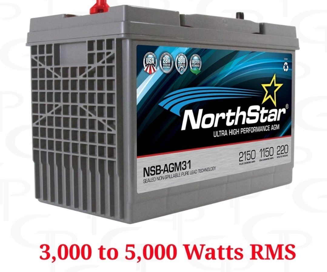

K I'll give that a try then. See what happens. Then I'll see about a 2nd batt. Good suggestions for bat?
Something like this.
