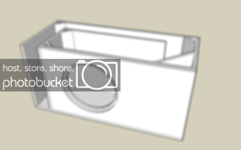

Here's a view at the enclosure for the 15" TC9
Specs come to:
-4.2 cubes net
-30hz tuning
-85 sq inches of port
Hoping to start on this within a couple days

btw just curious isnt 4.2 cu kinda big for a tc9?
Nice saturn im jealous. wish i had a shop to do somthing like this but my garage is small enough as it is lol.. Cant wait to see it all done and see a whole picture of ur whole shop with this in it:D
Thanks. And yes, 4.2 is big because im going to be running low power on it and I want to make the most of it //content.invisioncic.com/y282845/emoticons/wink.gif.608e3ea05f1a9f98611af0861652f8fb.gif

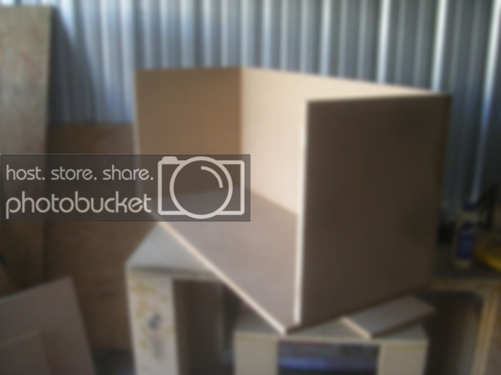

Got started on the enclosure for the 15" TC9 tonight but ofcourse my camera's batteries ran out...so pics tomorrow, it'll probably be done then.

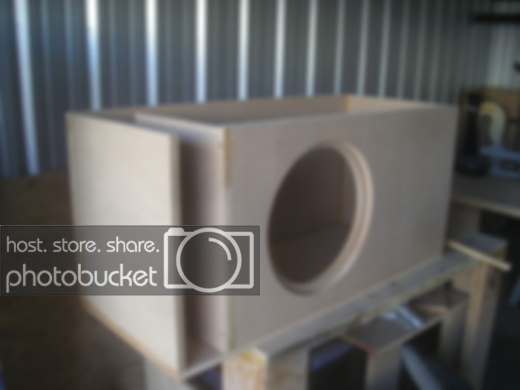

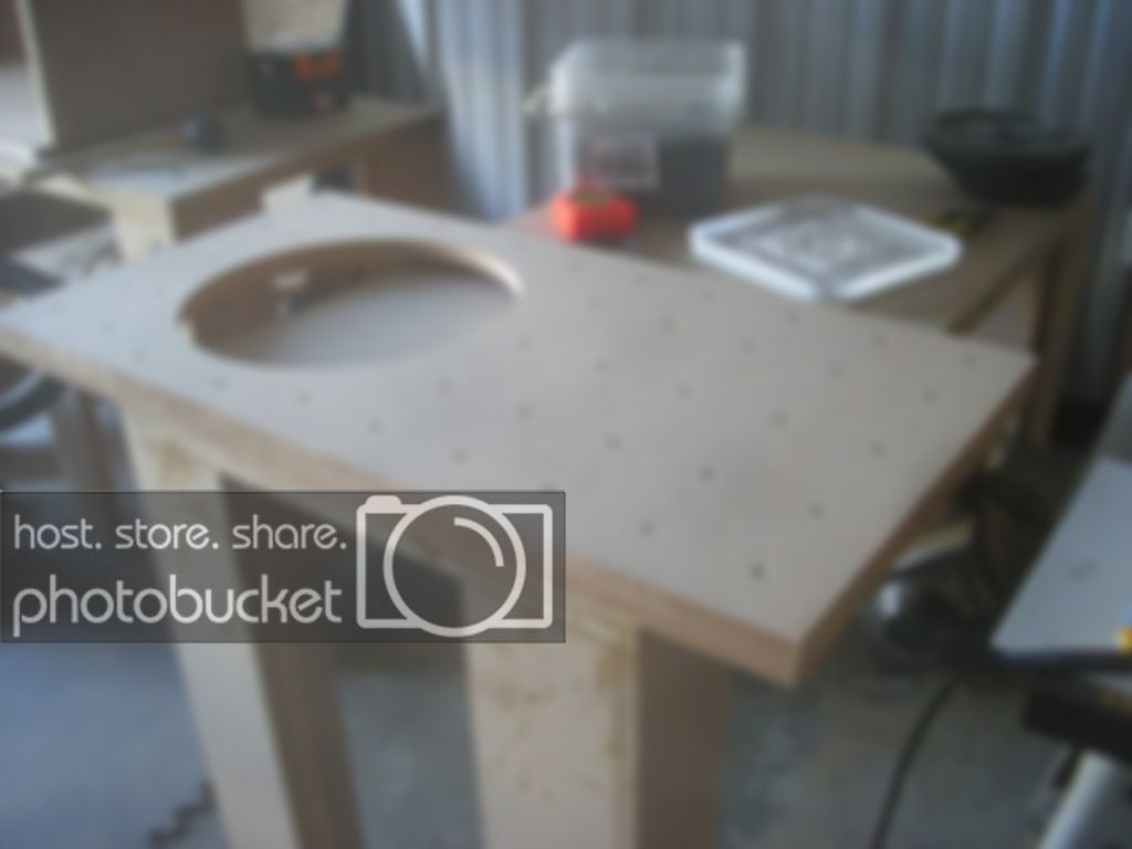

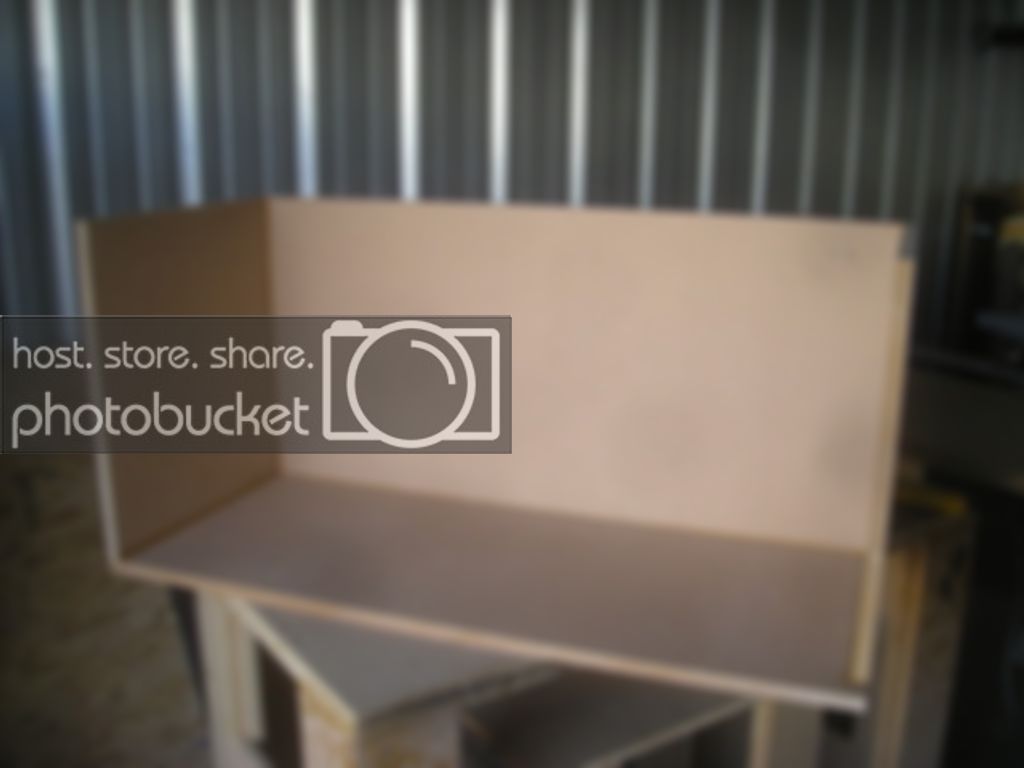

Finally got a few pics of the enclosure, it's almost finished just needs a couple 45's and the top put on.
More as it happens, hoping to get a tower of sorts made for the amps, charger, batts and everything in the near future.

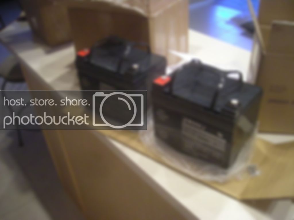

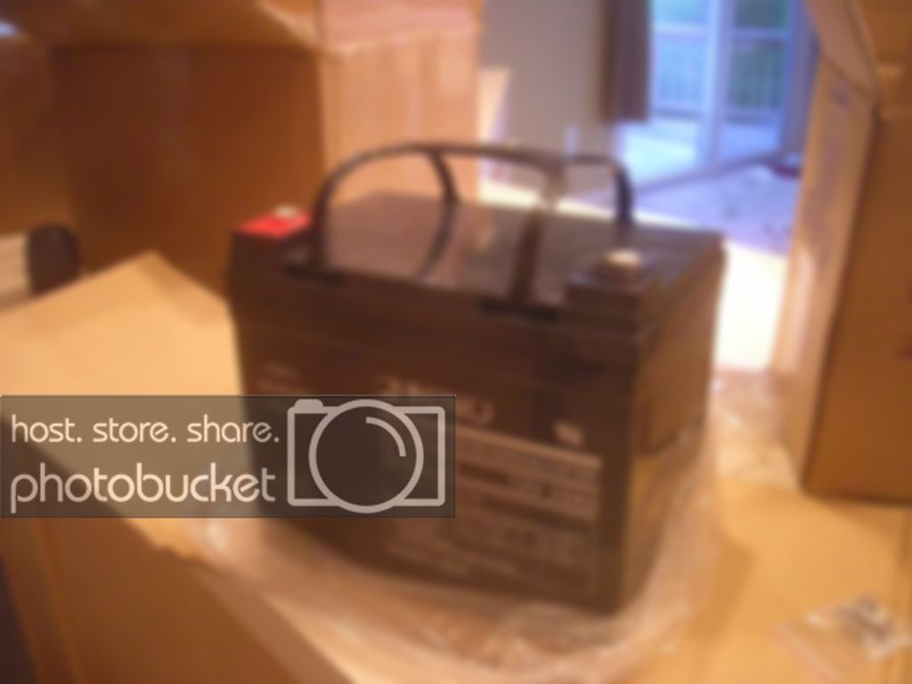

The batteries came in...
Seem to be pretty solid little batteries and were sitting at 12.6V when they arrived...later I'll be back with (hopefully) finished pics of the sub enclosure and the tower for everything to be at.
