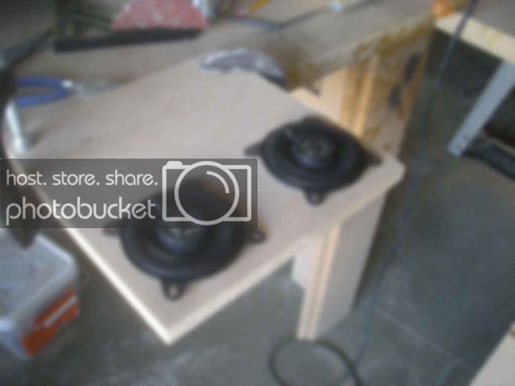

Alright, ive been working in my shop for too long without some tunes in there. So in chicago at the maxxsonics comp they had insano pricing on all kinda of equipment, so I picked up 10 4"ers for 20 bucks for the shop
And they seem pretty nice too, not too shabby. 2 will be going in each corner of the shop and one on each of the larger walls between the pairs.

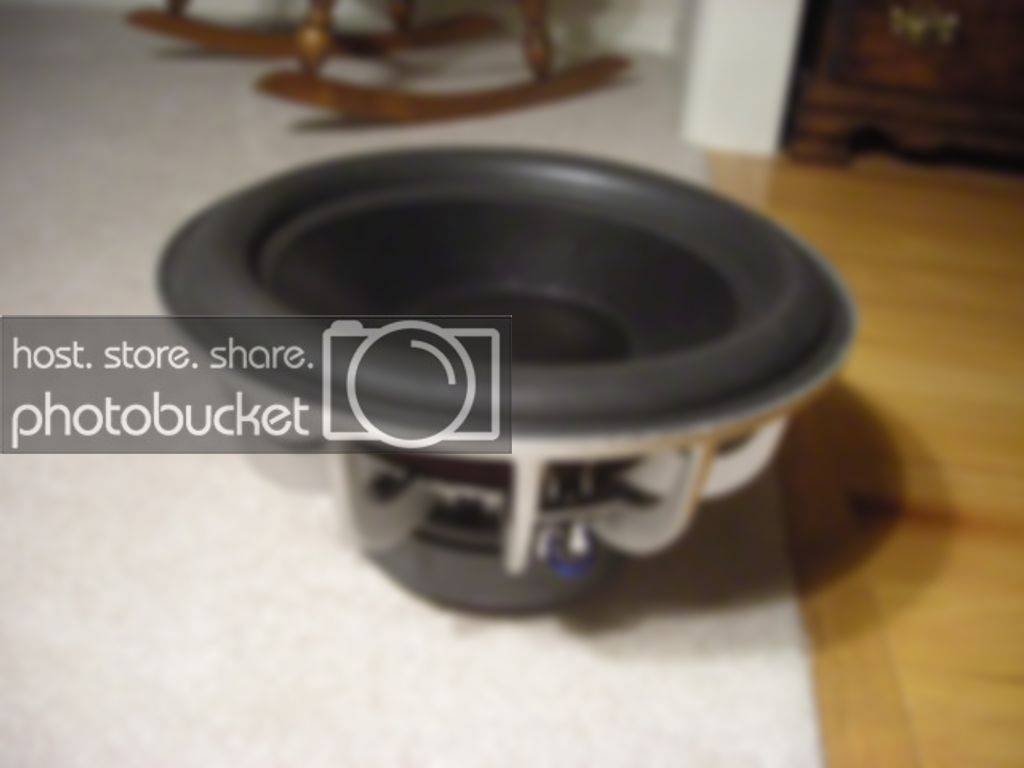

This will also include my 15" TC9 aswell in a fairly large ported enclosure, tuned low, with a healthy amount of port area to make the most of the limited power (still deciding on an amp but it wont be tons of power, it'll have to be pretty cheap). Im thinking around 4.75 cubes, tuned to 31hz, with around 80ish sq inches of port. The enclosure will most likely have grill cloth over the port to keep all the saw dust from drifting inside.

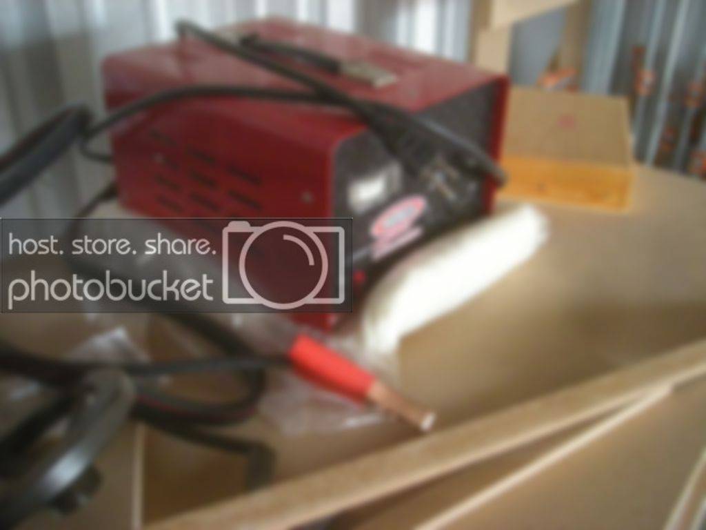

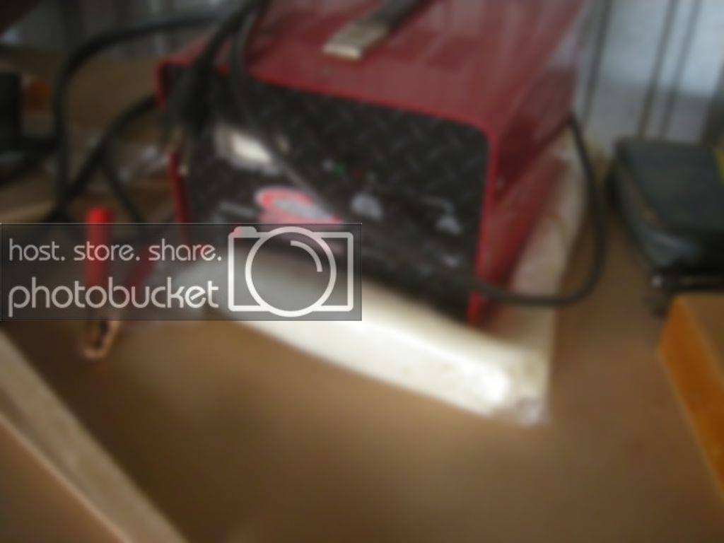

And the backbone to keep everything alive and happy, I just picked up this powermaster charger from dennis at Mechman and it is nice
I will be making a frame for this to sit in that will have grill cloth around the whole thing so it can breath but still be protected from the dust, then it will have the front/face of it on a hinge to swing up when I need to turn it on/off, adjust, etc.
Here she is..

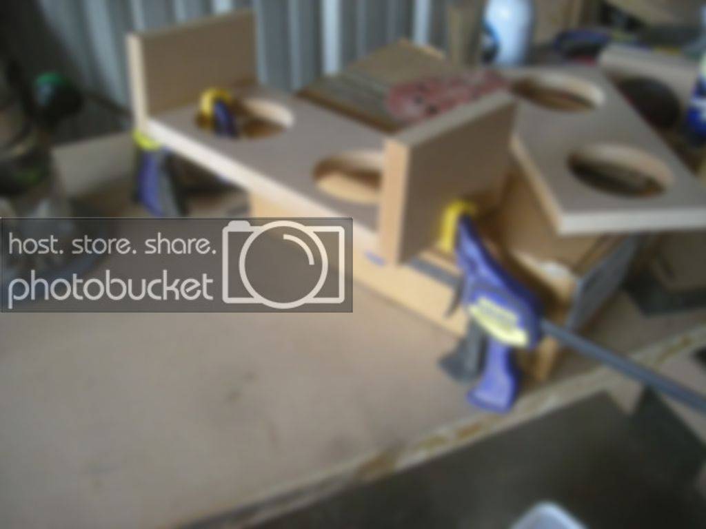

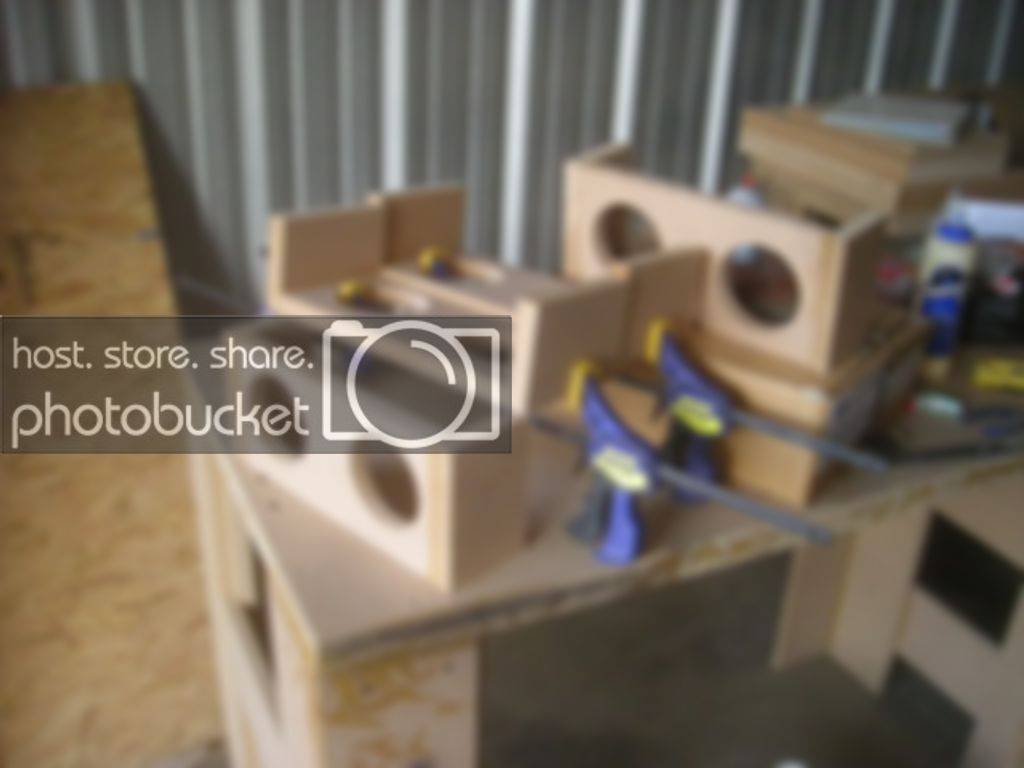

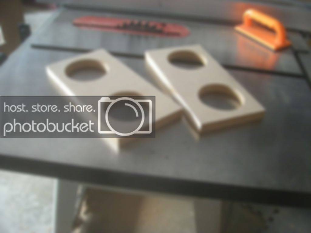

Anyways, onto the actually building of stuff..
Getting the enclosures made for the 4"ers. These will be sealed enclosures to protect from the dust and the fronts will be covered in grill cloth.
