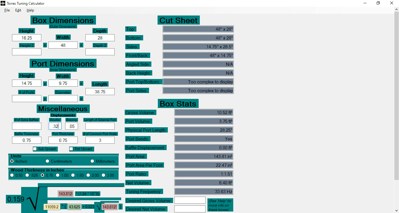

Just based off your math, you might be tuned in the mid 30’s somewhere (roughly). It seems weird to me that the cone stops moving at that low frequency. What’s your subsonic set at? Seems like the subs may unload trying to play 28 hz with where you may tuned, so idk, I would think they might be moving a good bit. Something here seems off to me.
I do know for sure your port area seems quite big for the size of the box and power, for sure.
Subsonic is at 25 I believe. I did test it with the tailgate open so the port would having just been firing out into open air. Sounds like I need to have another box built with a smaller port, preferably in the center so its equal distance between the subs.

That seems odd to me. If you have that much power and that big of a port, seems to be those subs would be flopping around below tuning frequency. 28 hz is low but it’s not THAT low, a lot of subs will play that.

Quick and dirty with Torres, that port area per foot is awfully high. Effective port length is almost 40" btw. I get like 6.5ft3 tuned mid-30's.

I think at around 28hz your cone control is gone probably.

The port parts you measured are reflected in the physical port length in the calc. Its measured down the center /w/ end correction.

Would that make sense if the cone starts moving again below 28hz? As I went down from 28 or up from 30 the cone would start noticeably moving again.

That doesn't make sense to me, at all. If your port tuning is in the mid 30's, then I would totally think those woofers would be flapping around at 28 hz, unless you have some sort of cab resonance that's causing a lot of loading. How loud is it at 28 hz vs 35-40 hz?
Somethings off and not making sense the way you describe that. It should have least excursion around tuning. The box is unloading at lower frequencies tho im sure.
