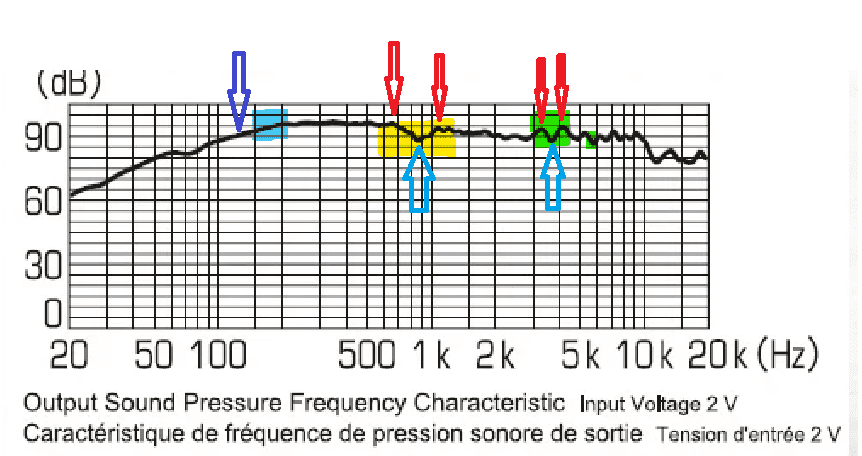

This graph illustrates why this is not really a midbass as Pioneer claims.
See that yellow section? That is around a 7-8 db dip starting at 650-700 Hz, bottoming at roughly 850 hz and recuperating at around 1k.
The green highlights a ripple of almost 5 db in a pretty critical area. 3-4.5k
Blue is where the real usable frequency starts, in this unit, around 150 Hz, and that is a 6 db downpoint, roughly speaking.
Pioneer claims 40 Hz, but that's almost 15 db down from the mean, which is useless.
That's not a bad output curve; it's decent enough, but it's fairly typical of pro-style midrange drivers.

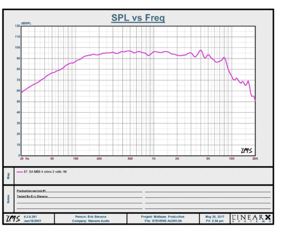

If you're stuck on the idea of pro-style high-output drivers, consider the Stevens MB6 or MB8's $89 and $98, respectively, and 10 times the speaker as the Pioneer drivers.
They will actually stay flat from around 85-90 hz to around 5k and can handle 300/350 watts RMS, respectively.

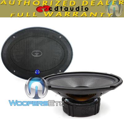

Using one of the two GM-DX874s for the rear setup, put the Pioneer coaxials in the rear doors and replace the 6x9s with a 2-ohm 6x9 from CDT (or even a 4 ohm 6x9 that is strictly a woofer, not a full-range setup, or anything that you can afford).
There is a seller on DIYmobilaudio that has a used pair for $150 us, might be easy enough to ship to CA if you cover the cost difference. I'll try and DM you the URL.
Even these as fairly efficient 4-ohm units running off about 100 watts from the pio amp, great option too.
Using a 2-ohm 6x9 woofer in the rear would give you 150 watts x 2 to the 6x9's and 100 x 2 to the 6.5's, a nice balanced ratio in favor of midbass.
In either the CDT or that Rockville, you would set the 2 channels for those drivers as an LP filter around that 500 Hz mark on the amp to ensure they are only playing midbass and lower midrange, much better. Use the HP at around 60-70 hz for the coaxial in the rear doors.

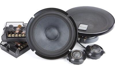

Up front, to match the rear coaxials in tone, timbre, and output, get the matching set of pioneer "Z" series components; even better, get the "ZCH" version, as the passive crossovers are much better than the standard "Z" components.
These are good:
These are much better. Bigger woofer motor/magnet assembly, better power handling, and a far better crossover that lets you run the tweeters at flat, +2 or +4 db.
Mount the 6.5's in the doors and run the tweeters in the factory locations in the pillars.
This will completely reshape the front stage, bring it up closer to ear level, improve dynamics. , improve the imaging, both R/L and spatial.
