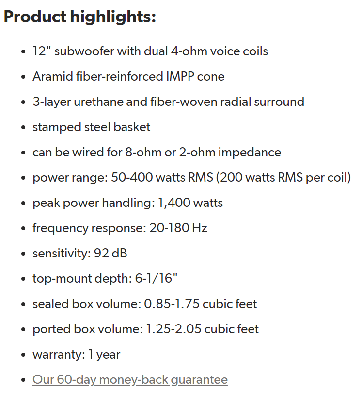

pioneer 308D4.
Ohm Rating: 2 or 8 ohm
Watts Nominal Power Handling: 400 Watts
Amplifier: AudioBahn a8002V

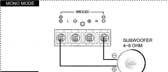

Since this amp is giving 800w rms @4ohms in bridged mono. so can i connect my pioneer 308D4 sub in bridge for 400w rms @8ohms? since the increase in ohms from 4 to 8 will divide the rms output to 400w instead of 800w? will my woofer perform at its peak with best sound quality?
Below picture is from Amplifier's official manual:
32542
Your subwoofers are dual 4 ohms. Consequently, you can wire each voice coil to each set of speaker terminals on your subwoofer amplifier.
