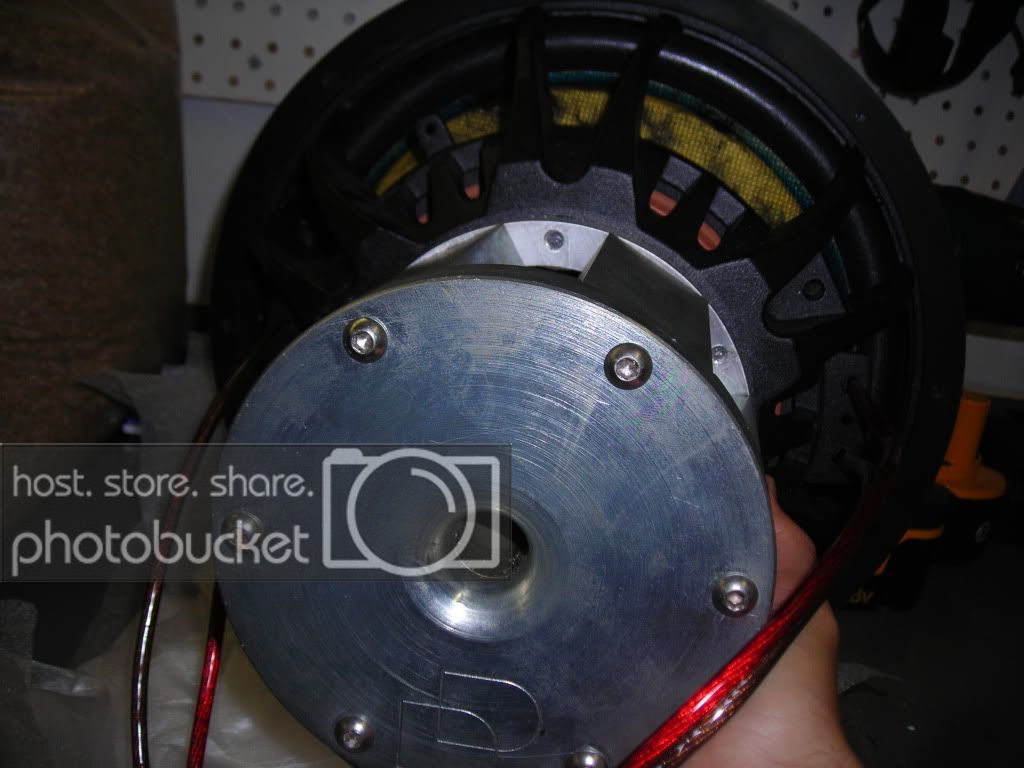

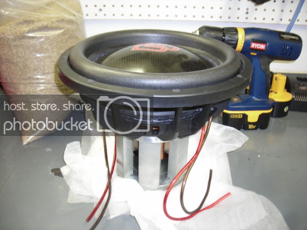

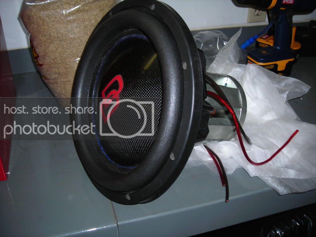

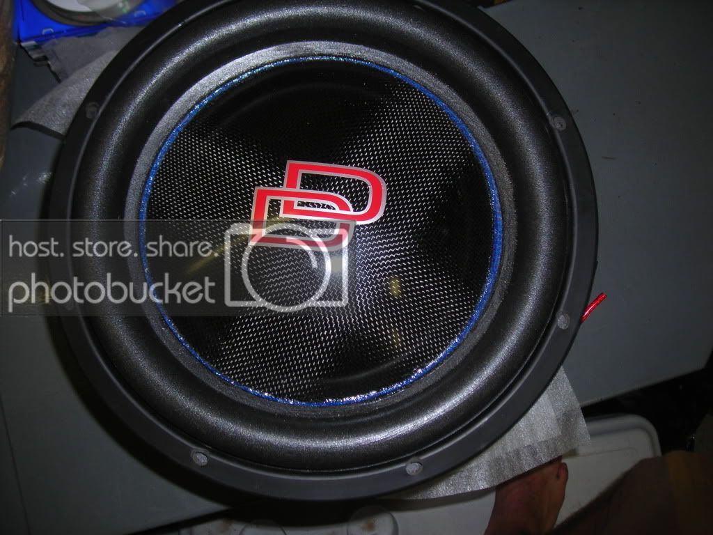

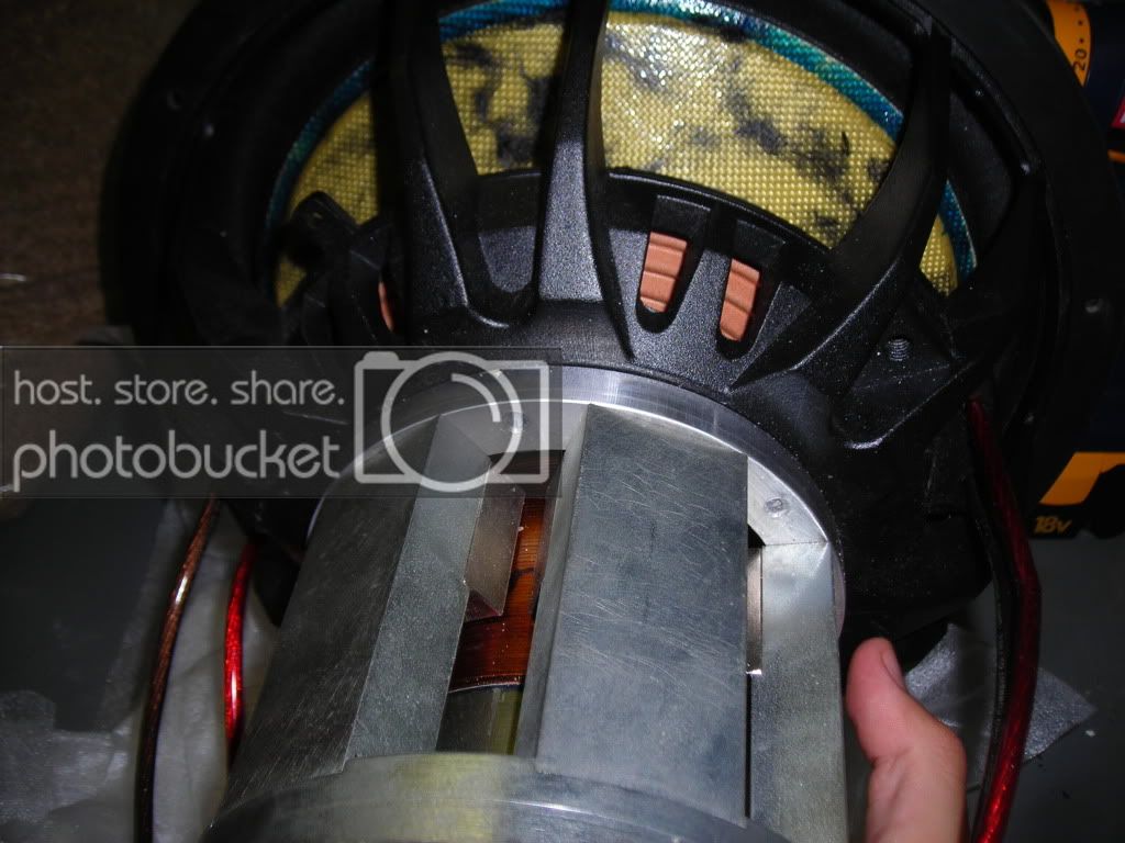

New xxx replacement... DD9512z reconed from loudman, dual 1.4 ohm coils, 8" carbon fiber dome, Blue Composite cone, Wired in series on the 2k6d, in 2.9 cu ft^3 tuned to 35hz. So roughly 2600 watts for music, without knowing box rise. Gonna be nice!

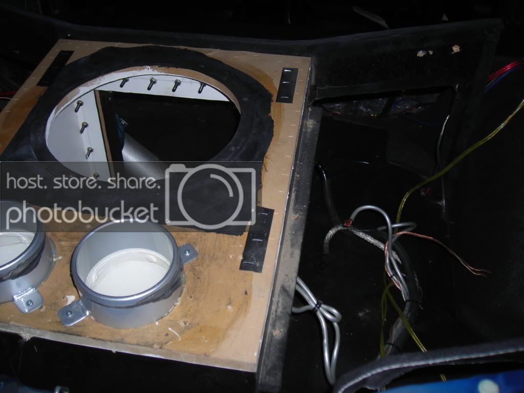

Car got in an accident in feb, had to rip the stereo out to get at the rear end. Shell of what it once was... 9512z will fit in nicely. Should have it all back together tomorrow as i just got the car back from the body shop friday.

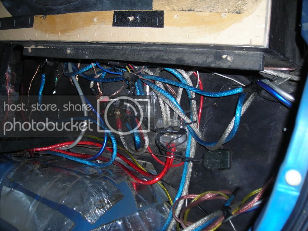

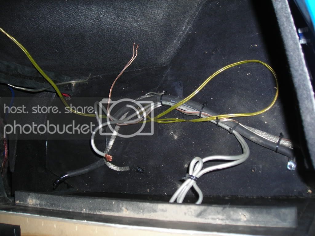

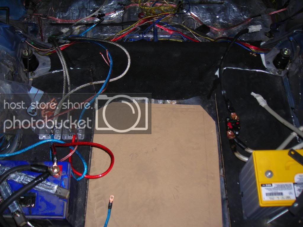

got my pwk box design, awaiting the build by local dude. Not going with 4k2d (not that i know of atm, unforseen problems with stuff), went with a deka group 31 AGM battery, re-wired the car, put in HO- alternator, upgraded to 4/0, 3/0, 2/0 and 1/0 throughout car... pics in a moment

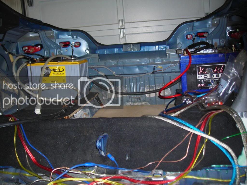

compare to the above rats nest...this is the new look of the wiring + new battery, sans the box, as its not built yet.
The battery on the right will discharge directly to the 2k6d, with a 300 amp circuit breaker between the two, no external fusing for the 100.2 or the pdx 4.150 which will be on the left
