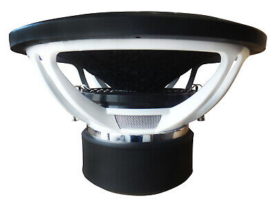

Dude I would love a single 15 especially one like this. But I only have about 17 inches of height maximum in my trunk. I guess I could build at an angle with the sub facing more upward but that throws off the geometry and I can’t do those calculations.
I was going to recommend Oz Audio Vector but that NVX looks better.
Check out the dimensions of the outer baffle ring, you should be just fine. My enclosure is hosting a 15" Hertz SX 380D with 15.5" height clearance. The ring basically touches the ground, but it doesn't matter.. the hole is 13 13/16" in diameter. The mounting plate is 15 3/8"
