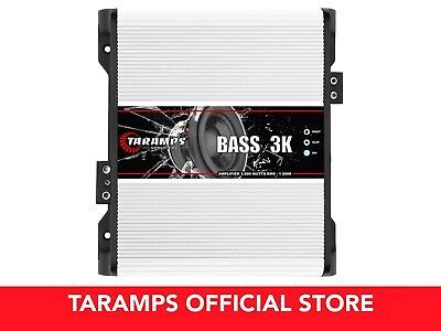

If you want an inexpensive otpion for powering that sub I sugest the folloing:
3k Watts for $249
2k $210
2k $200
2k $195
1.5k $169

I would not buy a Rockville amp. For one, that one is a 6 channel and not appropriate for that subwoofer, totally wrong application, and that aside I would get something other than Rockville as well. I'd definitely take the Taramps and some of the others Doxquzme listed over that Rockville.
Really want something that is known to do rated power and somewhat reliable. Might cost slightly more but it's worth it. It's easy to jump the gun and just randomly buy stuff, but take in some suggestions first before just diving into it.

Yes I was actually doing my research on Taramps and they seem to be a very reputable company. Would the 4 gauge wiring kit be the correct size? Would I also need to upgrade my alternator or battery? By the way I will be getting this setup professionally installed.

That Taramps is a good fit and when deciding on a Taramps, stay with their Smart BASS models. As for wiring an what not, just plan on a good 1/0 gauge OFC copper wiring kit to get that done. Anything else inbetween 4 and1/0 is going to be kind of funky with distro blocks and the like connectors. You will always be able to find 1/0 and 4 gauge ins and outs for anything you wire up with it.
AS for current draw, here is a great video on current draw and what you can expect depending on use.
If you are considering drawing real current that a 2k or 3k amp is capable of, start with at least 1/0 gauge wire, an oversized AGM under the hood and the big three upgrade or a parallel run of wires to a 2nd battery before considering an HO alternator which is kind of the last thing to do with LifePo and other lithium offerings an such.
These are great for the 2-3.5k upgrades.
