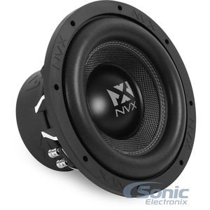

The NVX VCWs are decent $150 subs. Would be my choice for $150 subwoofers for sure.

I don’t think the nvx product is bad At all, their wiring I’ve used from speaker wire To power wire to rca’s is pretty decent...v series rca’s are simple and don’t fall apart at the connector.
The x series separates are good and their v series components sound good for the relatively low cost. Also their vcw subs put out for $150-$180. A Homeboy at work has them and build quality seemed solid for entry level budget prior to install and they sounded good in a ported enclosure final install. Not sure about their new amps but their old 900.4 and 1200.1 were hertz/ppi clones from a real power output vantage point. New ones run loud per big d but they put out close to rated.
