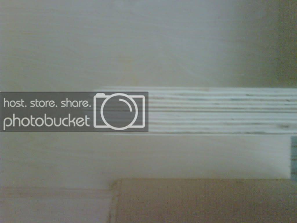

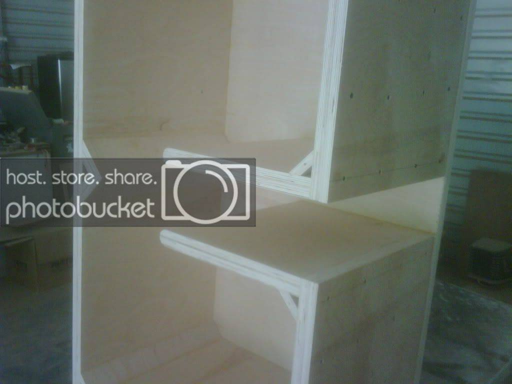

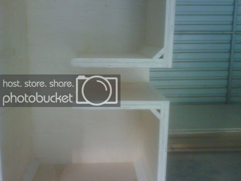

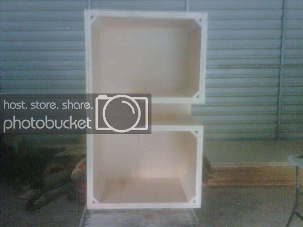

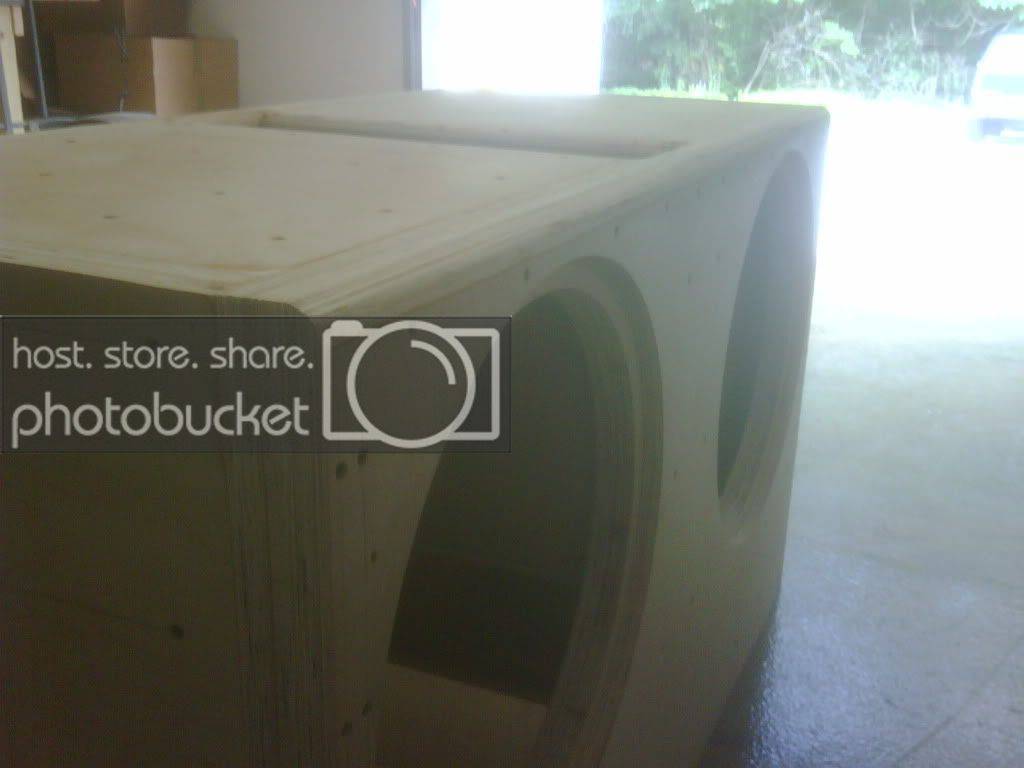

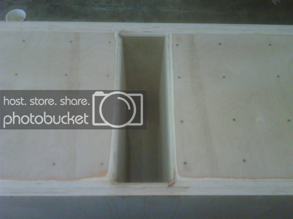

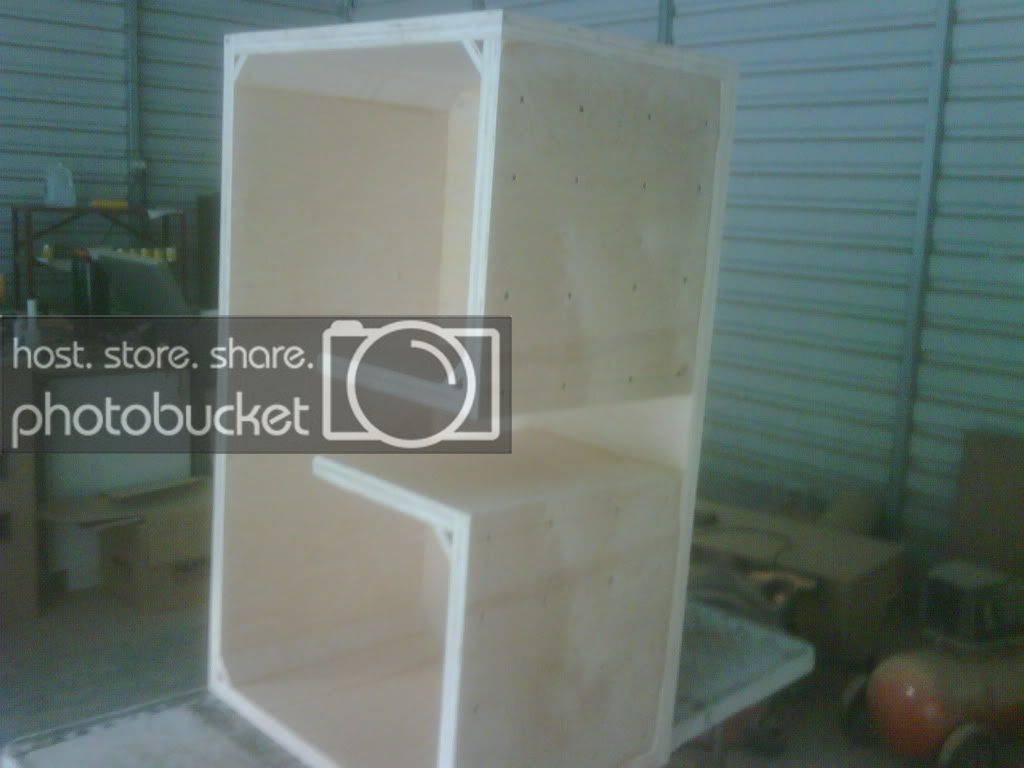

Ok here is the new box.....................
Box is for two 18" single spider HW V3s
Box is 11 cubic feet after displacement with 116 square inches of port tuned to 36Hz
Box is made of 1-1/2" Birch (double 3/4" all the way around)
