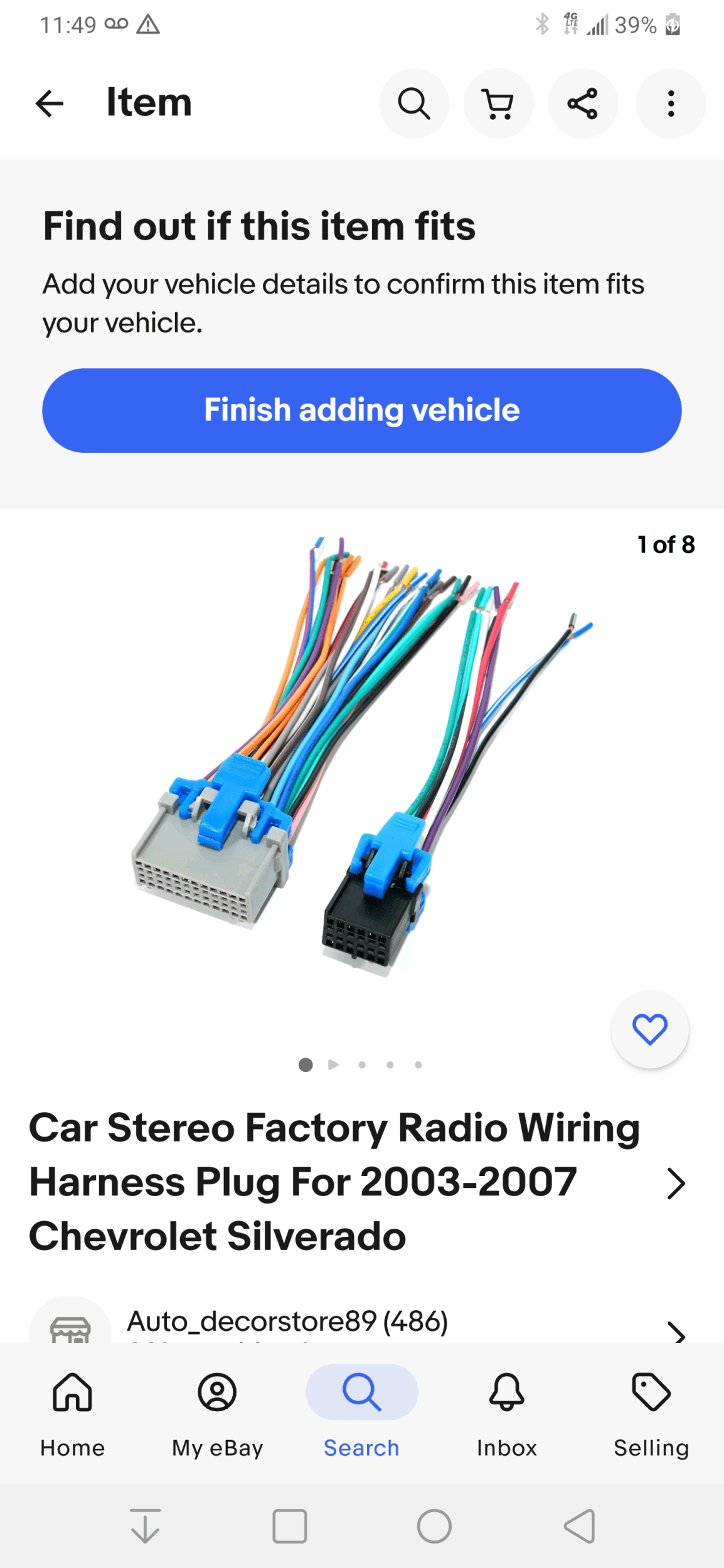

If the original radio connector is gone is there any place other than a junk yard to get one?
It says Silverado but works on many GM vehicles.

To finally answer your question, you have a vehicle harness with a plug/connector that your factory head unit would have plugged into. It's possible they screwed it up, but not likely. They SHOULD have just unplugged it, and used an aftermarket harness to plug between the vehicle harness and the new head unit. (That picture above has the bare wire ends connected to the bare ends of the harness that came with the head unit).
I would pull the stereo out and take a look. Stereo adapter harnesses are common and cheap when installing a aftermarket stereo. It may just be a matter of unplugging the adapter and plugging the factory stereo back in.
No way to tell if the wiring is bastardized without looking for yourself. Wiring adapters are cheap enough at installer.com.
