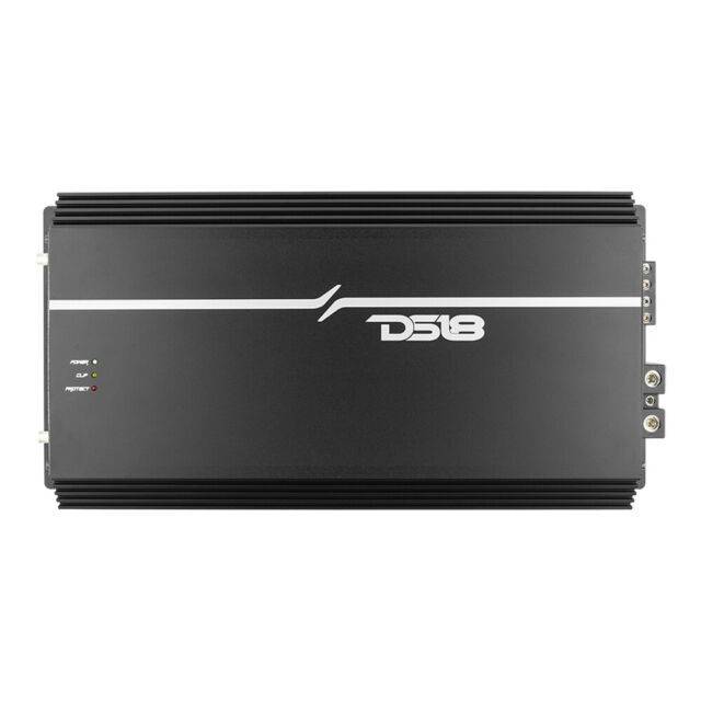

They are good, but just get a 4K DS18 EXL One amp, Rember, when strapping amps, it's the same as running a 2 channel in bridged mode, you can;t run the stingers at 1 ohm strapped, 2 ohms is the lowest and at 2.66, it's similar to a single amp at 1.3 ohm which you're trying to avoid. THe DS18 EXL model is a Korean board and is worth the $130 extra, No matching gains, etc. Strapping is great if you want to start at a certain $ point, then add more later. Just my $0.02
