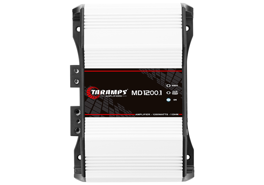

if you run your wiring smart the footprint of these types of amp may actually be smaller than a five channel
Is that brand decent? I suppose I could go separates. 1200W @ 1ohm could be beneficial with it being so small. But almost seems too good to be true.
It’s a good brand bro, it’s full bridge “Brazilian” technology. Make sure you have a good agm up front, Do your big 3, use nice and thick power wire for your sub amp (1/0 to 4 guage reducer ends) and make sure your voltage is strong and all will be good. That power opens up the door to more boom and some solid budget options. There’s an md1800.1 that is like 2” longer but Same width and thickness for like 20$ more that will give serious boom.
