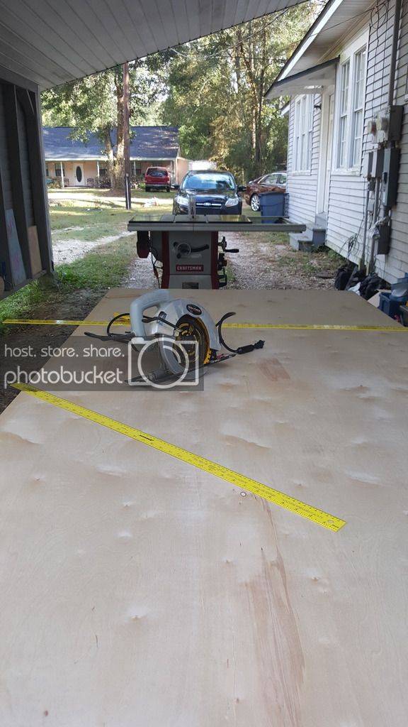

4.1 sealed, 10.2 ported, 46.5 hz, 210 sq inches. I can drop to 180 sq in and 45 hz or cut 2 inches of the external section of the port and go up to about 50 hz.
Oh and we wound up with birch because it was 11 ply. The oak was 7 ply. Switched just because of that.

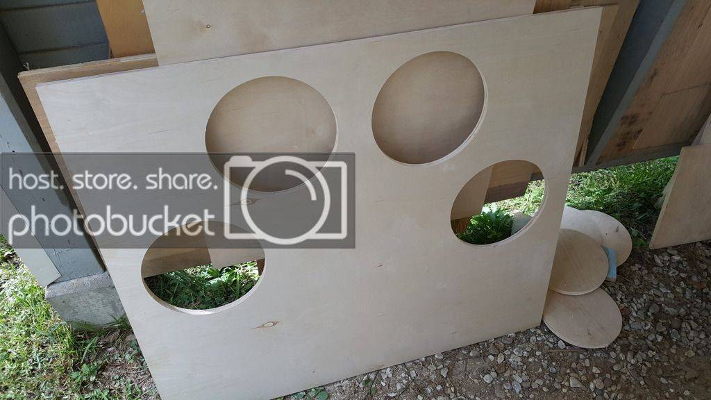

Got a little bit done yesterday after work. And I shrunk my port down to 190 sq inches and shortened it to 49hz.
The speaker is a UE megaboom for size reference.
The 45s and a slew of dowels will set my oorted section height for the baffles to rest on and provide strength. The subs will mount in the sealed section so the baskets hang into the ported section. Like EXOs dads blowthrough but verticle. The sealed section was planned as 4 separate sections but the port made it impossible to mount the subs in a square pattern. So its 2 sections now with dowels and 45s to take up airspace and add more strength. Im also gonna use the last foot of my 16 foot dowel to make sure the lid doesnt flex at all.
