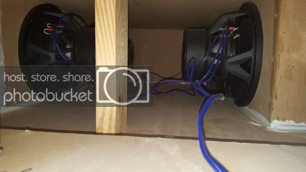

Since this was finished we've swapped the Pipe for a Taramps 8k and it's beating this box to death. Even with the 2x4 internal brace the top and bottom of the box flex like crazy. It's about as bad as the windshield. I never was truly happy with my design to begin with because it didn't offer any simple access to the subs should something break. So we're going to rebuild out of oak ply this time and change up the orientation a bit. I need y'alls help though.

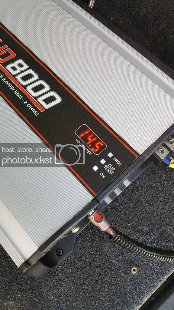

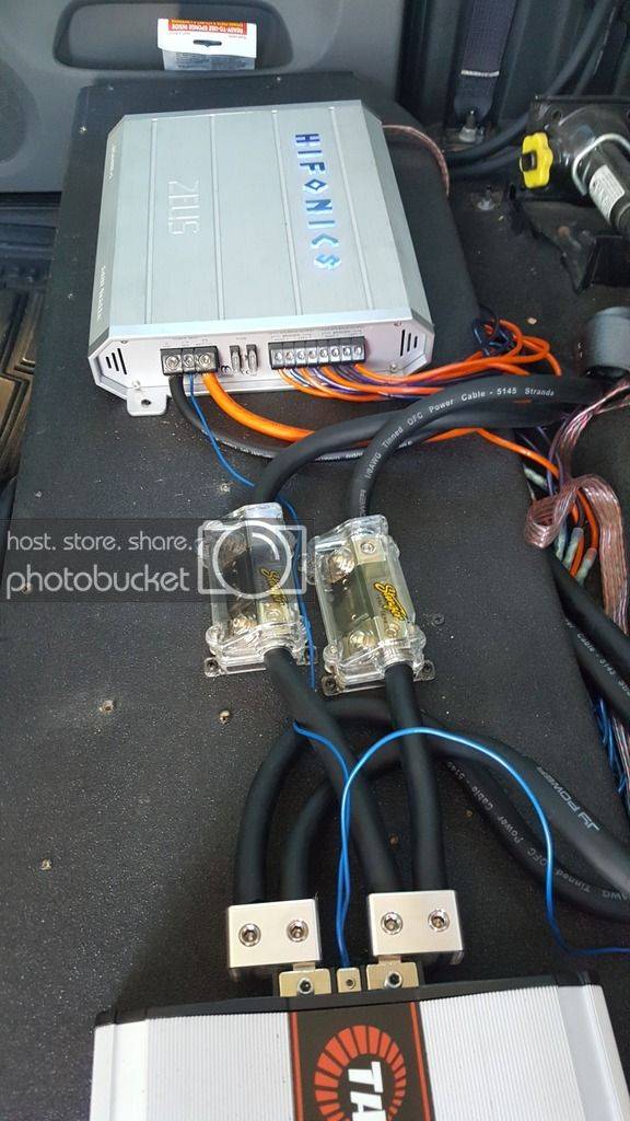

Added 40ft of JY 1/0 wire a few days ago. It's a bit cluttered but all connections are solid and hanging in the 13.5 - 14 range on music. Test tones drop it into the 12s but still safe. It was hitting 10.8 before this.
Stock alt + 240 amp and 3 Optima Yellow Tops.
