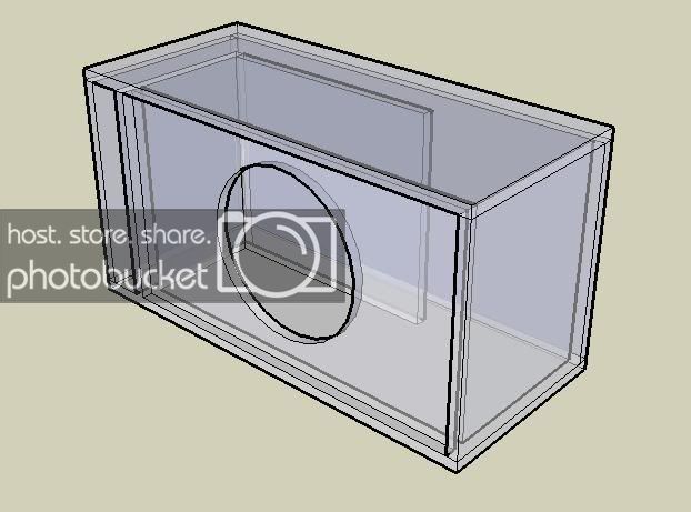

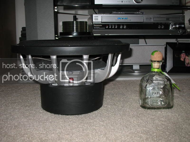

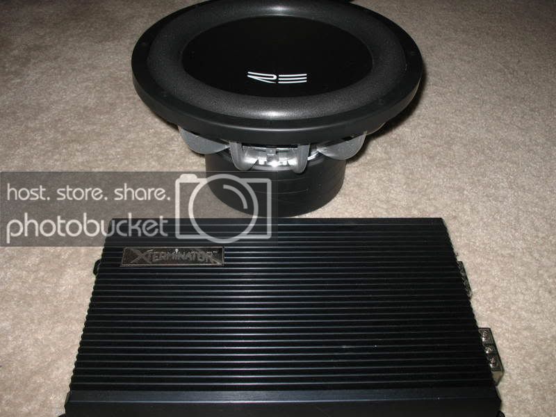

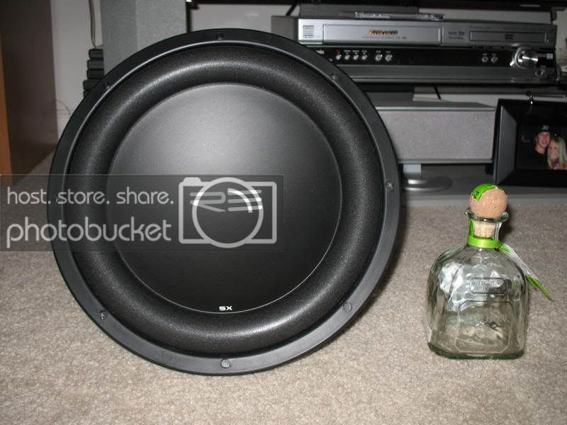

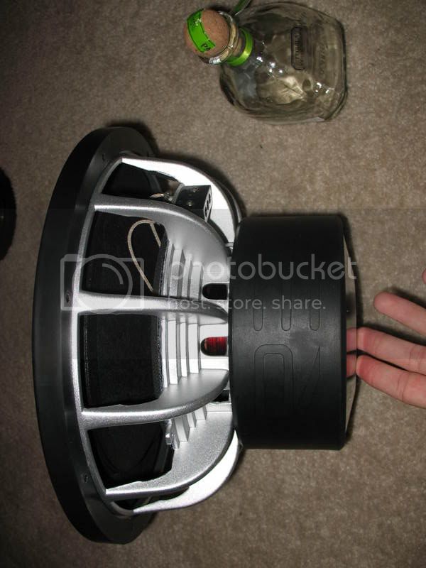

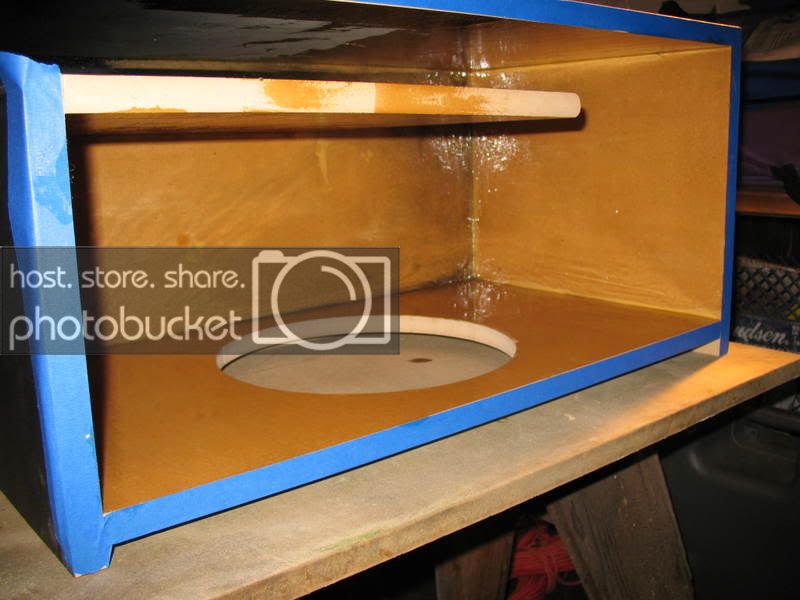

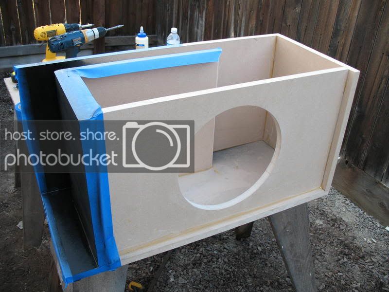

For my chics B-Day shes gettin a whole new system. She knows nothing bout it so it'll be a good surprise:D. Anway, she wants some bump an wants it to get semi loud. Figured a 12" SX will be plenty, Powered by a USAmps XT4000D. So the sub should see bout 1000 watts or so. Box is 2cubes @34hz an will be resined(sp?) on the inside. Gonna replace the cheapy pioneer coaxils up front with RE6.5 comps powered a USAmps XT800.2. Each door will have 2 layers of Raamat BXT + Ensolite. All KNU wiring an RCAs.

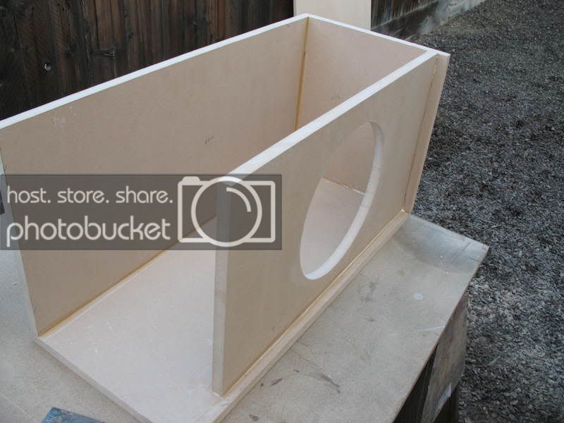

Got somewhat far on the box today. Letting the resin dry over night an will finish it up tomorrow.
For a paint scheme Im paitng the baffle a high gloss pink anthe rest of the box will be a high gloss black. Anyone have a recommendations on what paint to use? Ill be using a spray gun if it matters.
