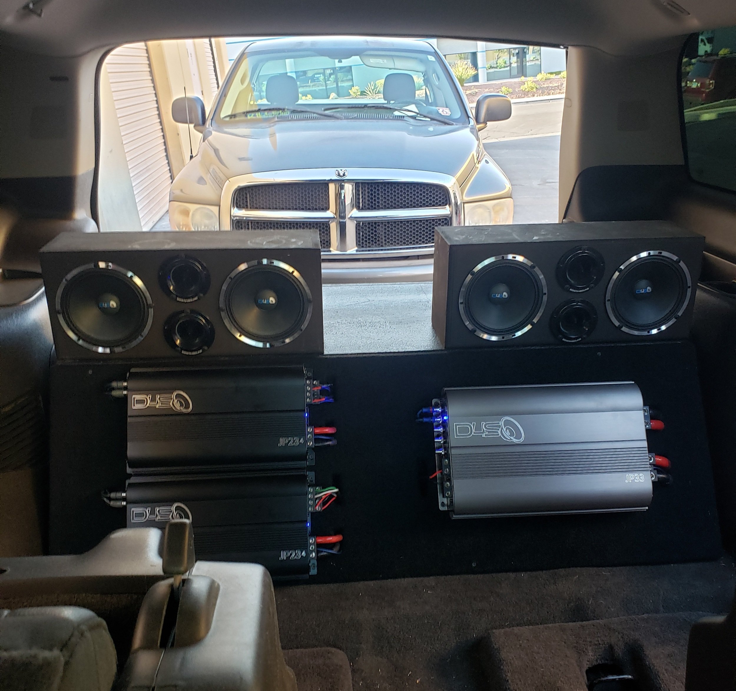

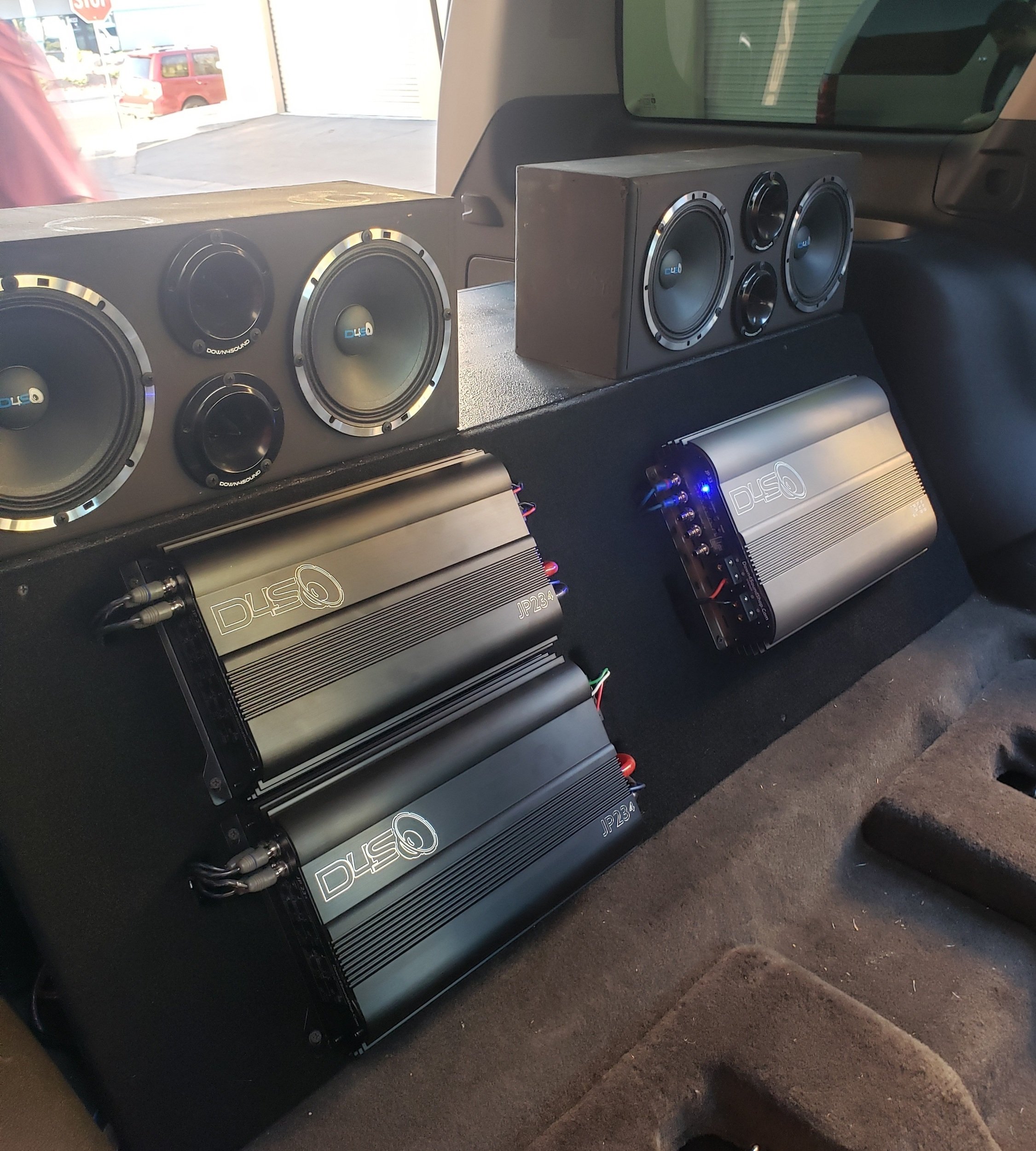

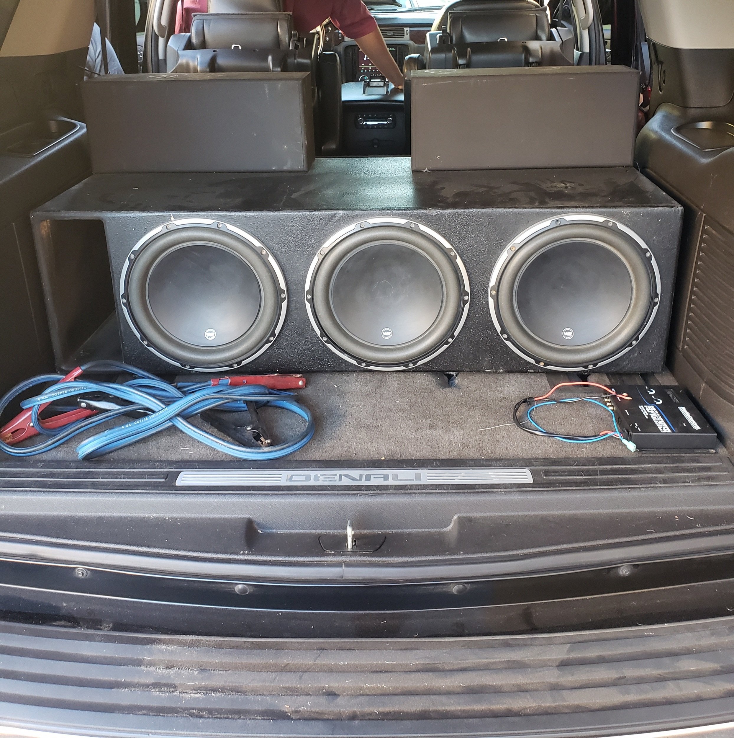

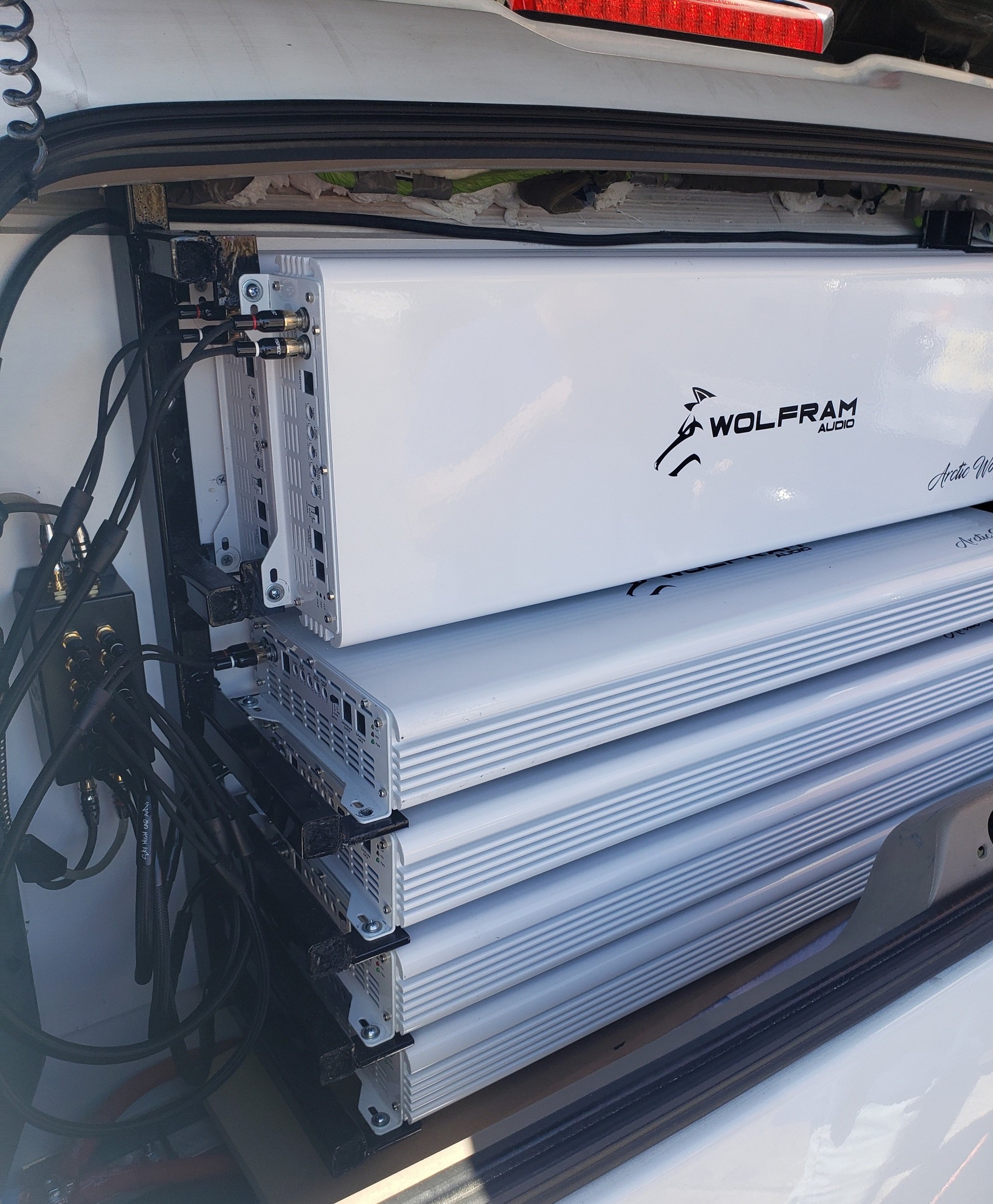

A guy came in to get three amps installed. Two JP234's for the mids/highs and one JP33 for the bass. The bluetooth bass knob is weird and is going to be a problem for people. Nice 3 JL 12W6 build in a Tahoe. The box was only 3.6 cubes net. Ended up removing one of the 12's and it sounded 100% better. It was just as loud and dug way lower.

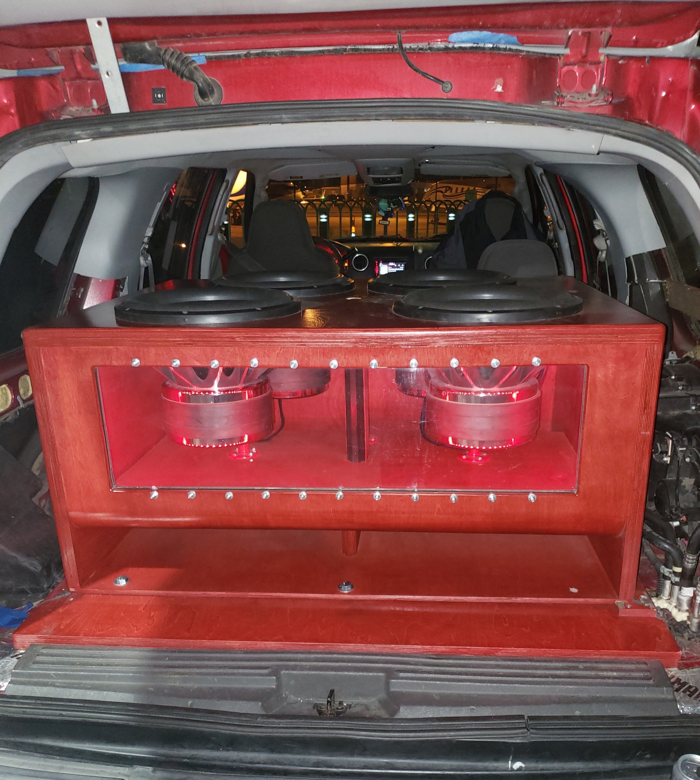

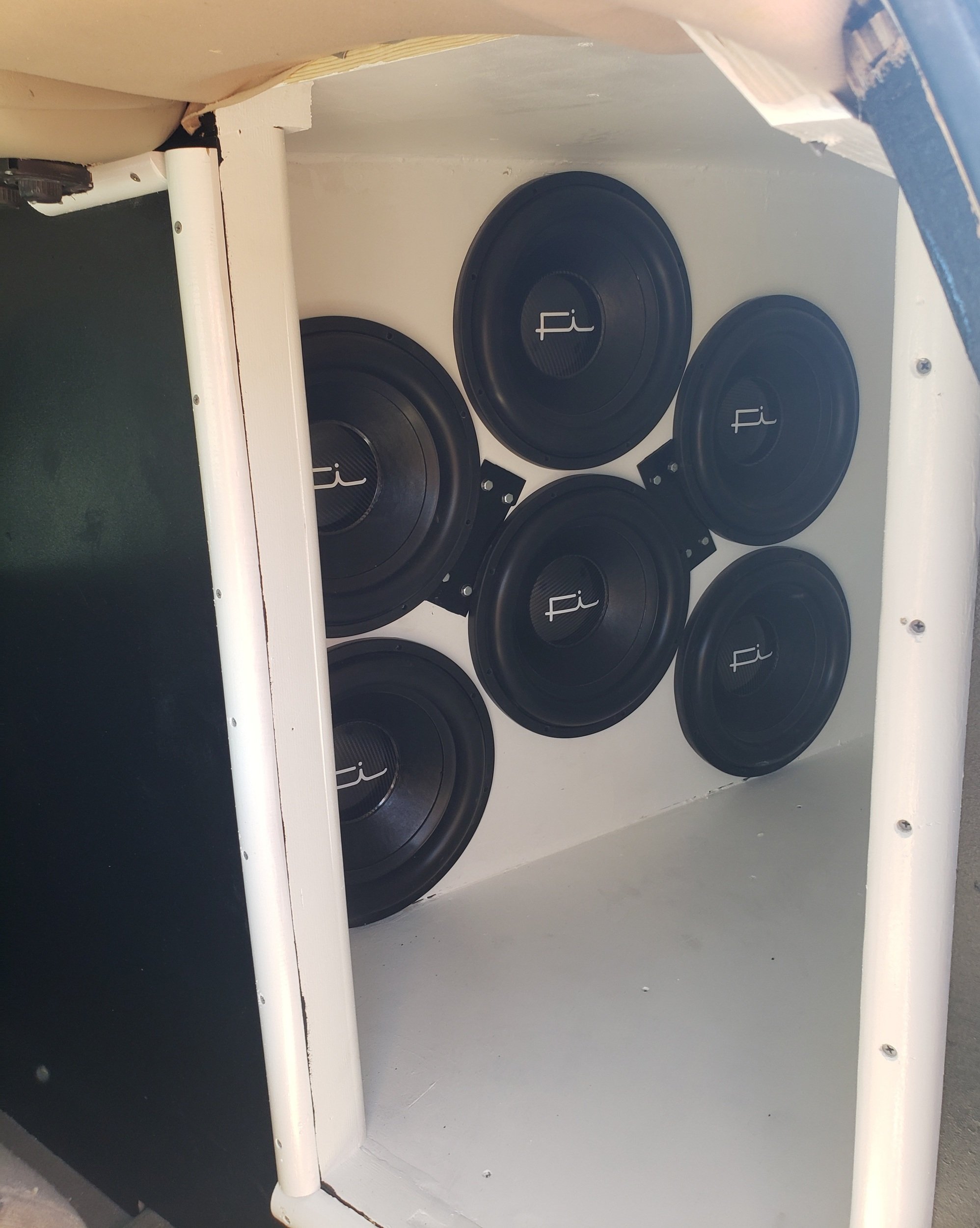

Fourth order blow through box for 3 - 15" Fi 4.11 neos going in a Chevy crew cab. Being powered by a Wolfram Arctic Wolf 9K. It is nasty. It's obviously not installed yet in this pic.
I always love seeing people with higher end JL subs only to be pushed by cheap budget power. Not knocking the D4S amps but I can think of many other choices if cash isn’t a problem
That amp is Korean and a little beast. The bass knob is brutal though. It takes 4-½ rotations on the bass knob to go from zero to 100.
