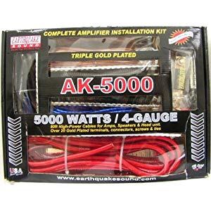

Yes, I was a noob and bought something right off the bat when a seller told me it was good.
Now, back to the present where I actually check stuff out before I buy them...
Is this any good, and why? (Or why not?)

What wiring kits do I need for both amps? I already have the one pictured above. I use this one for the speaker amp, the Tarantula, right?

That one is pretty much useless unless you use that wire for the 4 channel amp... Order 1/0 wire and run it to a distro then cut that wire down and run it from the distro to your amps... If you keep it short it will probably be enough for each of your amps
That looks like 8 gauge wire in the pic. Lol. Either way, you need larger than 4 gauge. Like Bettr said, a run of 1/0 to a distro with (1) 1/0 in and (2) 4gauge outs for short runs of 4 gauge to the amps should be fine. I don't know if they ship to canada but audiosavings has cadence wire which is pretty nice and its cheap.

Alright, so your suggestions are that I sell this wiring kit, and get one GOOD kit of 1/0 GAUGE and use it for both amps?

Well considering someone said I could've used only 1/0 gauge for the whole thing... This AK-5000 kit is now useless, so I might as well sell it!
What are your suggestions?
Well considering someone said I could've used only 1/0 gauge for the whole thing... This AK-5000 kit is now useless, so I might as well sell it! What are your suggestions?

I checked it vaguely, thanks for the OFC suggestion, I'll surely look into that. The only thing I need to be sure about is how I'm going to wire my stuff, do I need this 4-Gauge wiring I listed above, or can I only get some 1/0 Gauge and use that for everything? I'm confused.
Seeing that you're running 2k watts, just run the 0 AWG from the battery back to the rear. From that point you'll have a nice run of electricity to feed your amps. At that point, get a distribution block with one 0 AWG input with your desired outputs and wire up your amps.
You could also use welding cable. Not pretty but cheaper and true copper.
Ok but my battery will be a Deka in my trunk, just next to the amps and the subs... Would that cut down on all the big wiring job? I'm such a newb at this lol.
Can I just get 0 gauge wiring and make it go from my Deka battery to my distro block (that I'm going to need to get, any ideas?) and then get some small 4 gauge wiring from the distro block to the amps?
Ok but my battery will be a Deka in my trunk, just next to the amps and the subs... Would that cut down on all the big wiring job? I'm such a newb at this lol.Can I just get 0 gauge wiring and make it go from my Deka battery to my distro block (that I'm going to need to get, any ideas?) and then get some small 4 gauge wiring from the distro block to the amps?
I know exactly what you're trying to say... Just run the 0 gauge from your front battery to your rear battery (fused of course). From that battery, you'll wire from your distro.
There is great info on here as to why you want to feed your electrical system well. Don't skimp on the electrical... Just browse through the electrical forums and you'll see that guys like bettr, civic, mitch, taylorfade, mylows, etc already answered a lot of the questions you have.
