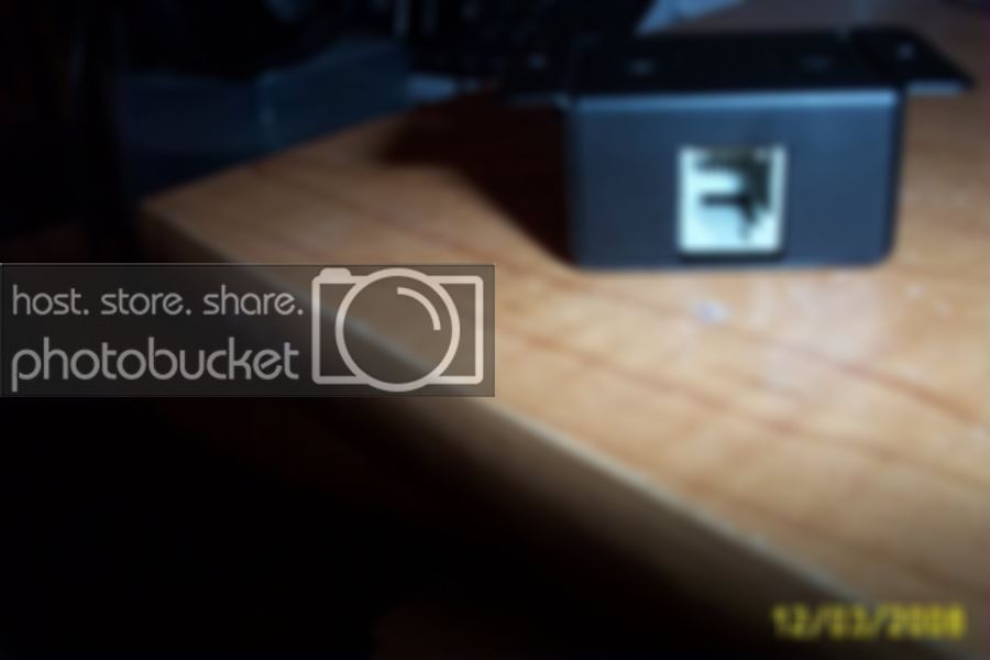

First off, the back of the unit has something that looks like a phone jack plug, now forgive me if this is obvious but is this designed for a regular telephone cord?
