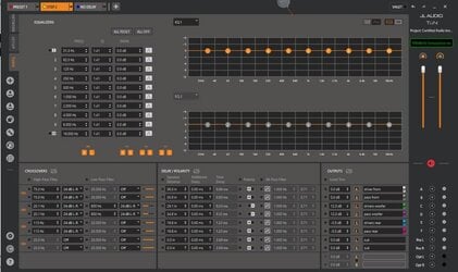

Parts of the stereo sound better with the new equipment.  The subs are better tuned; there's no overly obnoxious frequencies anymore, but there's still stuff that just seems off.  It sounds okay, but I feel like it sometimes doesn't blend well together, highs can sometimes be more harsh than I'd like and midbass appears to be lacking (i'm aware that the 8" woofers in the stock locations may not provide the best mid-bass).  I assume it just needs some EQ.   I connected a PC up to the JL Audio amp expecting to see crossovers, equalizer settings, etc.  What I found was attached screenshot containing crossovers, time alignment, and levels.
  1. Based on the equipment, do those crossovers make sense (i'm clueless when it comes to setting crossovers at the best of times)?
  2. I've never used a Mobridge product and am just realizing (as I pasted the link above) that it does some DSP stuff as well as the JL amp.  I was surprised to not see the subwoofer crossovers/time alignment within the JL amp.  This could have been done on the alpine amp (crossovers at least - can't tell cause it's so stealthily installed) or within the Mobridge (just learned I could connect a PC up - have yet to do so).   Where would you have done the crossovers/related for them?  Is there any reason this couldn't have been done within the JL Amp (with the rest of the speakers)?
  3. I don't know that the Mobidge device is easily accessible, but can I connect up a USB cable to it and expect to read the current settings without overwriting anything (unless I choose to make changes - unlikely - just trying to understand things really)?  According to the documentation, they imply there's a save-as button to backup settings (this would be my first course of action - software doesn't currently appear to run on my PC - it opens and immediately closes so my knowledge is limited at this point)
  4. Based on the setup, would you expect any DSP related settings to have been done in the Mobridge at all?
  5. Any other advice or concerns you would have?
