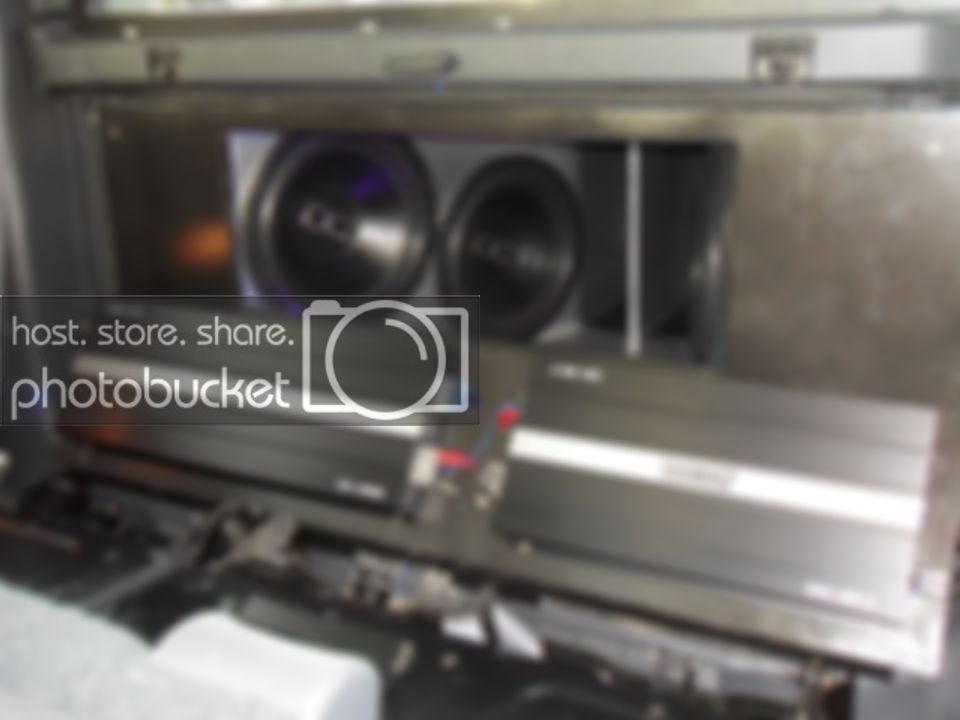

Okay, let me try to explain it better.
1st box was a ported box, designed as a ported box. It peaked in my vehicle at 29hz.
So, for kicks, we modeled that box as a 6th order (took in account the front chamber), and with the acoustics of my vehicle included, the math showed i would peak at 29hz, which it did.
SO, i wanted my vehicle to peak higher. We figured since when modeled as a 6th order, it correctly predicted my 29hz peak mathematicall, we took a reverse approach, said we wanted the box to peak at 35hz, and reverse modeled the design.
So yes, its not a 6th order, but we used the math behind a 6th order design along with the acoustical properties of my vehicle to create this box. I have no idea what the box is actually tuned to, but i do have a good idea of where it will peak in my vehicle
I hope that makes sense.
