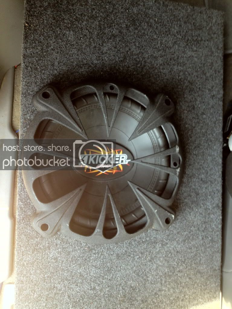

let us know if it is a 4 ohm DVC sub. it should say on the magnet or basket. pics would be a huge help.
I took the sub out of the box and there was no sticker or anything.
Here is the sub:

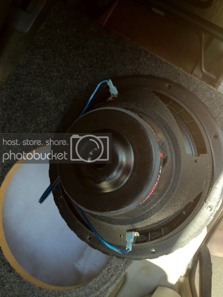

Here is the back of the sub:
--The "Top" lead is the positive lead. And the "Bottom" is the negative lead. There's two "terminals" on both sides that I can plug a wire into.
ok. so it is a 4 ohm SVC sub. the amp should be able to handle it bridged. if it cannot, it could be gain setting.
the sub wiring is solid. thanks for the pics.
