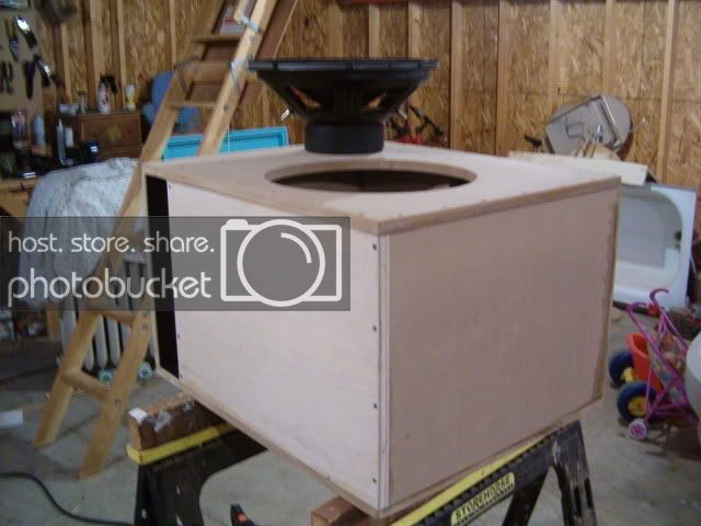

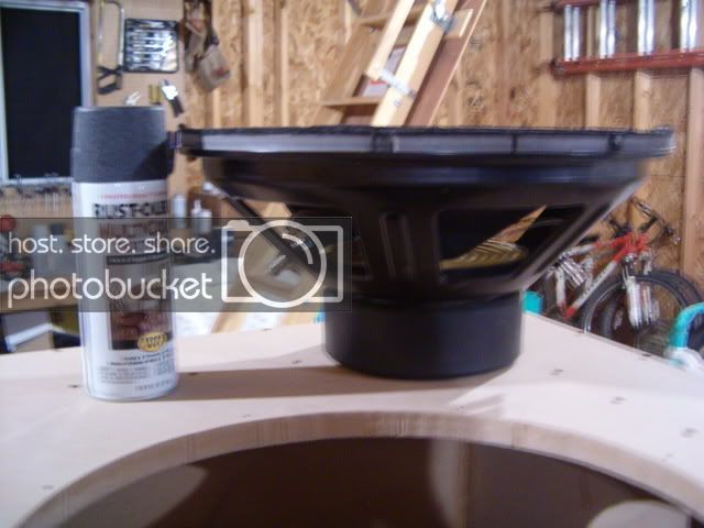

the sub is my basement, Dayton DVC series 15" subwoofer(600wrms) powered ny a dayton 240wrms plate amplifier(ya thats right) at 4 ohms. 3.8 cubes tuned to 28-30hz. i thought this was loud, but this box just got wrecked because my basement flooded so im in the proccess of building a new box
the new box is 3.8 cubes with roughly 53" of port tuned to 30hz. the last box was made the RE calulator so i dont know how accurate it was, it could have been 3.4 tuned to 32 hz for all i know.
this sub is actually pounding pretty good, but with my camera the sound is terrible so bear with me
this is the box before i painted it
comparison shot of sub
