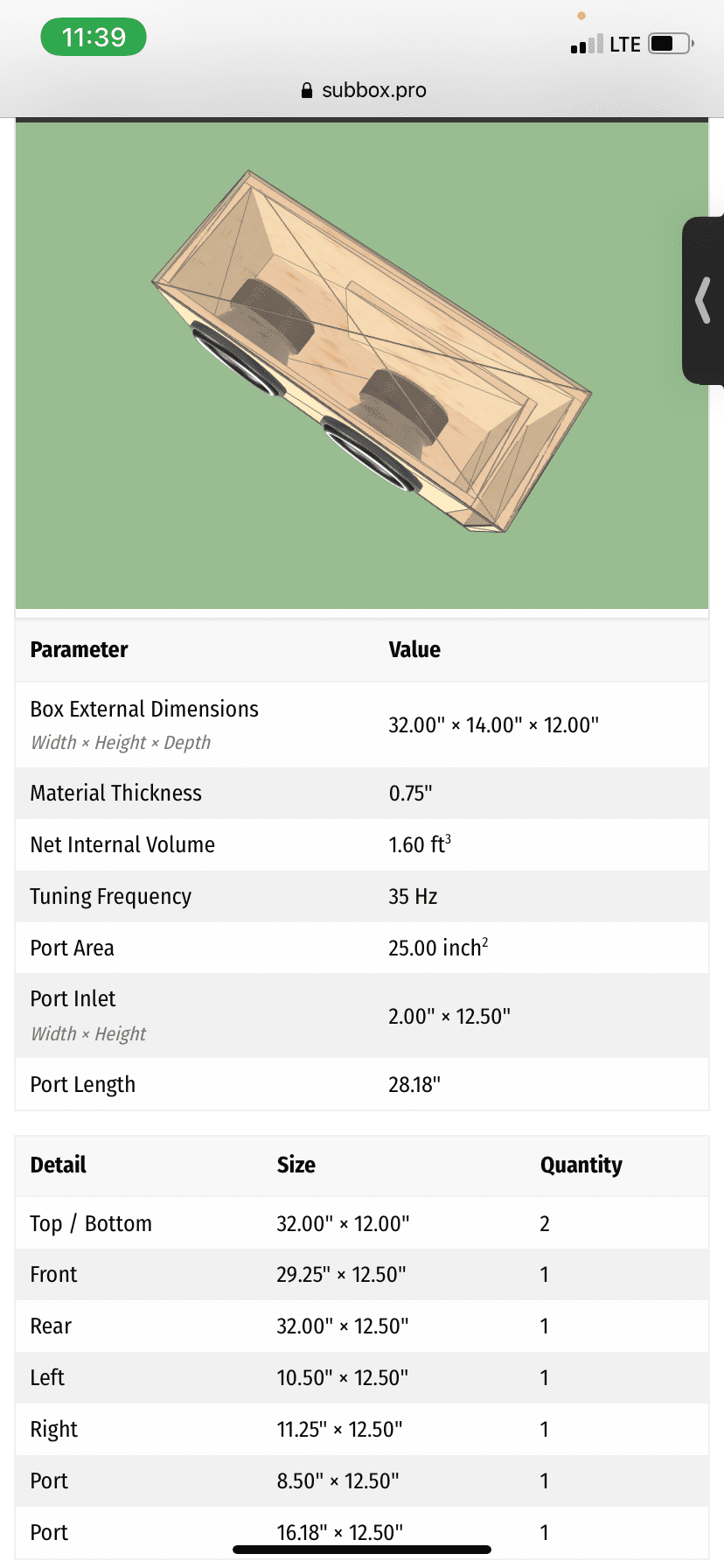

need help building box, Pops just bought 2 sundown sa classic 10’s and a sfb 1500, hes trying to make it kind of stealth so his max dimensions are 32W x 14H x 12D, i was hoping to build a ported but if it has to be sealed than it is what it is
need help building box dimensions, Pops just bought 2 sundown sa classic 10’s and a sfb 1500, hes trying to make it kind of stealth so his max dimensions are 32W x 14H x 12D, i was hoping to build a ported but if it has to be sealed than it is what it is
this box is around 2.4 cu after all displacements which seems good seeing that sundown recommends 1 - 1.25 cu but i dont know about the port area or net internal volume
That box is 2.31 cubes internally if you are using ¾" material. After sub and port displacement it might be pretty tight for a pair of 10's. You will probably be around 2.1 cubes after sub displacement. Then, you still have to subtract the port.
so would you just recommend to do sealed box?
