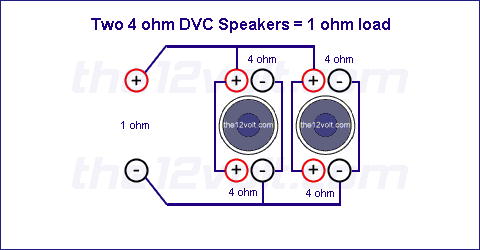

anyways attached is how i plan to wire this thing, hopefully the diagram is right even if none of my choices or equipment were right.

Type Rs used to be one of the most popular subwoofers on this forum years ago.
The amp will work fine but the subwoofers will be extremely underpowered. I have had many amps from FSD/AL. They are decent.

The subwoofers are rated 750 watts rms EACH. That amp does 700 watts rms on a test bench. If you have the electrical upgrades to support a larger amp I personally would look into a 2000-3000 watt rms amp.

Since they are D4s you would only have the option of wiring one to 2 ohms which would see like 350 watts. Would be better off with the two at 1 ohm and have two subwoofers on "350 watts" each.
