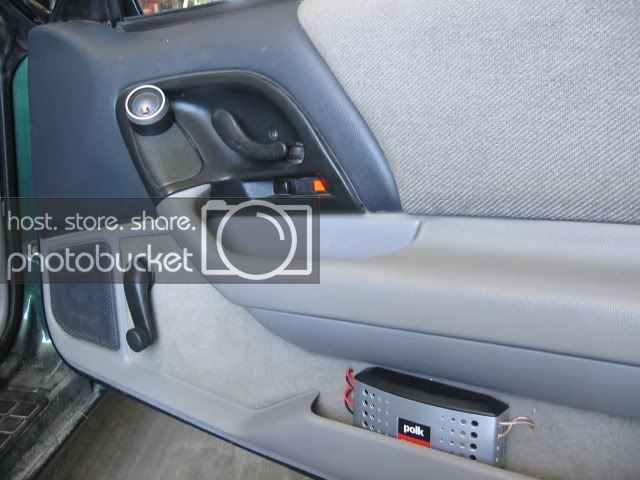

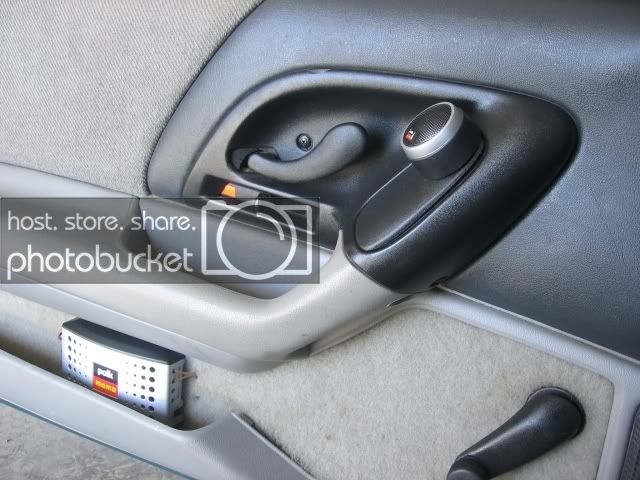

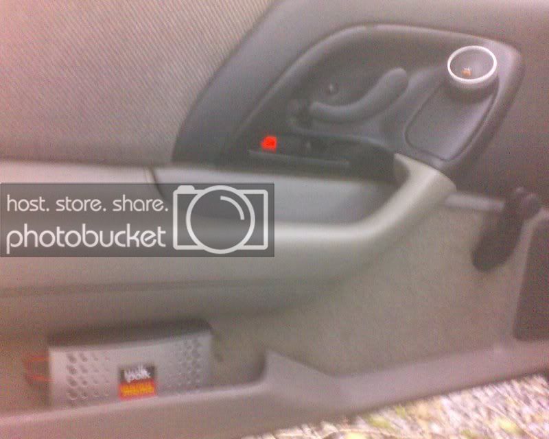

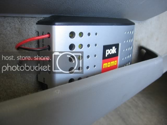

Got one door on my comp set installed, what do you guys think of install, crossover and tweeter placement? comments.....first time doin this. btw, all we had was a camera phone at the time so the pics **** ***.
i think that looks pretty sharp! nice and clean, minimal wire visibility. that is the next best thing to a stealth or fiberglass job. looks great.

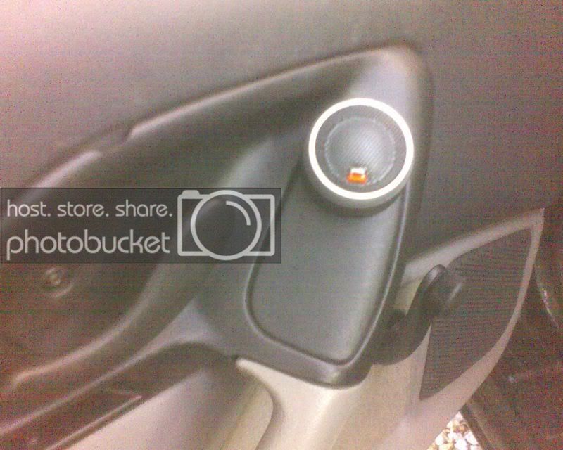

how do the tweets sound in that position, looks pretty unorthodox.

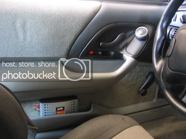

Actually we just got the other door done. Took about half the time or less. Ran into few or little problems, had more problems getting the **** door on right haha. But anyways, i dont get my kicker amp till tomorrow so we really can't test it yet. Hopefully it wasn't a mistake to mount the tweeter before listening to it. But when you sit in the car both tweeters are pointing basically right into my head. So i don't think i will be dissapointed....

Looks decent , but I bet your gonna run into some problems image wise with the tweeters aimed directly on axis like that . Gonna need some serious eq //content.invisioncic.com/y282845/emoticons/smile.gif.1ebc41e1811405b213edfc4622c41e27.gif
Aimed directly on axis....what do you mean and what problems will i run into?
He means on axis with your ears. Basically pointing right at you. That might make the tweeters appear a bit to harsh, but I think you should be able to attenuate them with the xovers if that is an issue. Your install looks dang nice, btw!
On axis means it's pointed directly at you . With the drivers side that close , and aimed right at you . Even with attentuaion it's gonna need some eq to tame it //content.invisioncic.com/y282845/emoticons/smile.gif.1ebc41e1811405b213edfc4622c41e27.gif
