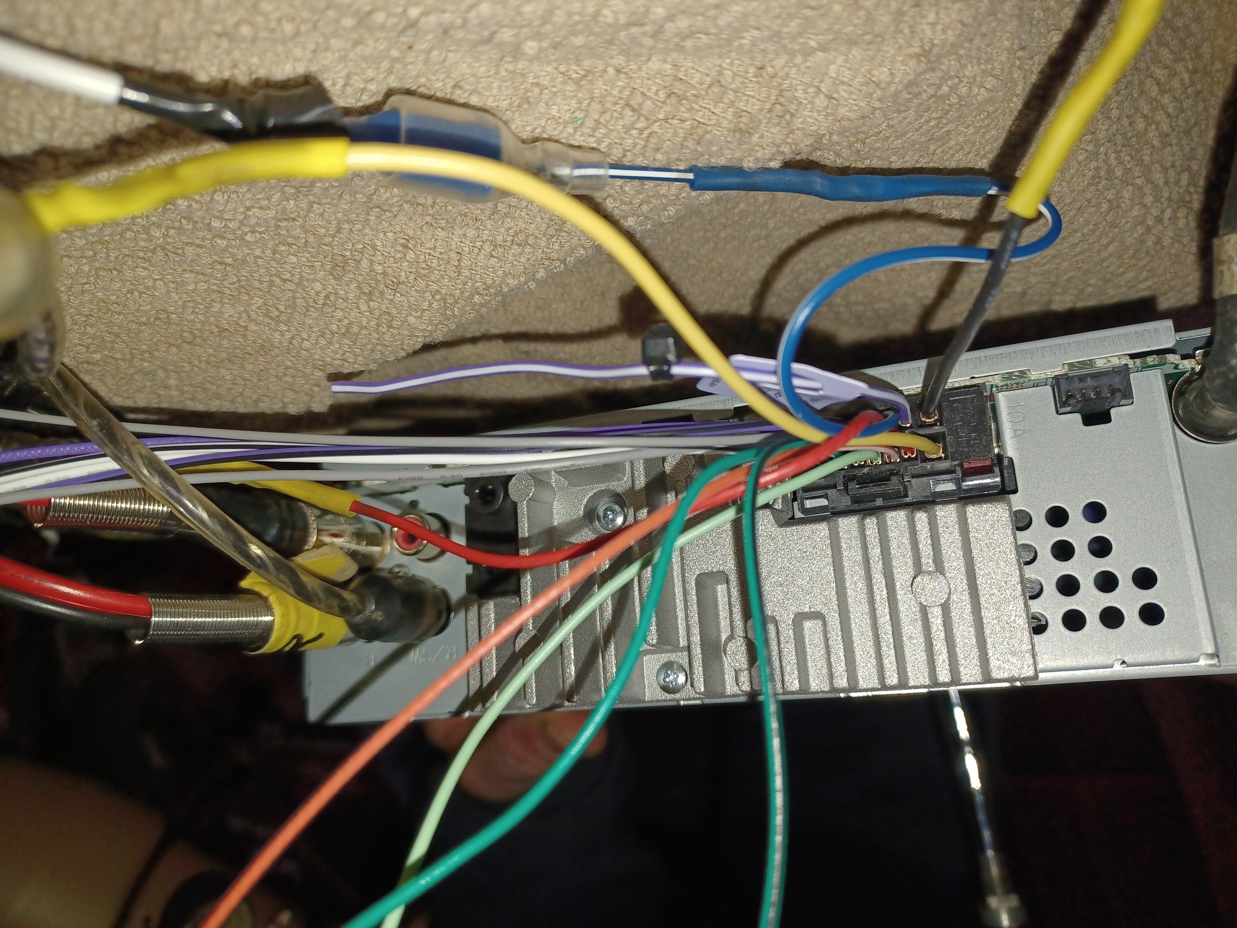

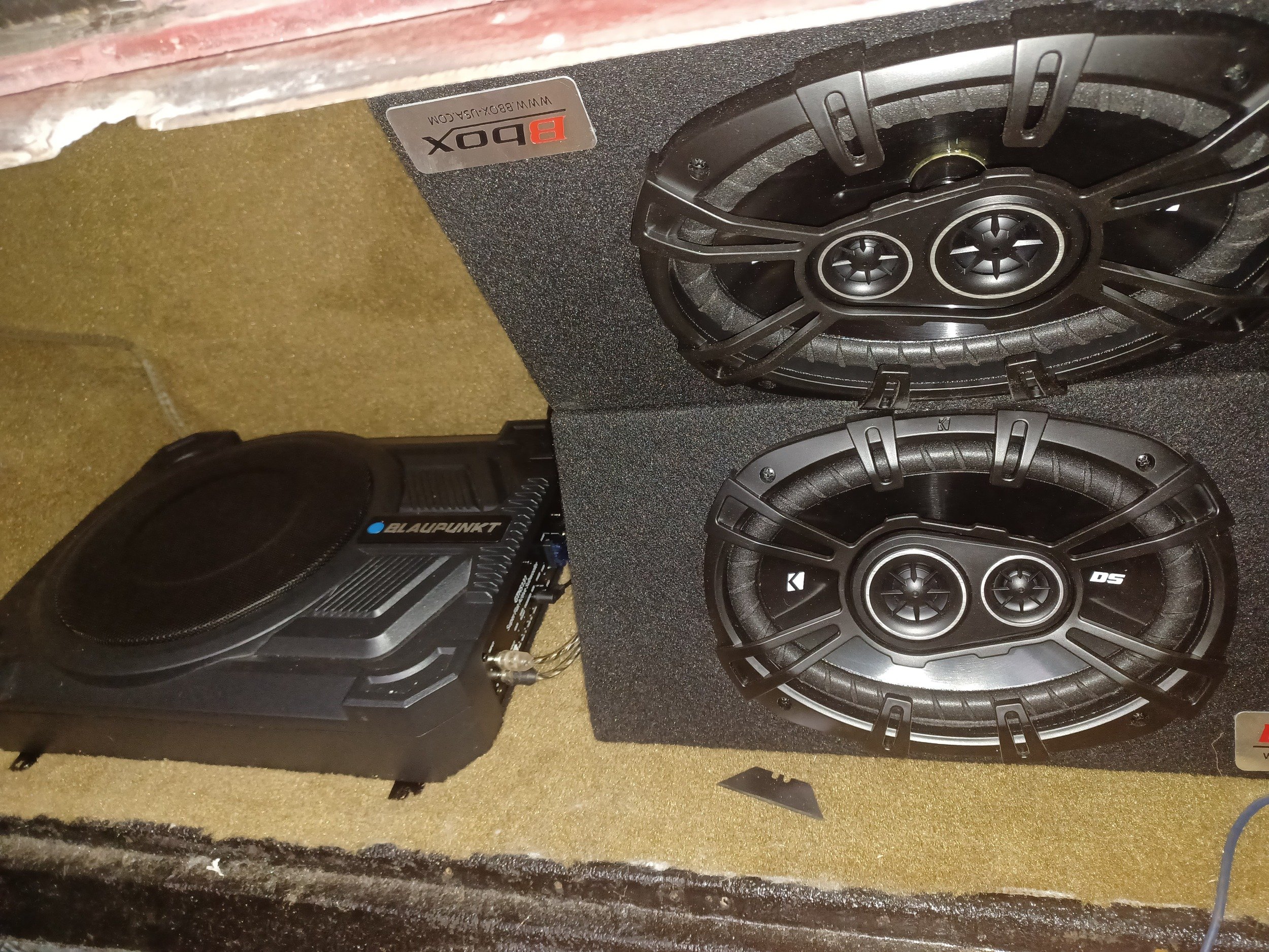

Here is the back of it, so I have 2 6×9 speakers and an amplified sub.. I did have the rca Jack's connected to the speakers and it was working, when I shut the system off and went to use a few days later I got nothing.. was that just out of pot luck? Or I do need to use the wires from the radio instead of using jacks?
Use the RCA's to send input to the amplified sub. Then use the speaker wiring on the head unit wiring harness and connect it to the aftermarket wiring harness usually matching color for color. Your 6x9's should then get sound. Otherwise you will need to run speaker wires from the head unit to each individual 6x9 but they will only be running on head unit power.
I am going to try that, the only problem is I unplugged the rca to the 6×9s and just used the rca for the amplified sub, and set the stereo to full and sub, but barley got sound out of amplified sub, going to give it another quick try now.

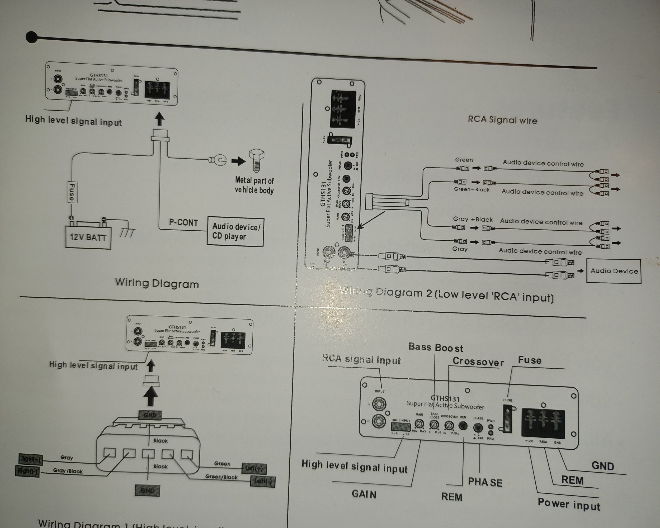

I tried it, no go... I have no idea how I had them working before... the amplified sub barley has sound.View attachment 48659can I use the rca connectors on amplified sub an
d just wire the other end into the wires on the radio instead of rca outputs? Or would I need to wire it as shown in the picture bottom left using the high level imput?
