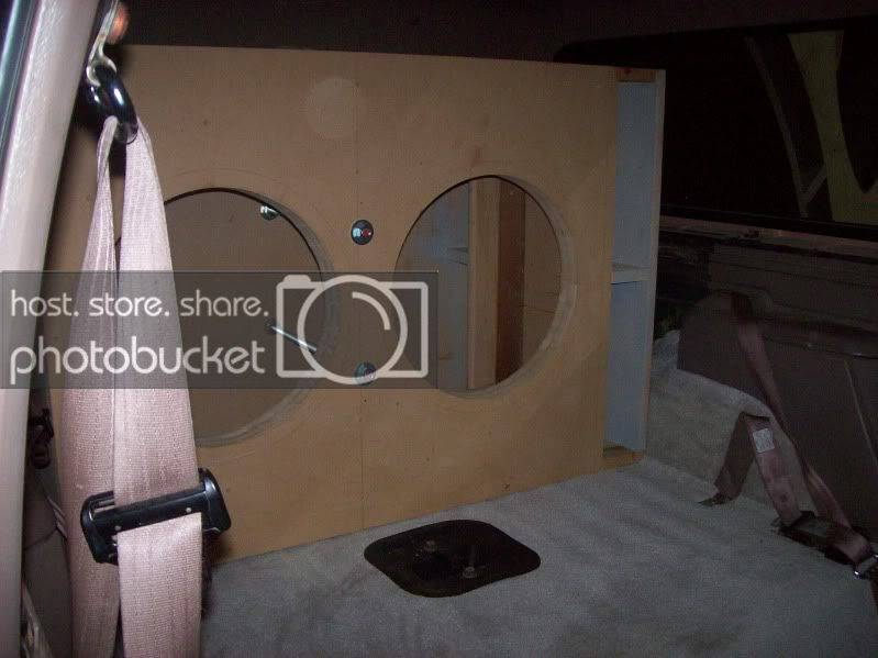

this is where im at , looking for input on sealing
for my walls ive put 2x4s around all three edges leaving .75 inch from the 2x4 to the front baffle edge and then i cut out peices to fit the weird shapes around the box. but also put 2x4s bracing from the 2x4s that are laying on the box like i mentioned to the ceiling and side walls... i doubt you can understand what i just wrote ha
i was actually thinking the same thing using 2x4 on the sides and top to mount the three trims , i am going to put a .75 flush plate on the baffle then .75 trim the on sides , i was thinking of using like some weather striping to seal the trims tho , jus kina worried about sealing the side windows , maybe tape on the back side of the trim edge ?
i just expanding foamed the shit out of mine. i didnt do it around the window tho.. because ill be changing my wall yet again in the near future so for now its not completeley sealed but it lets barely any air back
couldnt you just use like rubber weather strip on the window edge and tape the back to seal
Virtually the same thing I have done and will be doing.
I use 2x4's and mount them to the box to take up as much space as possible. Then lay some masking tape around the edges to be foamed and foam it all in where there are gaps and either make beauty panels or a flush cover at of fiberglass to the sides.
that would prob work fine im just too lazy and i know it wontmake any audible difference. but yea i would say do that. i dont want to tape over my tint in the rear windows or use any adhesive on them for that matter becuase i dont want to rip ot off
This
Buy yourself some garbage bags and fill 'em full of foam, should seal it off pretty well and when you decide to tear it down - you wont have foam all over everything you can just rip the garbage bags out without getting overly messy and having to replace shit.
ya i hear ya , my windows are factory tint so no film on them . . thanx bro'z
This
ok someone else suggested this also , i think i understand what they meant now.
