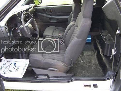

thinking about doing a small sub system in the 3rd door of my extended cab s10. mother in law borrowed my camera, so this is the only pic i have.
there is a storage compartment in that rear door. my thought is: remove the storage compartment, and fiberglass an enclosure in it's place. either a single sealed 8, or a ported 6.5 (before any of you comment on the 6.5. there are 6.5 inch subs that play low enough for a sub system). i can get approx. (.5) cubes, give or take a little, and not get much larger than the compartment currently is. of course, sound deadening the sh!t out of that door will be done. the sub is where i could use a little advice. i really like the tang band 6.5 inch sub, but 50 watts rms is a little small. if i go with an 8, i'll use a dayton.

alot of work for some small subs. I have seen enclosures that replace the rear fold down seat that would allow you to run a 10 or 12 instead. Why not just put a regular box behind the seats? Do you actually use the rear space for anything?
already done a 15, (2) 12's, a single 12, a 10, and (2) 8's. getting bored a little. and i want the jumper seat. my wife, daughter, and myself ride in it, and it's getting hard to have all 3 of us in the front.
