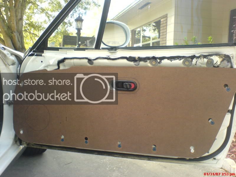

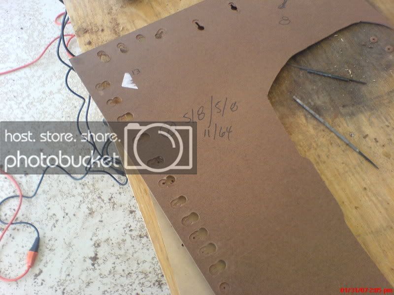

Today was "key-hole and test fit" day...heres the pics...

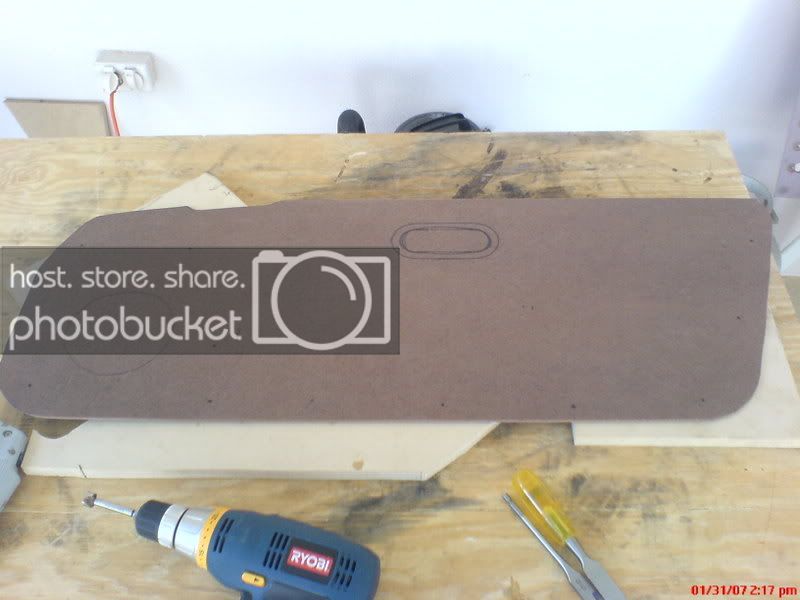

My 2 dozen attempts to see what steps worked best...

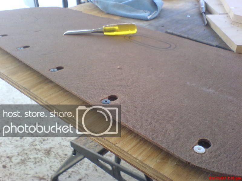

Door panel all cut out...

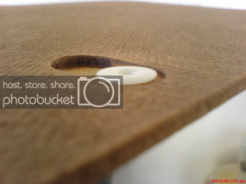

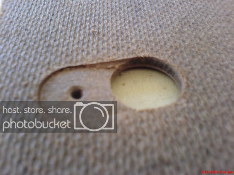

5/8" Foster bit counter-bore shot...

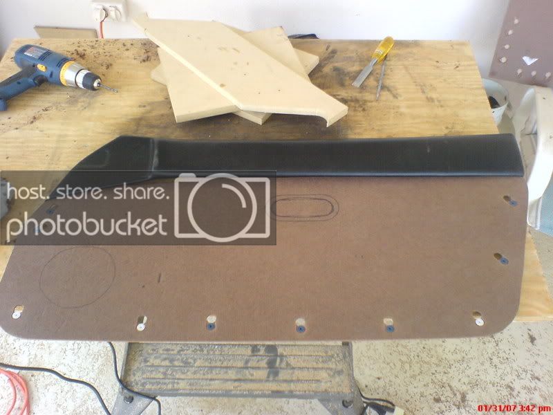

All my ducks in a row...

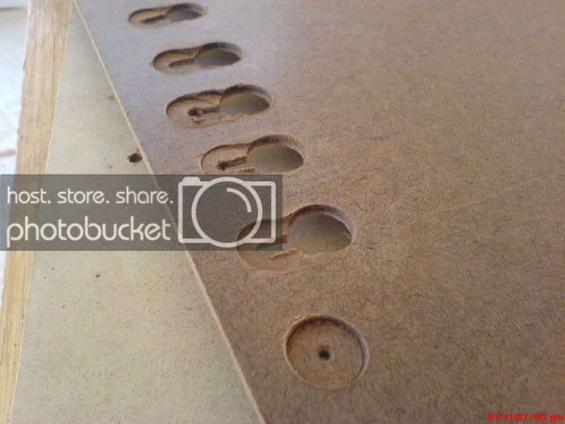

5/8" Hole-saw for the cut-through and then a wood chisel to clean up the sides...

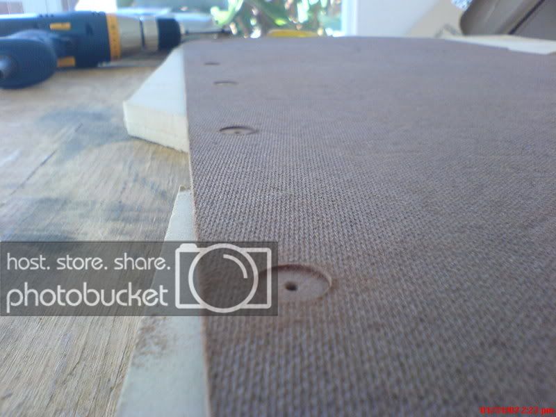

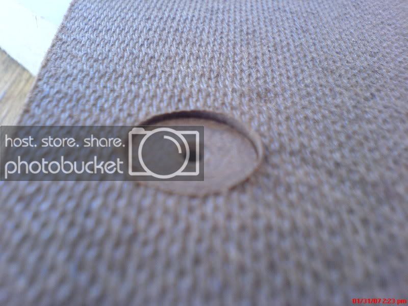

After boring out the middle, you get this...
'Nother close up...
Overall shot...

Mock-up with top piece...
Got the handle cut-out and went for a test fit...
It didnt sit flush here 'cause I still havnt cut out the speaker...
