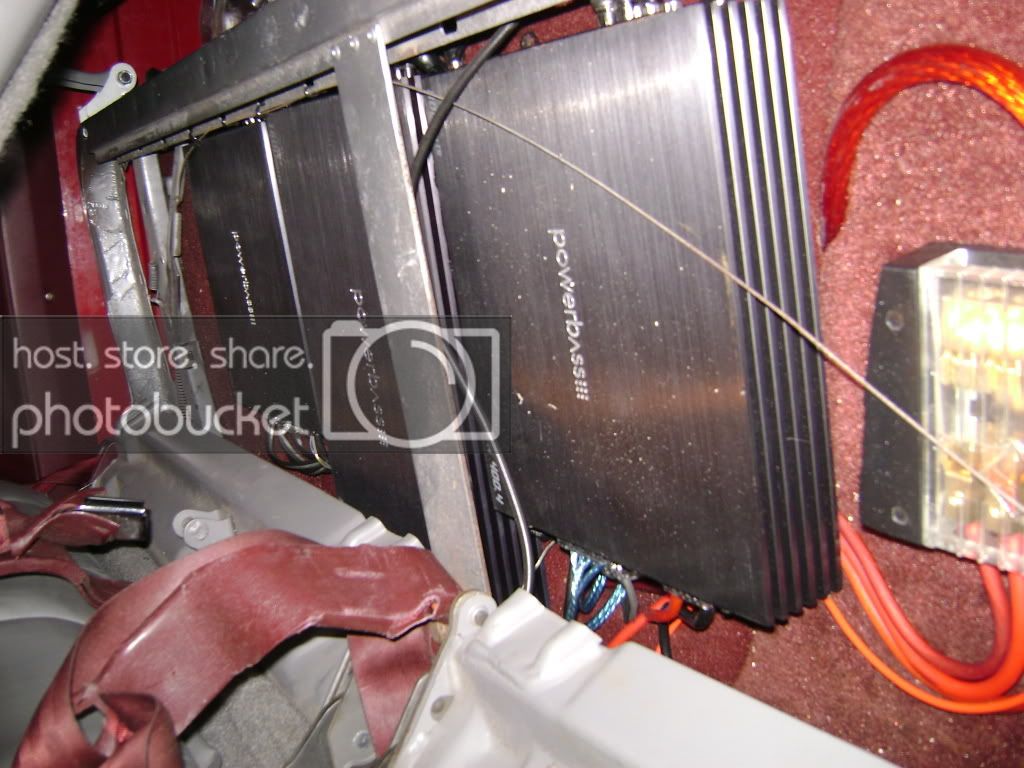

(3) 4 channel amps installed under the seat
front and center dash spks hooked up
rf 360.2 wired up

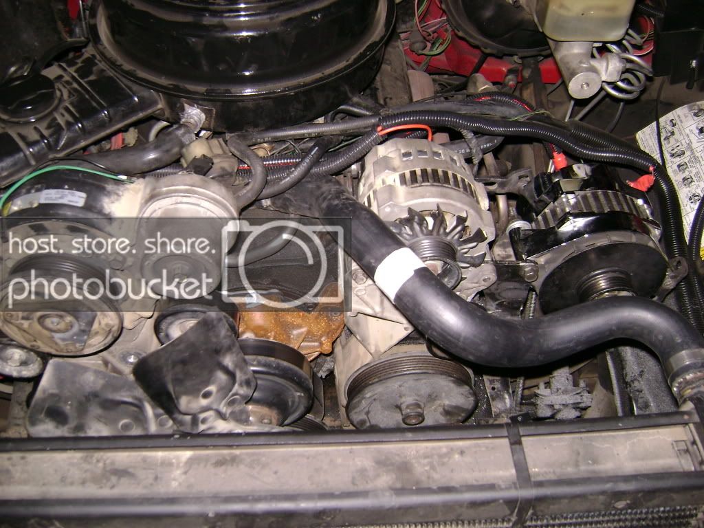

serpentine belt conversion complete
second alt brackets fabricated and instaled
iraggi 300 amp alt installed-(just waiting on a belt)(working on trip#3 to the parts store in the morning to get the right length)
