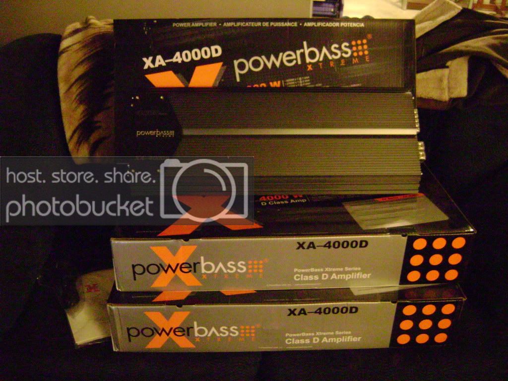

4 powerbass 4K amps for a total of 12K for power

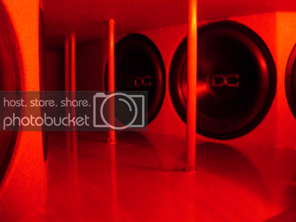

6 DC Audio LV4XL15's
Lots of wire, steel and wood =]

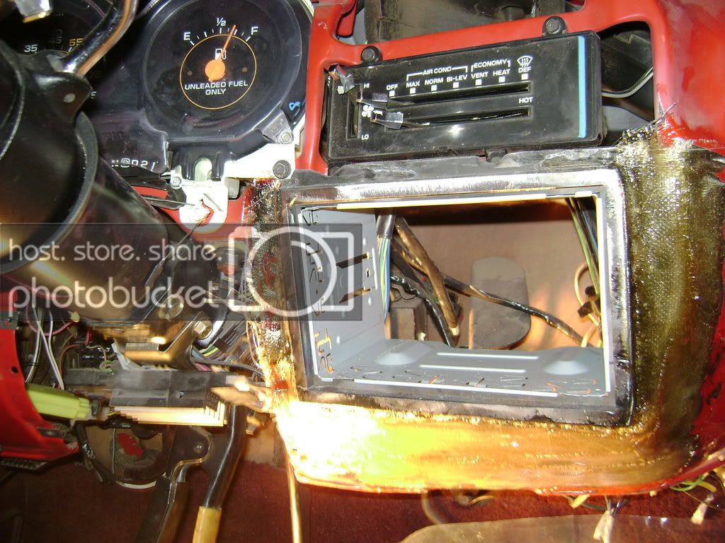

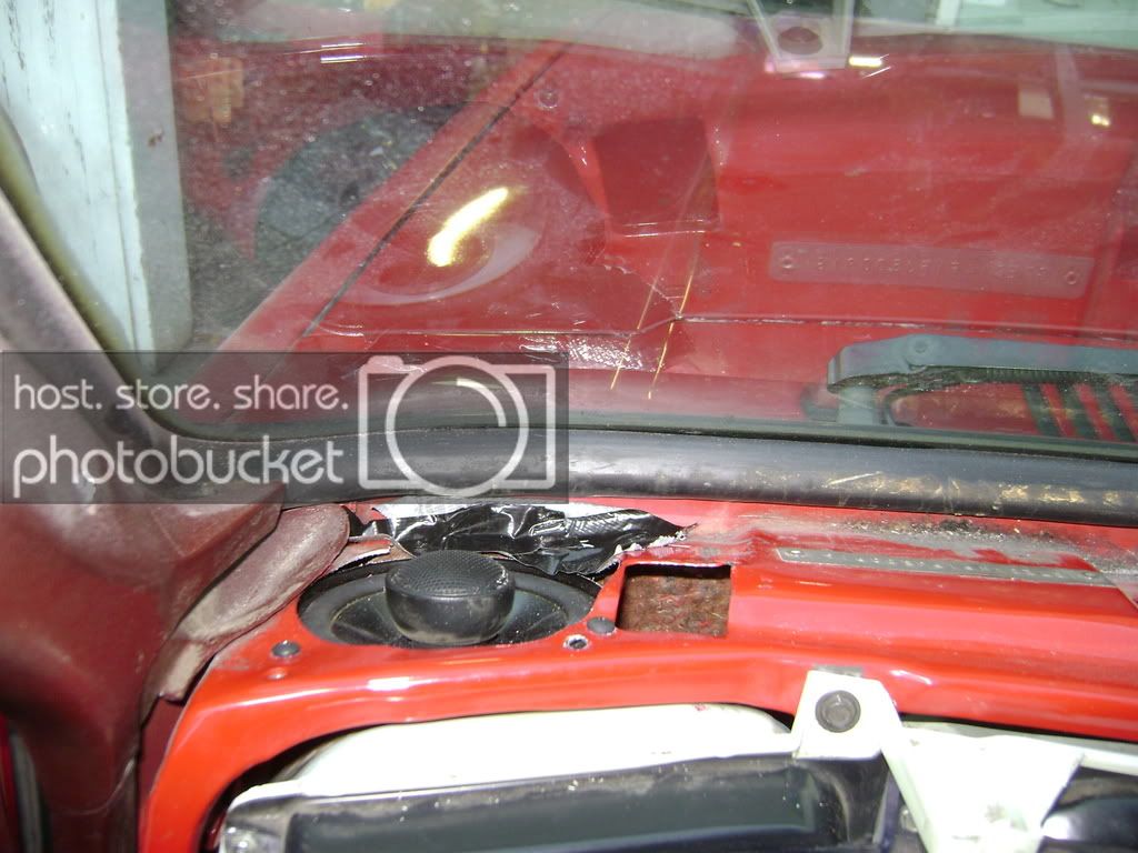

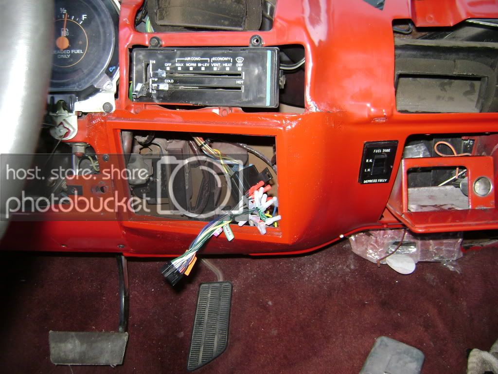

mid way through the future location of a ddin. fabbed a trim out of 3/8 square stock and backed it with some 12g sheet metal. then welded onto the dash, cut out old material and start layers of glass.
finish work not done(spot filler and fine sanding) but i am done for now with that part untill after finals when i gut the whole truck

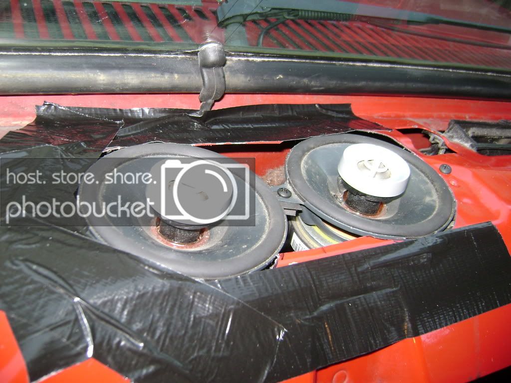

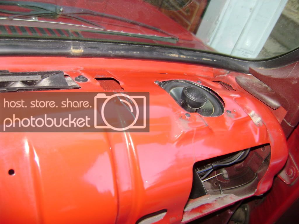

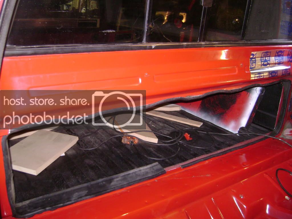

4 inch speaks wher the 3 inchers used to be
thes will be used as a center channel...ignore the duct tape...there is no tape there...it is in your imagination. just trying to not have back wave transfer

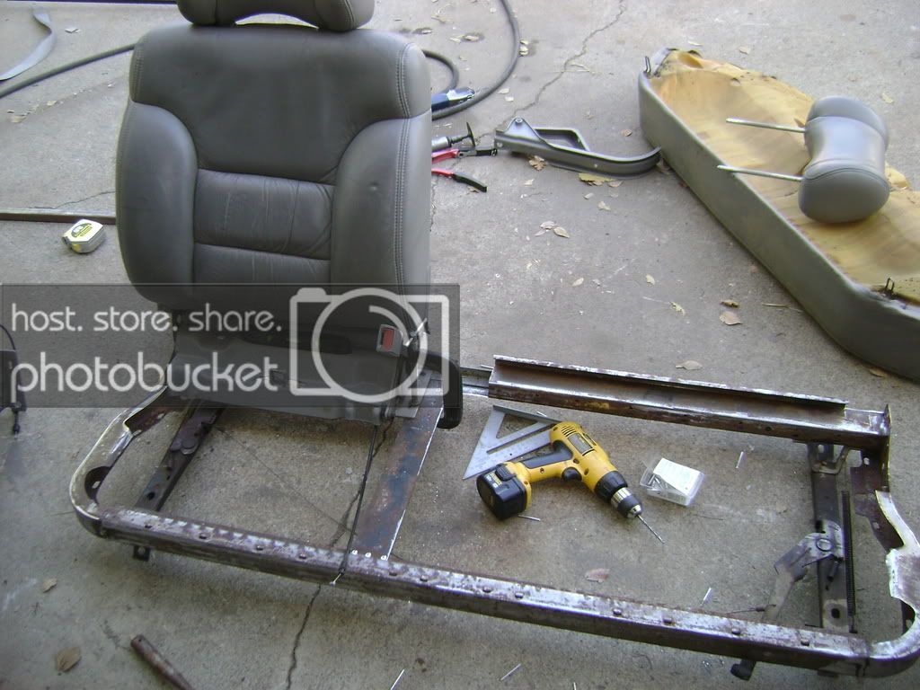

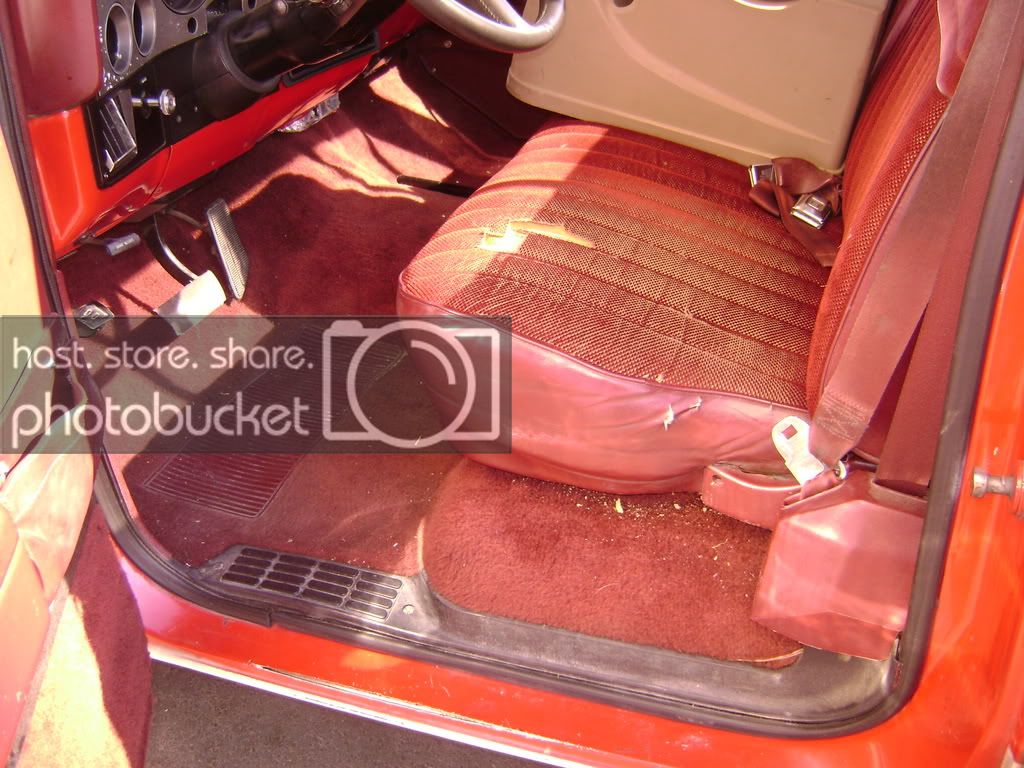

old seat

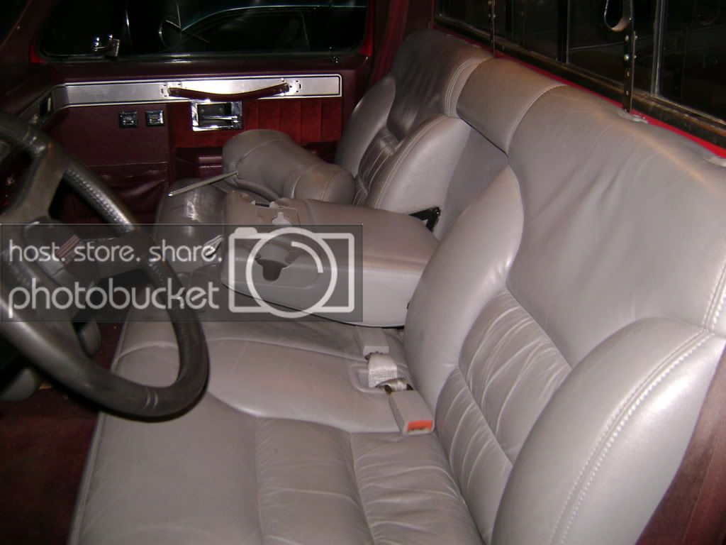

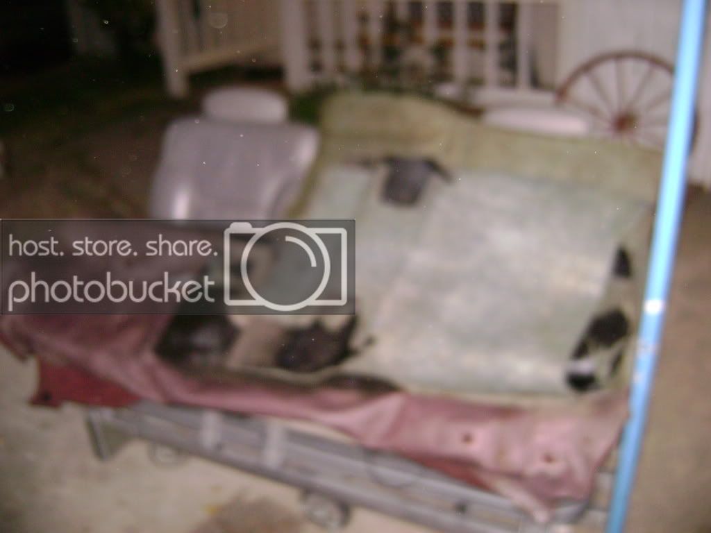

re- working the old frame to accomodate newer seat (2nd row from 97 yukon)
test fitment before mounting bottom cusions, i want to retain the way the seat works in the suv.
seat is about 2 inches higher than stock and about 2 inches thicker in the back cushion. so the wheel will have to be tilted up so its not in your lap. still has more room than my metro feels like your sitting in a "big rig"

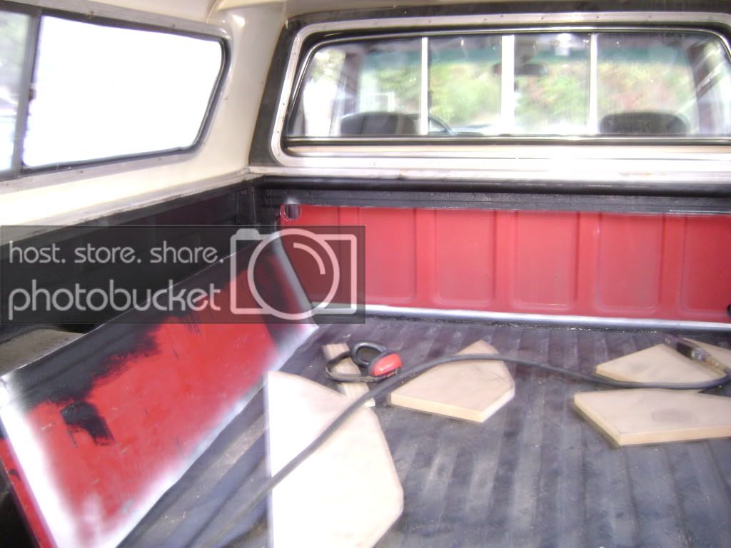

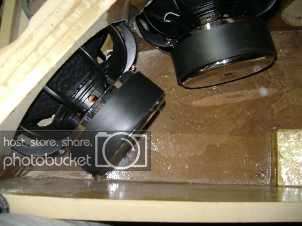

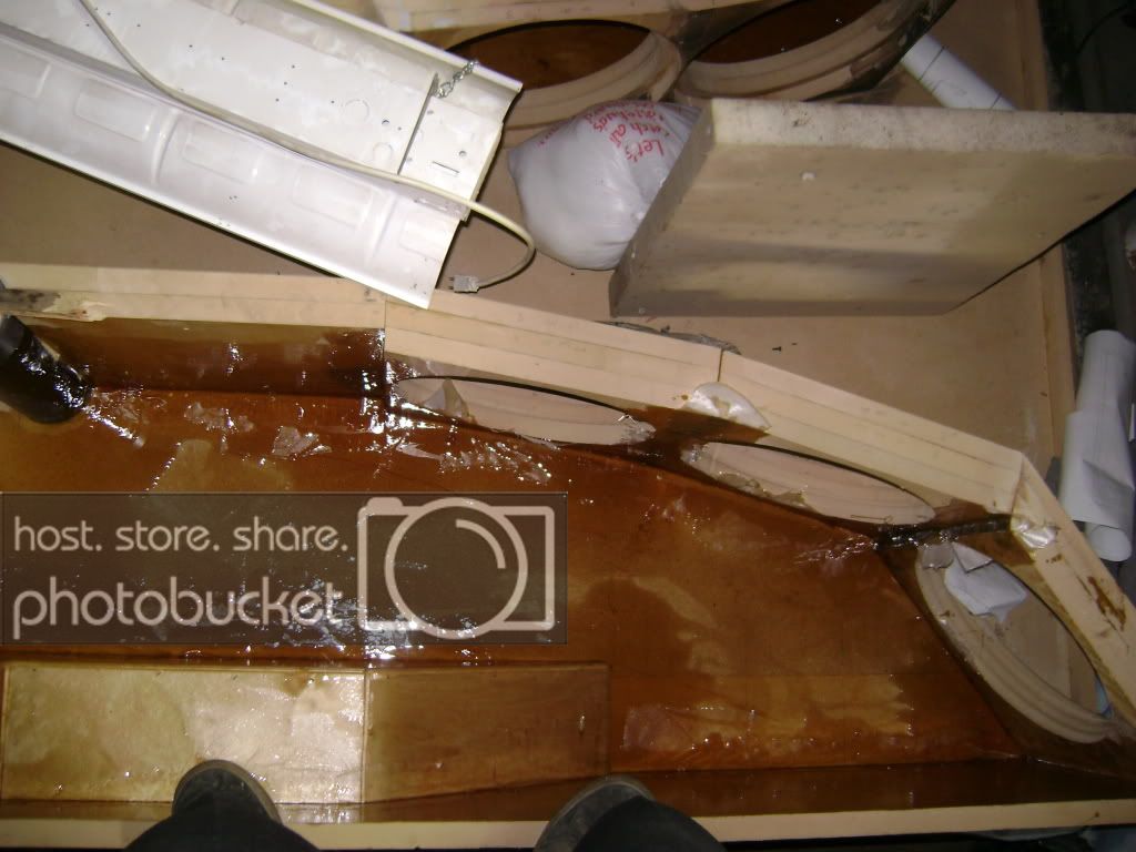

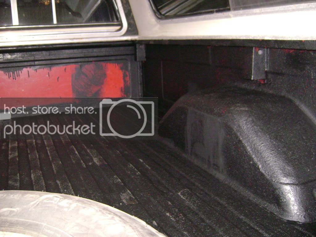

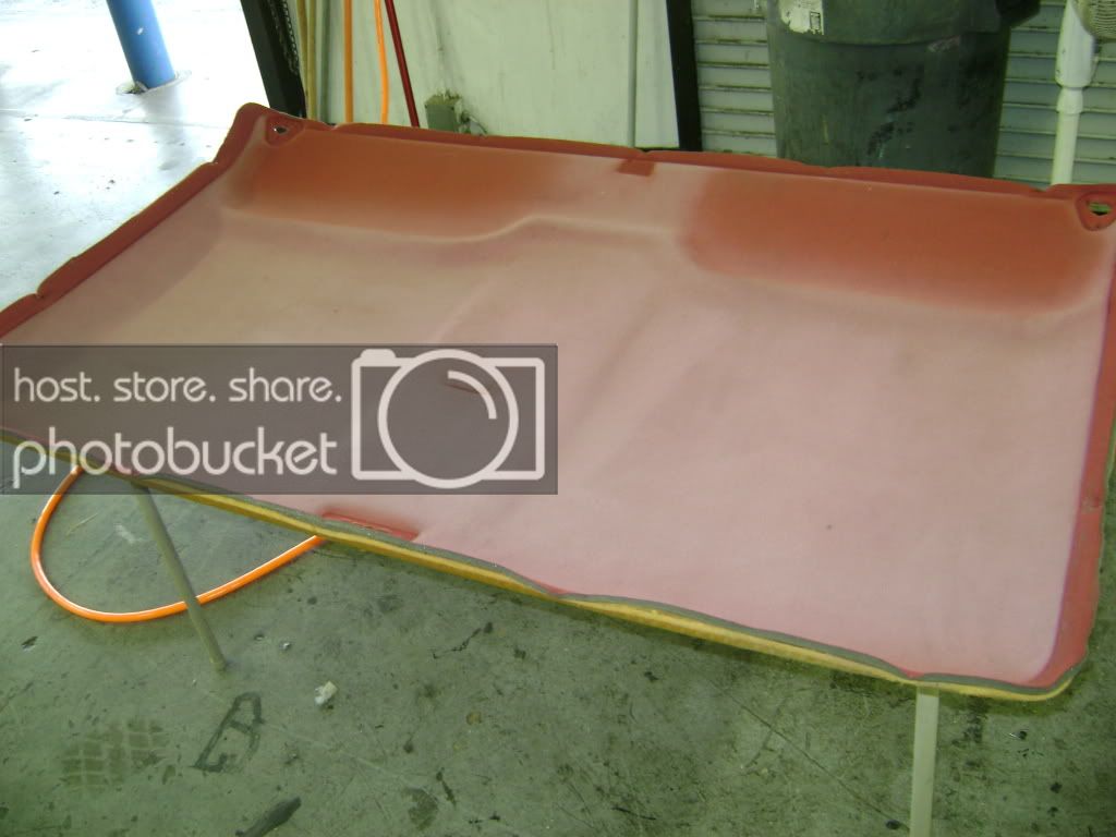

Jack did his own roll in bedliner to try to help with eliminating the natural resonance of the metal when there is 35 cubes of box laying over it

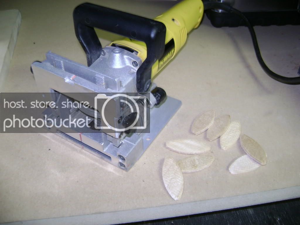

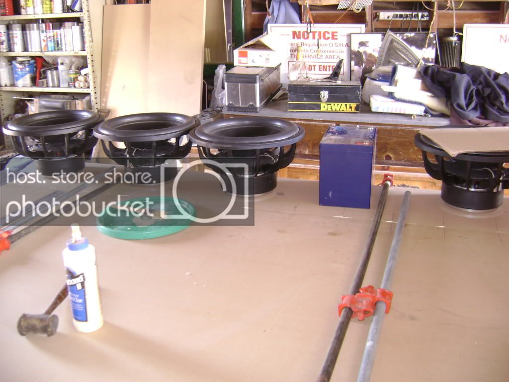

a new toy he picked up to try with this build...

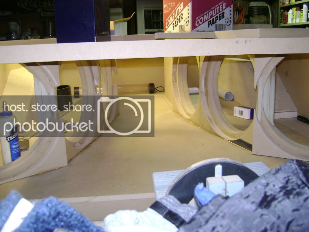

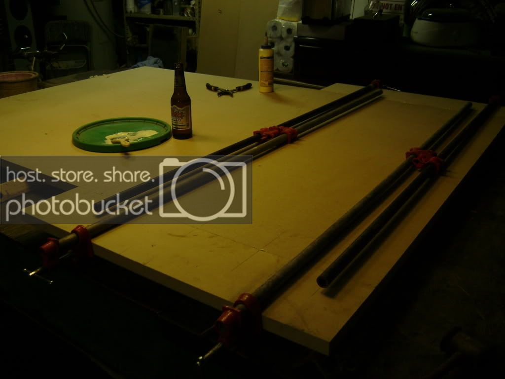

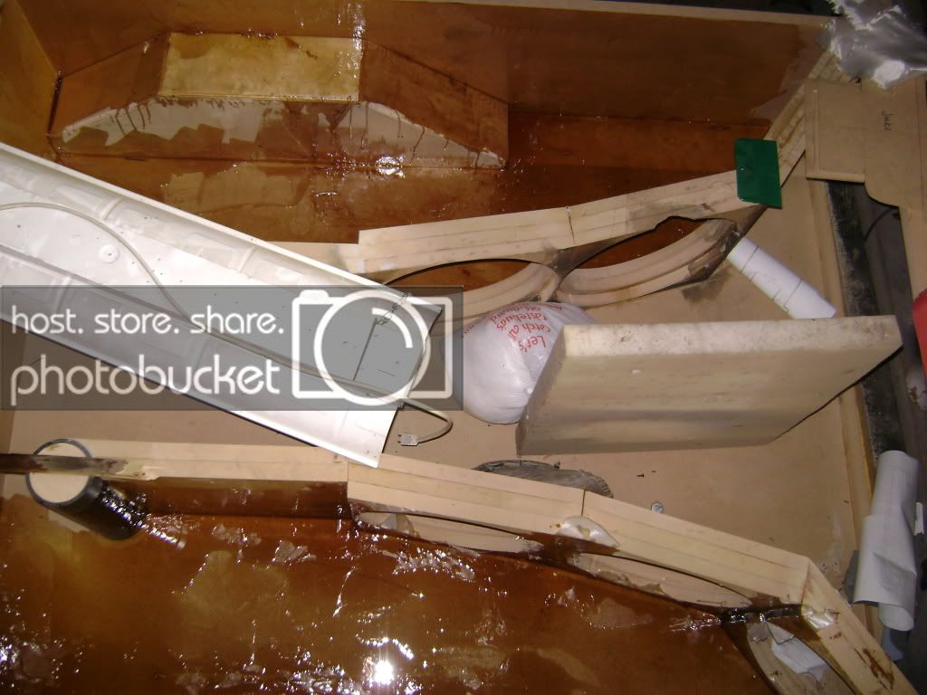

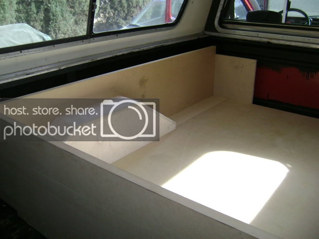

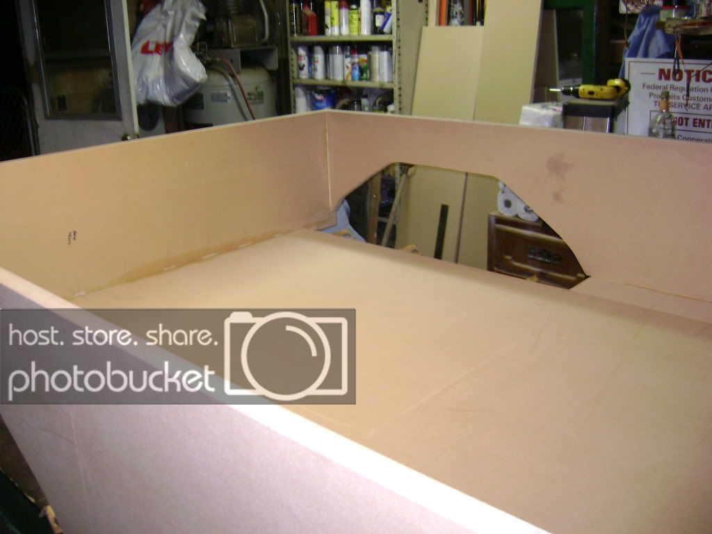

what it will all look like prior to glue and assymbly
second small peice being glued
side peices assybbled and clamped for the nite

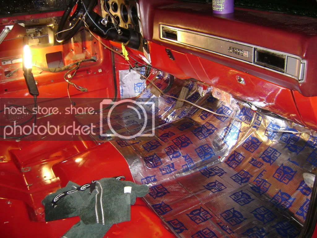

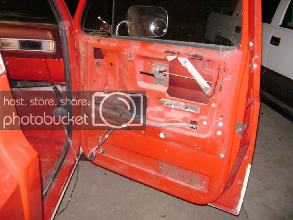

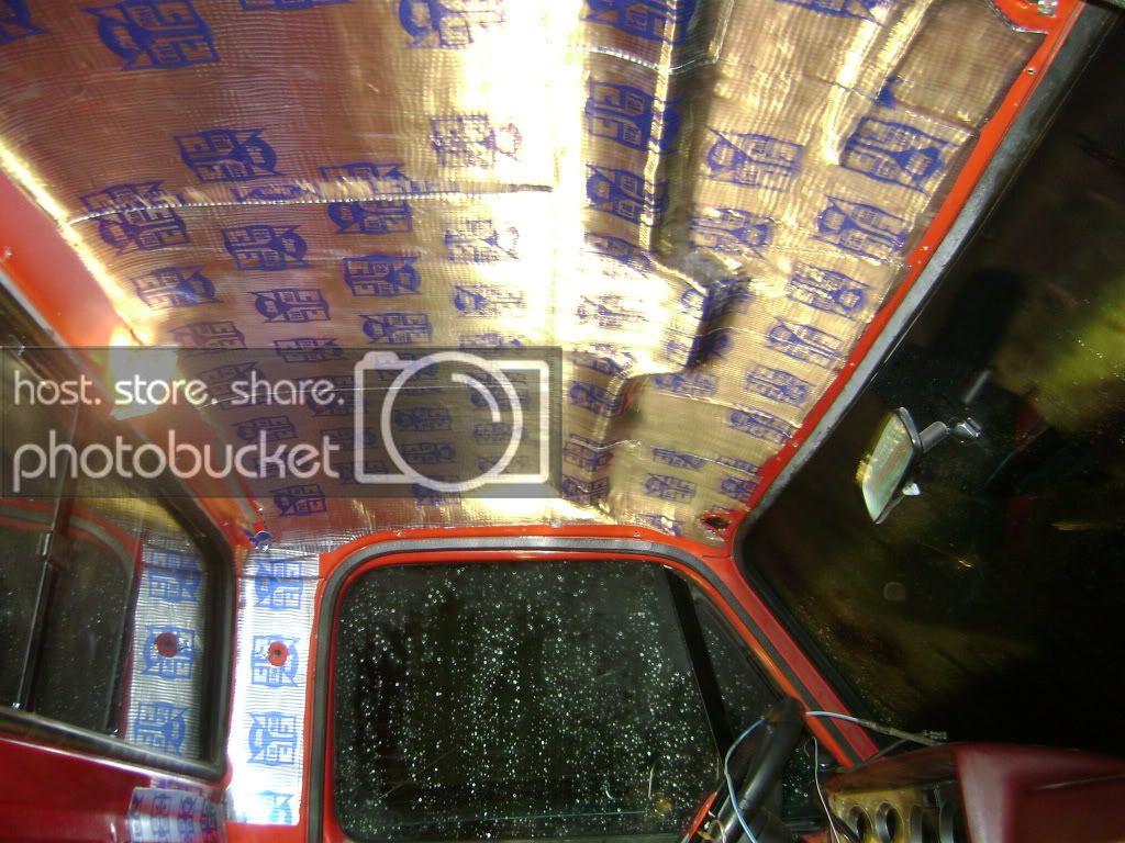

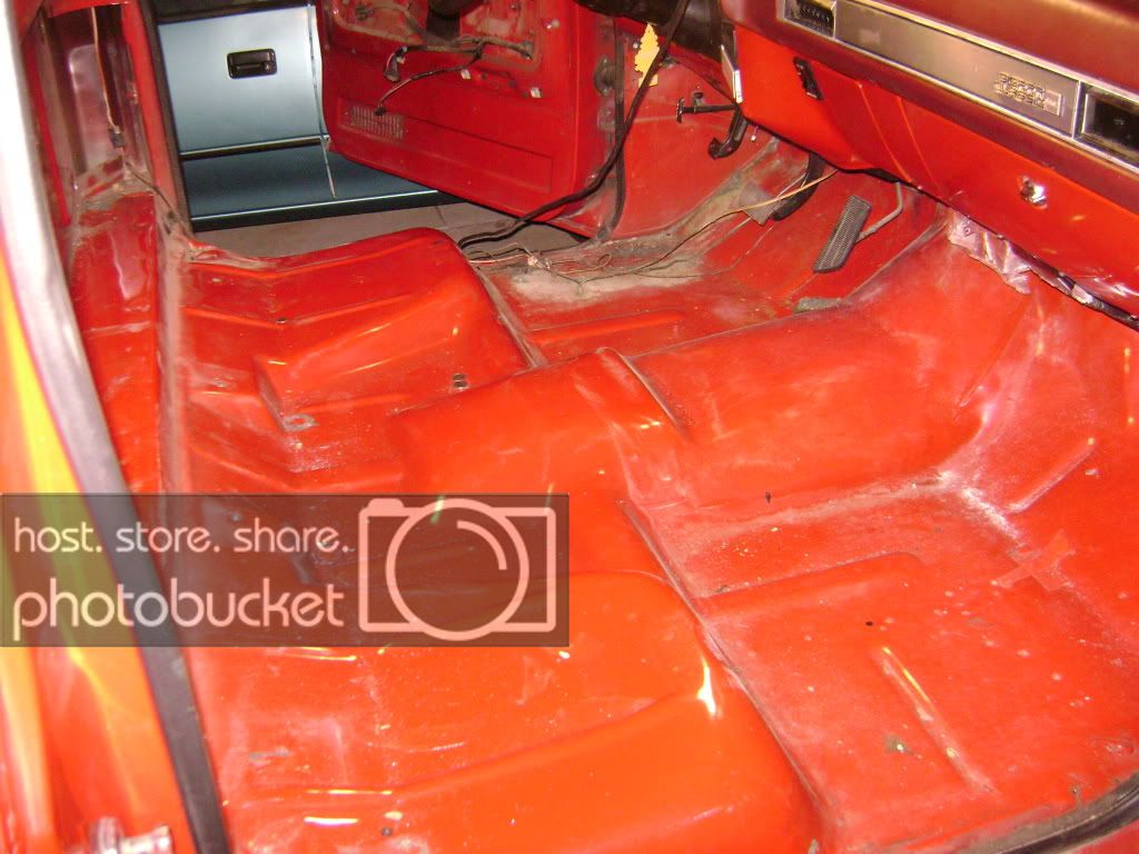

Jack removed all of this stuff...
to expose all off this...

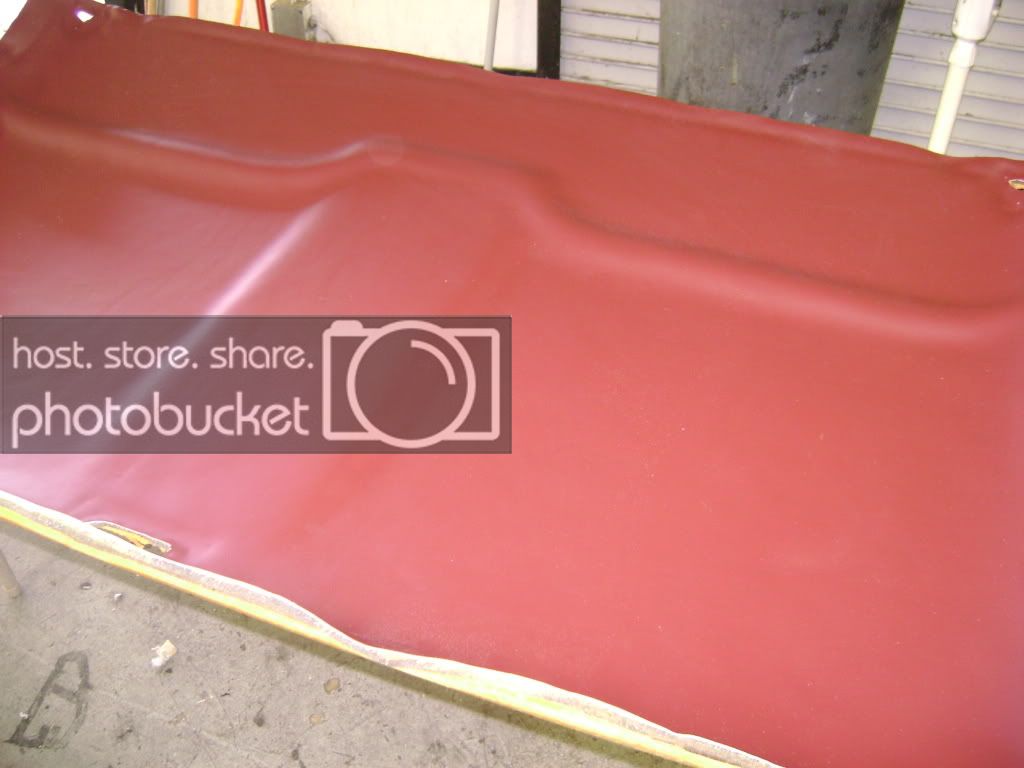

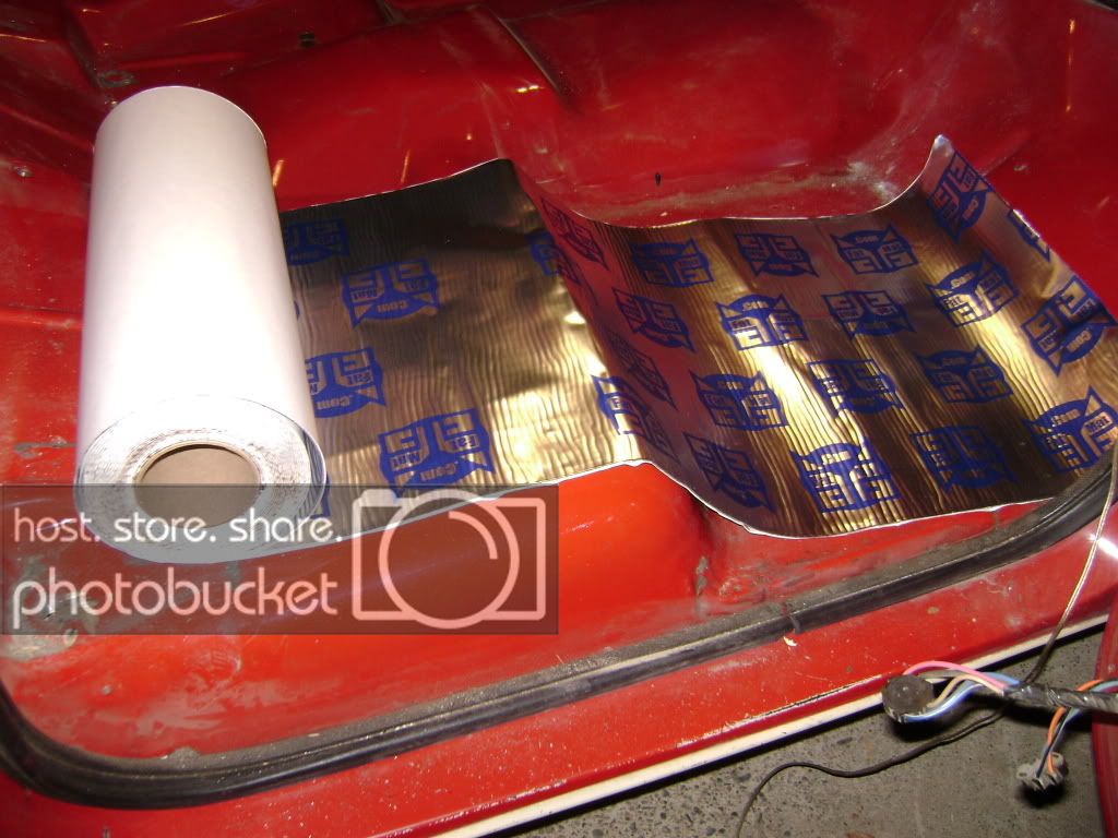

so he can cover it all up with lots of layers of this
he will finish destroying the resale value of the truck tomarrow night and start rolling the deadener on

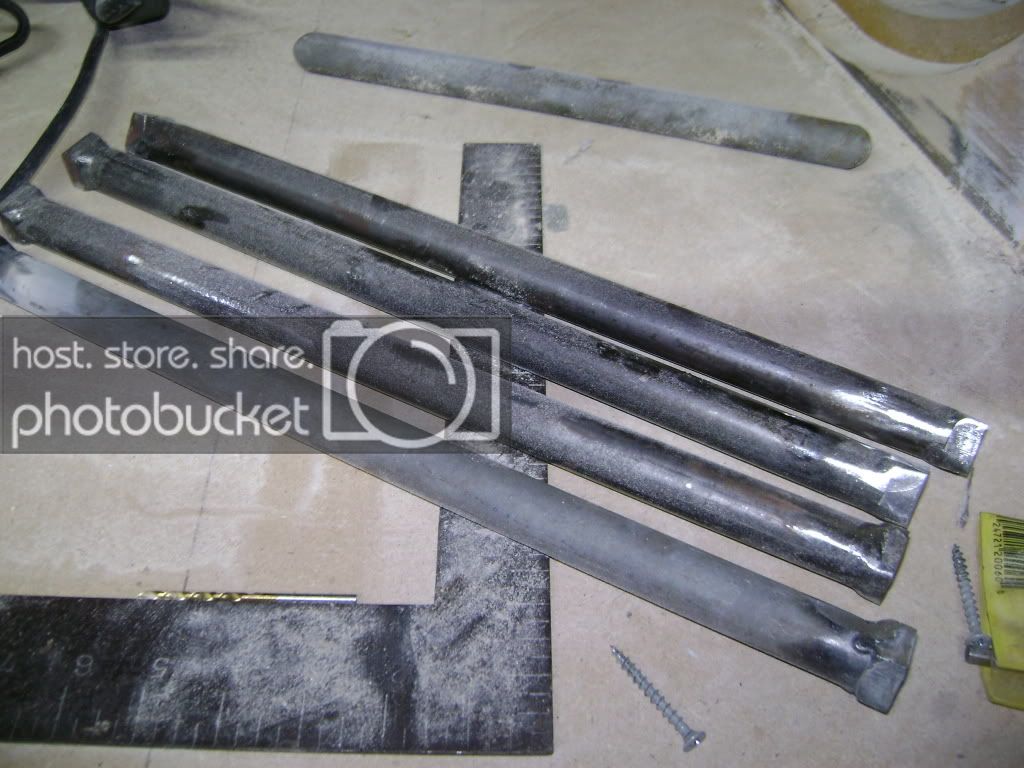

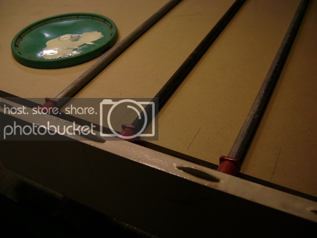

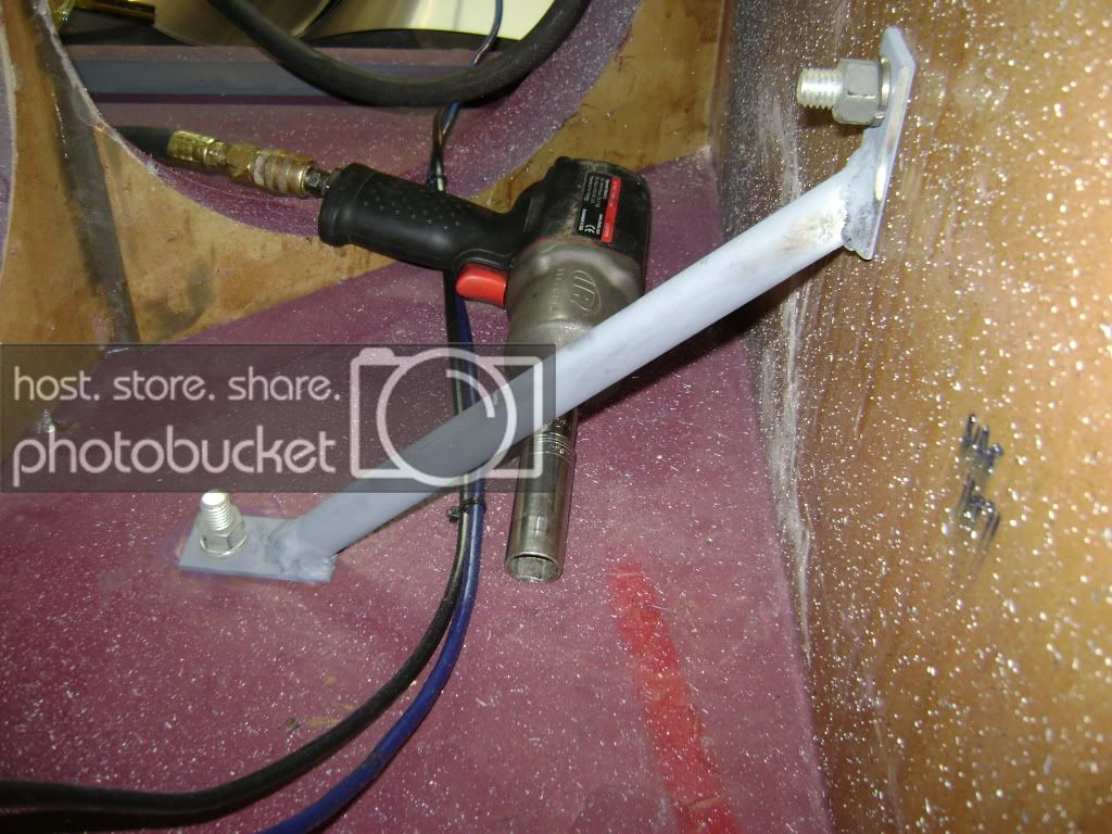

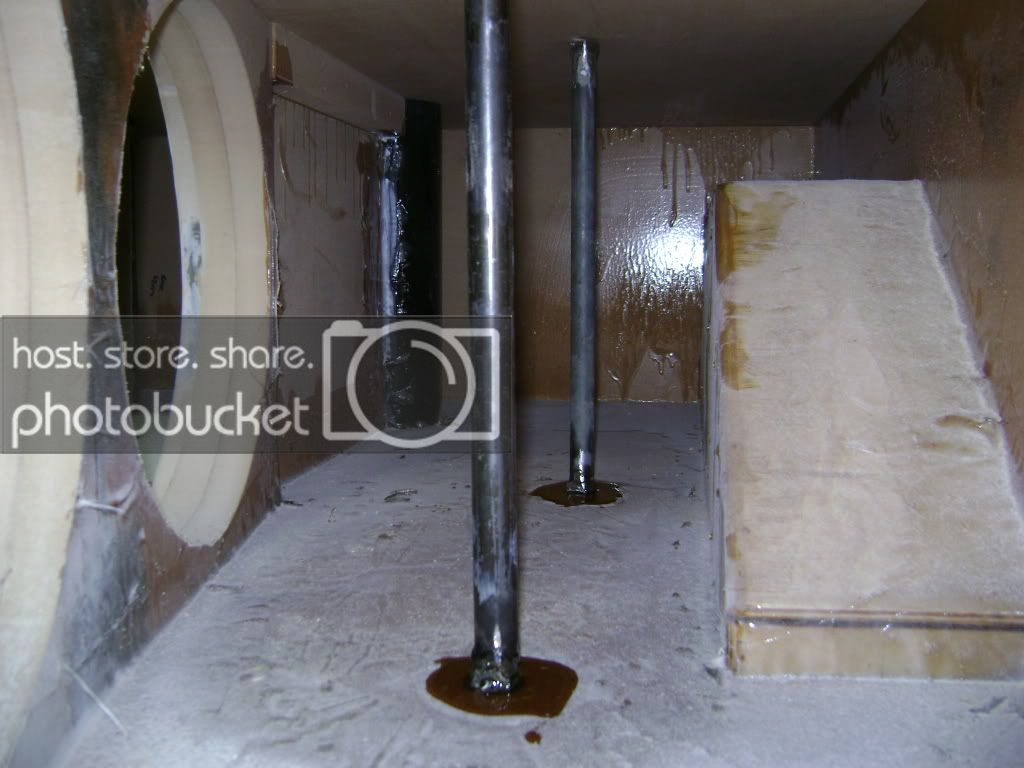

these are some supports jack welded up to use instead of allthread
what they look like in the box

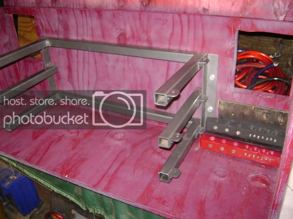

started mocking up the rack for the XA-4000D'S with the distros for amps and batts
paint is temp until he finds what material hes using for the back of the truck
