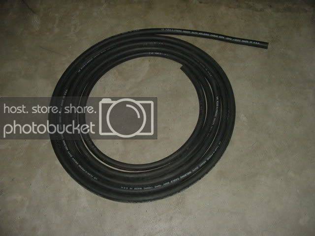

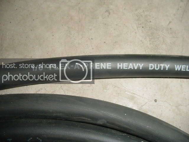

ok i went to the local audio places (fry's, best buy, tweeter, etc) looking for some batterey clamps that can accept the 1/0, but alas no one has any
any one got any links as to where i can get some nice looking ones online
(oh thats about 20ft of 1/0 for about $25)

woohoo it has begun
Hey, whered u get that wire from and is it able to withstand heat under a hood?
For 25 bucks for 20 ft, thats a good deal.
