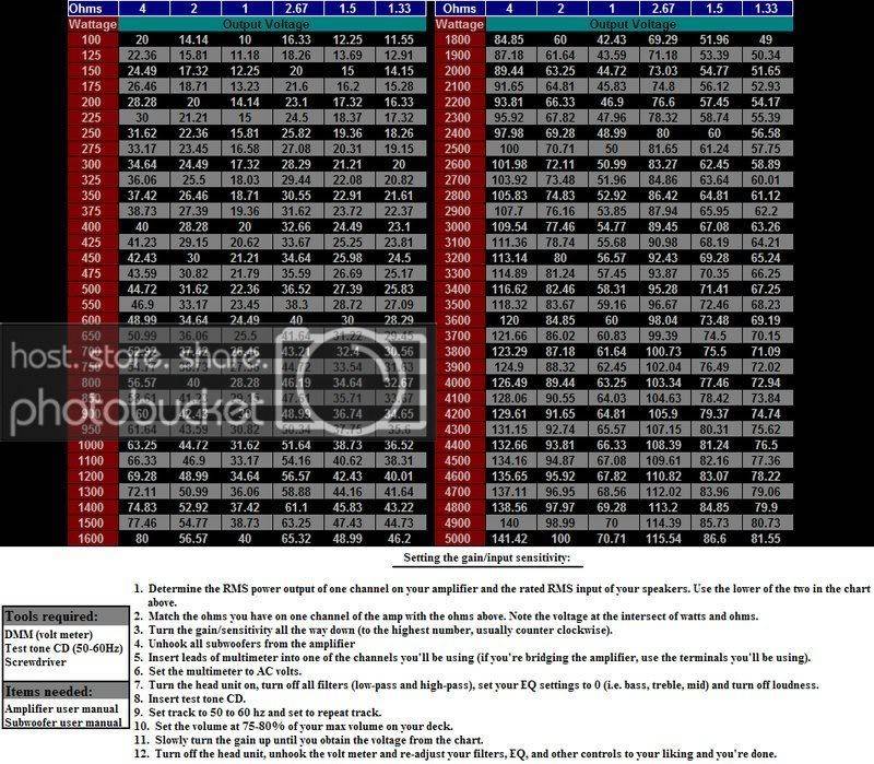

i have never actually used my dmm to set all settings on my amps. i have always been a "by the ear" kind of guy. well my old dmm took a shit on me. so i bought a new one yesterday. can anyone explain to me how to use this formula and what-not.
i'm going to be running the audiopipe ap-3002 i picked up. and i will be running it bridged @ 4 ohms.
Can anyone explain how to use the forumla so i can tune my amp? lol
AP-3002

P = Power in watts
I = Current in amperes
R = Resistance in ohms (effectively the nominal impedance)
V = Potential in volts (Voltage)
Knowns:
Resistance (nominal impedance of your speakers)
Power (desired wattage)
Unknowns:
Voltage (we'll measure this)
Current
Formulas:
P = I*V (formula for power)
V = I*R (Ohm's law)
So after a little substitution to get Voltage in terms of simply power and resistance we get
V = square_root(P*R)
I'm a noob but here goes:
160wx4 ohms =640, take sq rt of 640 = 25.29 volts for your ddm reading @ 4 ohm, for 2 ohm, same formula but use 160x2 = 320, or 17.88 volts.
If I'm wrong, I'm sure someone will spank me for it
this is what i got. i'm gonna be running bridged. 640x4ohms=2560
square root of 2560 is. 50.59v
so since it's bridged to i use the 50.59v still or do i half it?

i believe you would hook the dmm to the bridged terminal and set it to the correct voltage that way. could be wrong though
that's right, but with this formula, "if you know any two, you can find the third" but once that sub starts moving, your impedance (ohm load) changes, so you went from knowing voltage and resistance....to only knowing voltage.
best way to do this is to find voltage and amperage instead, get a clamp meter to measure the amperage leaving the amp, and use your dmm to find voltage
Voltage x amperage = power
