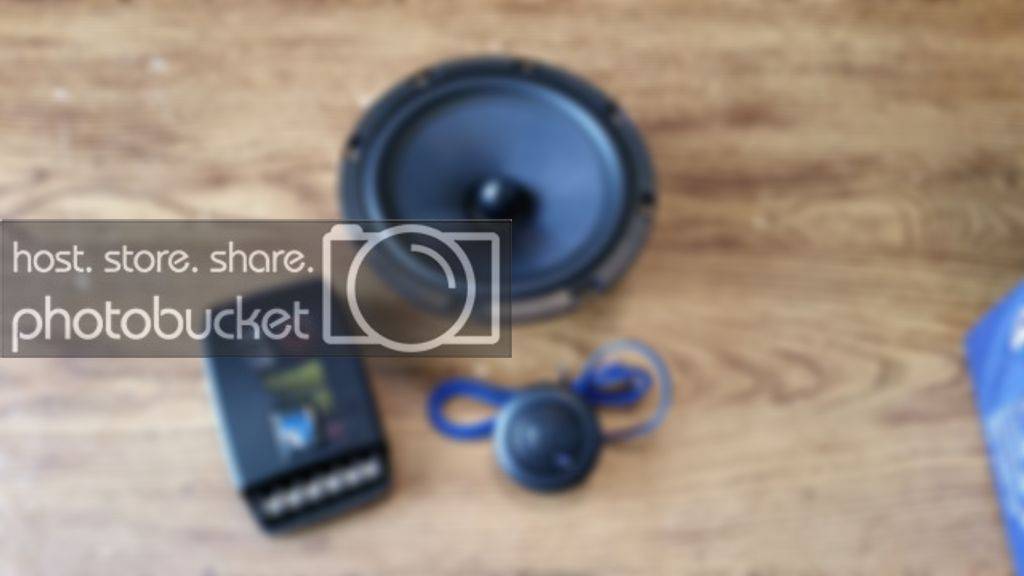

I'd pass on the mtx, but that's just me. I'm running the incriminator audio 6.5" comps and love them. They sound better than most comp sets that cost $50-$100 more. I swapped out my CDT cl-61 for them and don't regret it a bit. Just saying there's a lot of better choices made by non-mainstream companies.
The Incriminator and Soundqubed make some quality comp sets for $100.
