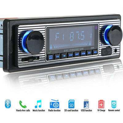

What are your thoughts then on me running just the kappas up front only. With this cheap radio from eBay. It has all the bells and whistles new radios have but I’m really biased towards the dual knobs one for volume and one for tuning.
What size amp should I be shopping for?
Two channel 500w?? the kappas are 225w

Smaller speakers usually have lower power ratings, so it is easier to push them to loud levels. Yes, only front speakers is a good choice. That radio looks nice but I doubt it will power your Kappas like they deserve. Power ratings are not disclosed and if they were, they would be suspect. I recommend this single din JVC radio. Hands-free calling, bluetooth streaming, Pandora controls. Every JVC I have had, has had good power and great sound. At that price it is hard to ignore.

thank you. Should I still add an amp to this configuration with the radio you recommend to me ? Out of curiosity if I really wanted to use that eBay radio could i/have to wire in an app of some sort. To compensate for the radios lack of power.

With the JVC you do not need an amp. It has 18 watts rms per channel which is plenty for the majority of people. The classic radio will only play what it's built in amp has to offer. Now I may be wrong about it's power output, it may actually be as good as the JVC. But from experience, off brand Chinese radios tend to fall short of their specifications. But if that is the case, you can always add an amplifier.
I’ll put that jvc right next to to the Chinese off brand these days. If you Go with the jvc check the rca’s before you out your dash
Back together to ensure output voltage consistency. Signal strength is king. If it’s me I’d put the extra money toward a better hu
